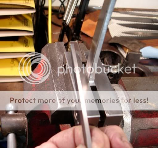

After the clip is sanded down, it's time to cut the shoulders. I'll clamp one of
John Perry's massive shoulder filing jigs onto the squarely marked shoulder,
and begin by filing the bottom corner flush. I'll start with a flat file, and when
it's close, finish with a mill file and an eighth inch chainsaw file, to radius
the tang into the ricasso. This radius, on the bottom and top of the tang,
spreads the working stress of chopping out enough to eliminate an abrupt
stress riser, and also avoids a right angle "notch failure" opportunity.
This will be a take-down, and I want the guard to fit snugly, but not have
to be pressed or knocked on and off. I also want the ricasso/ guard joint to fit
perfectly. I'll file an 8 thousandths channel down each side of the tang with
the edge of a mill file. Although this shoulder will technically be both a
stress riser and notch, the decrease in cross section is minimal, and there is
no working load sideways; unless, that is, someone plans to put the blade into
service as a heavy duty pry-bar.

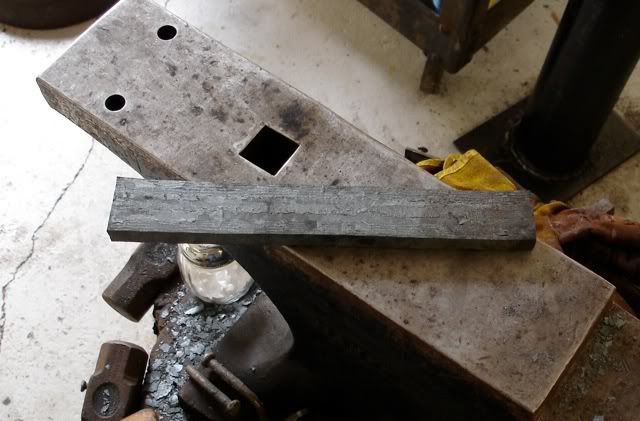

I had a 3-bar billet of "Stars and Stripes" made up, at 9/16 thick, and
about 1 3/8 wide.
To be able to forge the billet a little easier, and to be able to check the
pattern, I'll grind the edges of the billet, and mark two parallel lines 3/8th's
inch apart, centered on the billet.
I'll grind the billet to 3/8th's thick, and prepare a mild steel pattern of the
D-Guard, using my drawing.

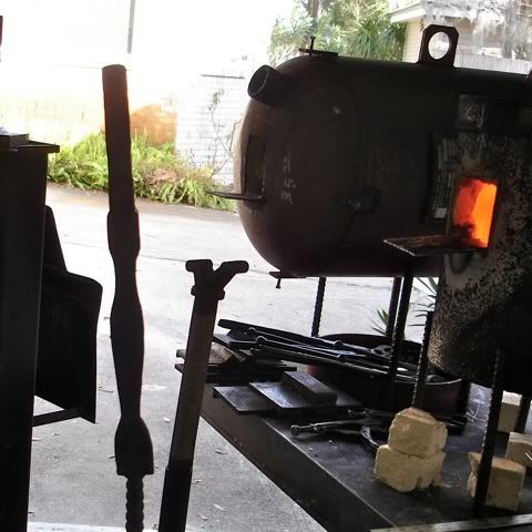

Welding on a handle to the billet, I begin forging it to profile. I'll use the
power hammer for major squeezing, the press to keep the thickness precise, hand
hammer and anvil, and a fullering tool.
Here's the start.
Here's the finish of the first part of the forging.
I'll cut the profiled billet off the forging handle, and also cut off the
extended tip, which will become a small 'Stars and Stripes" plaque for Kevin's
display case.
Here's the profiled billet and the pattern, which I'll use to mark out the
D-Guard for grinding to final shape.
The billet, plaque billet, and a twist piece for the collar, are then
normalized, and annealed.
The D-Guard billet is 3/8th's inch thick, but will be ground down to about .165
before shaping. Again, the pattern is in the center of the billet.

I've already shaped the thumb tip that will be bent and carved, so I'll use one
of my guard half-patterns just to mark symmetrical curves each side of the
ricasso area.
The curves are roughed out on the grinder , using a work platen and 50 grit, and
refined by hand-filing and checking with the same "draw and flip" method used
for the rest of the guard profile. Final touches are again a matter of eye-ball
and tiny alterations.
When the symmetry and shape is satisfactory, I'll use the dial calipers to draw
lines around the edges and in from the edge on the flats, .045 from the edge, or
1/3 the thickness. Going to the grinder, I'll knock off the corners all around
the guard at a 45 degree angle. With the guard in a soft jaw vise, I'll use a
chainsaw file to round over those 45's.
