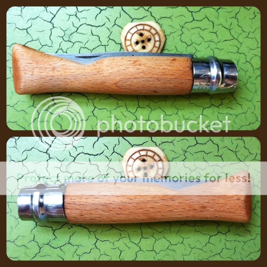

Just finished my first modded Opinel - show us yours!
So, is the polyshades one of those stains which isn't meant to absorb, coats the surface kinda like a dye?
I've had MUCH hassle tying to stain the beech in an Opinel. Never tried to stain after only rough sanding, have you? And did it work? I wonder what would happen if you rough sanded, stained, then fine sanded.
I really like your "scorching" idea. Bet scorching then using a dark stain would look nice.
Years ago I kinda mass produced basic Opi mods at work. I've given all but a couple I have left as gifts. I used to use a dark stain and rub it in hard with my fingers. It was probably dirt as well as stain which made it dark. Then coats of tung oil and done. It doesn't look as good as yours.
This pic has been on before...
Had I coated my Opinel only, I would have said, "yes." However, I've since applied Polyshades to much more porous woods (cheap [basswood?] tray from a craft store, spruce and cedar guitar hole cutouts to seal them for use as coasters, etc.), into which it was at least lightly absorbed, sometimes moreso. However, once the first coat is on, a (recommended by manufacturer) second coat does seem to most sit on top, even if sanded in-between as per directions.
It didn't occur to me to try this, and for now I'm out of Opinels for further attempts. Heh. Sounds like Pinnah hit on this method, to some degree of success.
Thanks! It turned out okay, if not exactly what I had in mind-- I would have preferred it lighter, but things get dark rather quickly once it catches on fire(!). Should there be a next time, I'd be more patient, and go both more slowly and further away from the flame, throughout. I've sanded and rubbed down the handle some more since posting yesterday, and it's looking and feeling even better-- less "scorched," and more hand-rubbed.
Oh, I don't know-- I really like the look of yours. I hadn't seen the picture before, so thanks for posting it again.

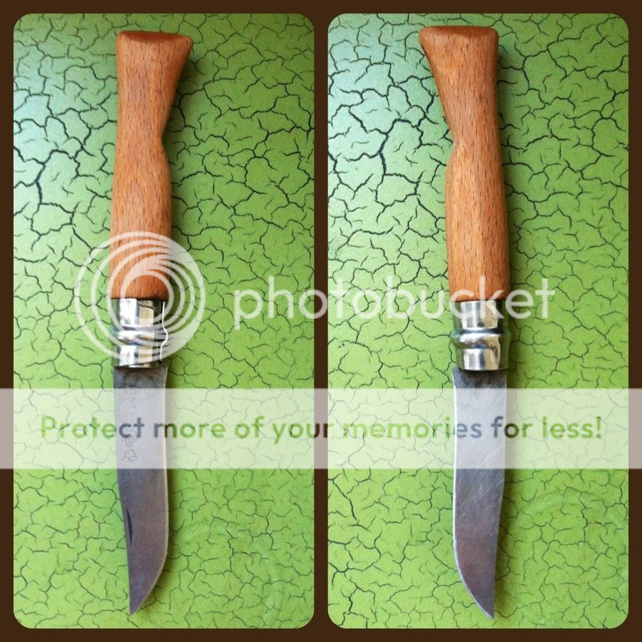

On Saturday I finished another Opinel mod. It was a Opinel #7. I reshaped the blade and made it to a sheepfoot-blade. The blade became much shorter, for sure. So I had to shorten the handle, too. I made the handle more slimmer, for sure.
Here is an in-hand-pic
It´s not finished til now, but I think it makes a good, small user.
Unfortunatelly I made some mistakes with the handle. I "dremeled" too much away, so that it is a asymethric. I can´t fix it. When I would remove the wood of the other side, nearly no wood would be there.
What do you think?
Kind regards
Andi

Andi, I like the sheepsfoot blade. I would not have thought of that. Looks like you could do some very controlled cutting with the smaller size.

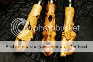

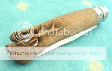

Don't know if you guys have ever seen these:
I like the two blade one
I have thought about carving a face or a rope patten into one of mine, but haven't gotten around to doing it yet, maybe I'll be motivated after seeing your mods.

These are Ebauche, they come with unfinished handles so you get a bit more to play with:)
