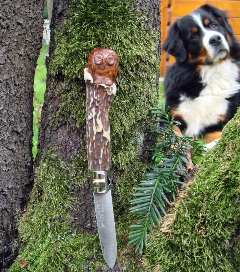

OWL SIGHTING:
~ P.

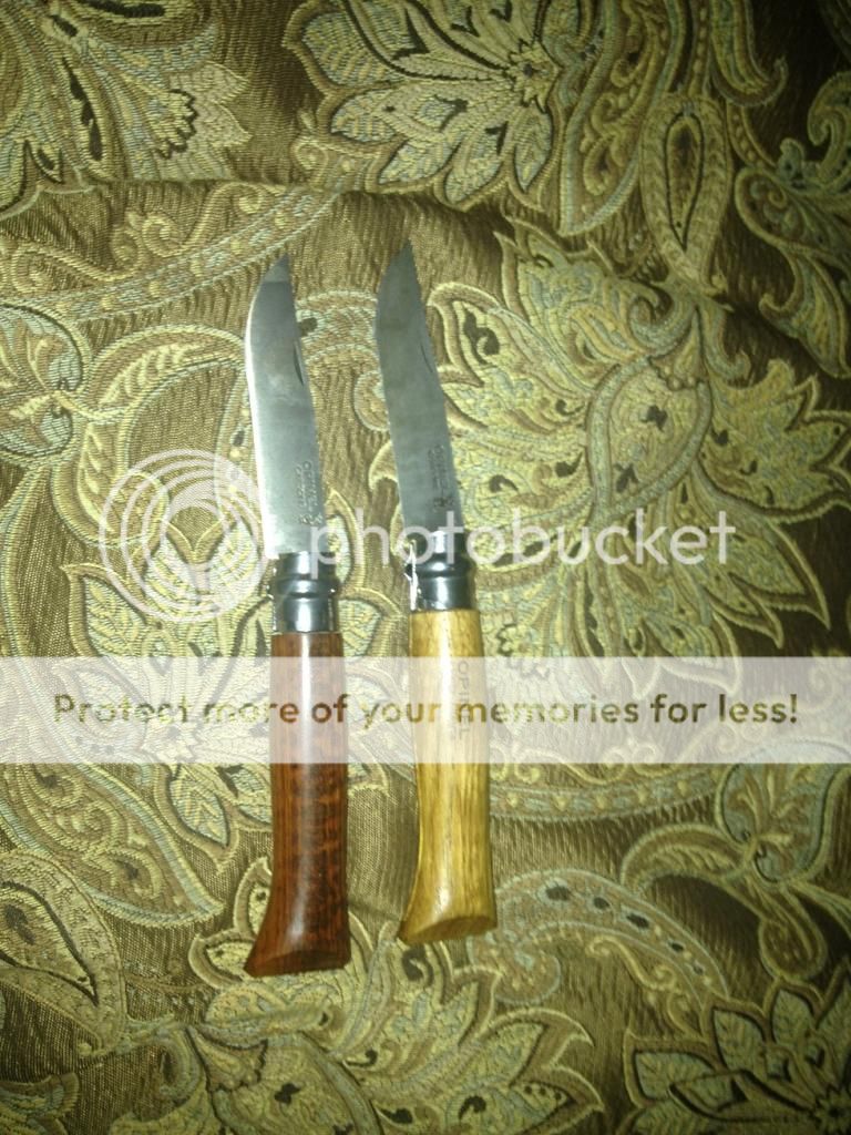

Here are mine. The only mod I really do is to switch out the stainless with the carbon blades. Below, I have my Father's day gift, an Opinel 8 in Oak, and a recent buy, the 8 in Snakewood. The Oak has gotten a ton of pocket time and will continue. The Snakewood is nice, but it was not a Father's day gift.

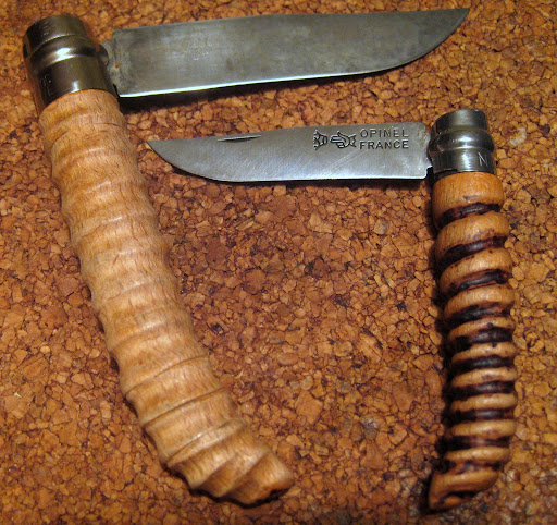

opinels are fun to play with this started out as 2 no 7's
have a mind to try and mod a similar sized one with a saw blade at some point
Rinos, I love that effect:thumbup: looks very grippy!
