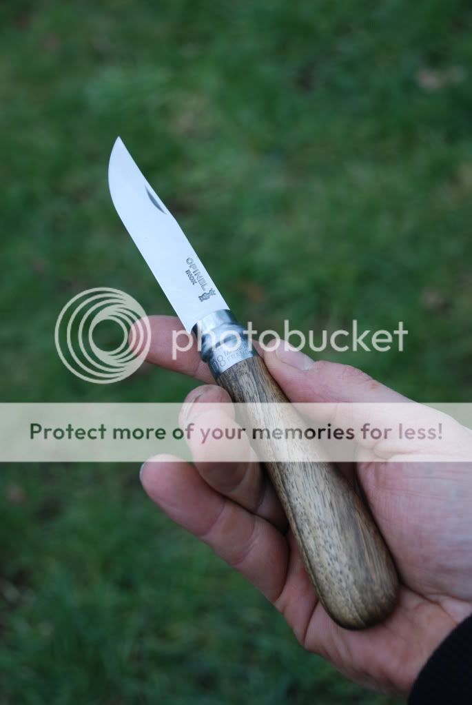

Avoidspam - Do you have any Top down pics of your outstanding looking Opinels? Just got my Ebauche Opinel & trying to get an idea on the dimensions I want to sand it down to.

Halfneck - This is as close as I have in le bucket. I aimed for a slimmer version with the one on the chess board and the butt flattens slightly. It makes for a more pocketable knife but not as pretty as the one above. I found the easiest way was to keep a pattern of knife you already have in mind, e.g. Sodbuster, which you can refer to. You can mark the rough outline on the top and sides too, blending those lines into the turned part near the lock ring. You can then remove material back to that before starting to 3D the shape... You'll need to give the nail nick some thought too.
Have fun, let me know if you need any more pics:)
Sam
avoidspam - trying to see how far back from the blade cut out on the handle it goes. Of course I plan on going slowly on removing material so I can tailor it to my hand. Thanks for the extra pics. :)
