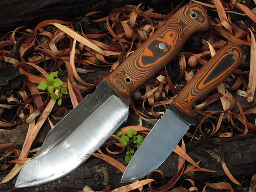

Please (please :eek:) DO NOT switch the BK lineup over to micarta, one thing thats great about the becker range is their customizability...
004 by CamH_16, on Flickr
Like this, you cant do that to a blade that has micarta, its sacrilegious.
CamH,
Not to worry; when I say "working on converting..." I mean we will make Micarta handles in addition to the plastic handles that we make. Options are good.
