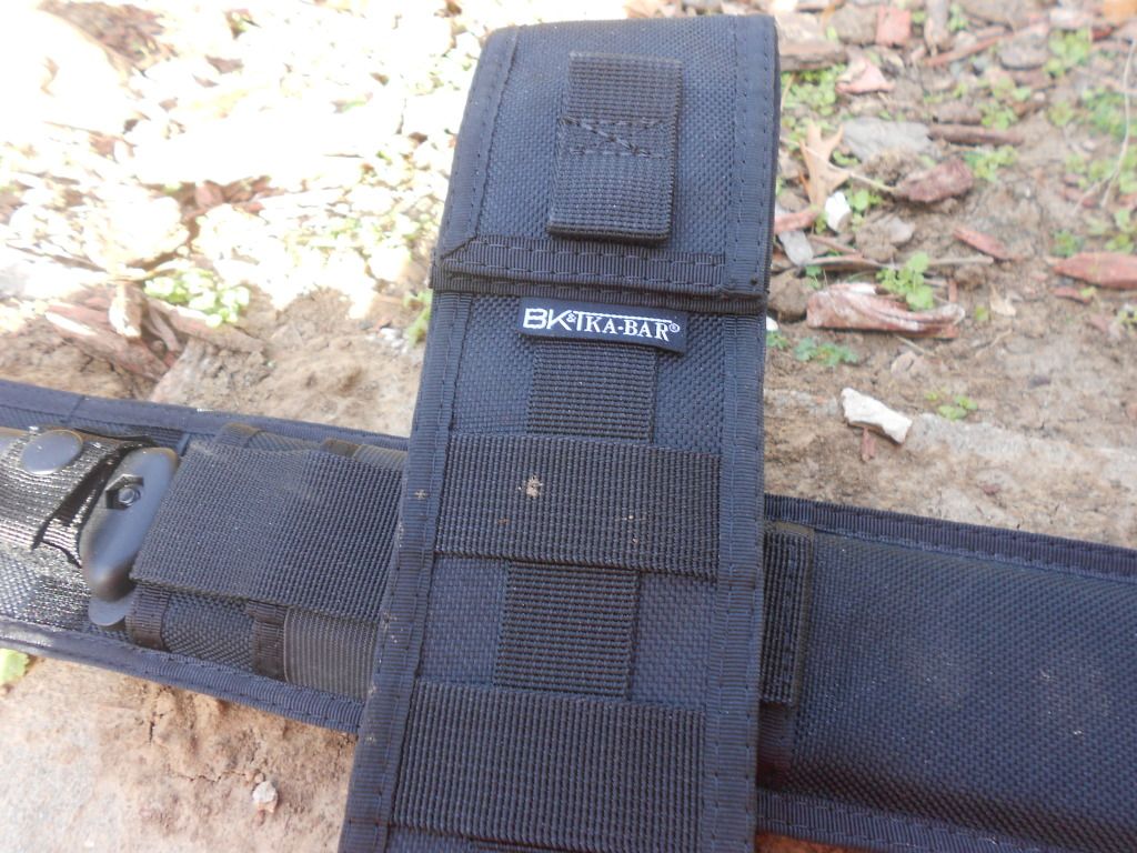

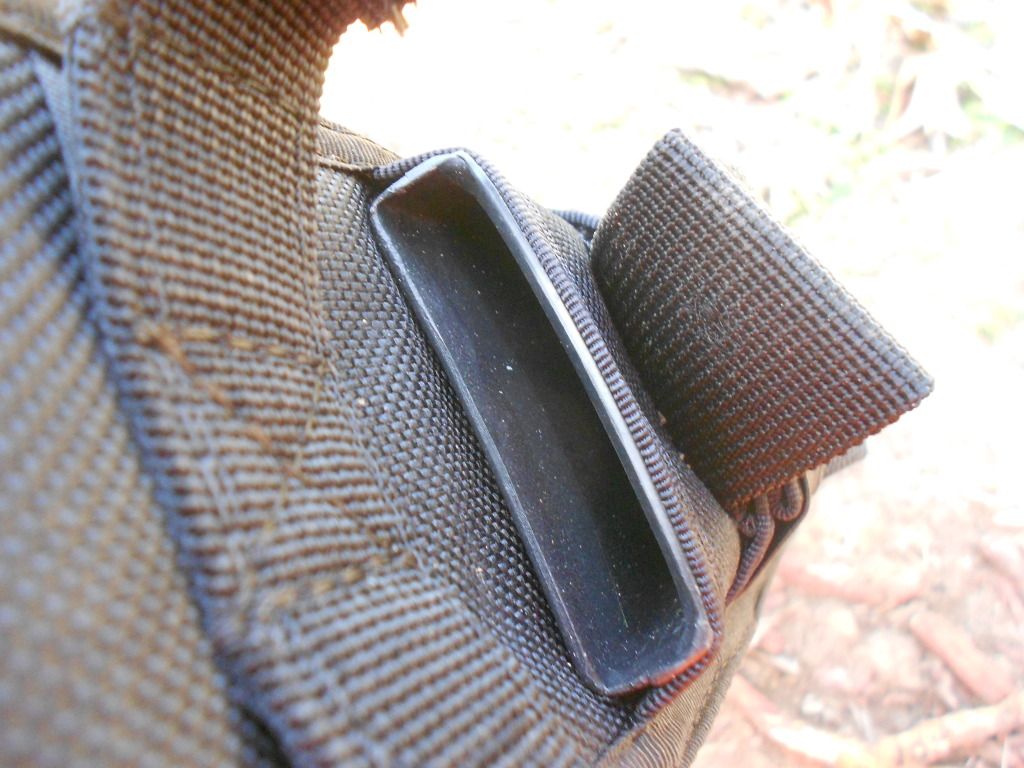

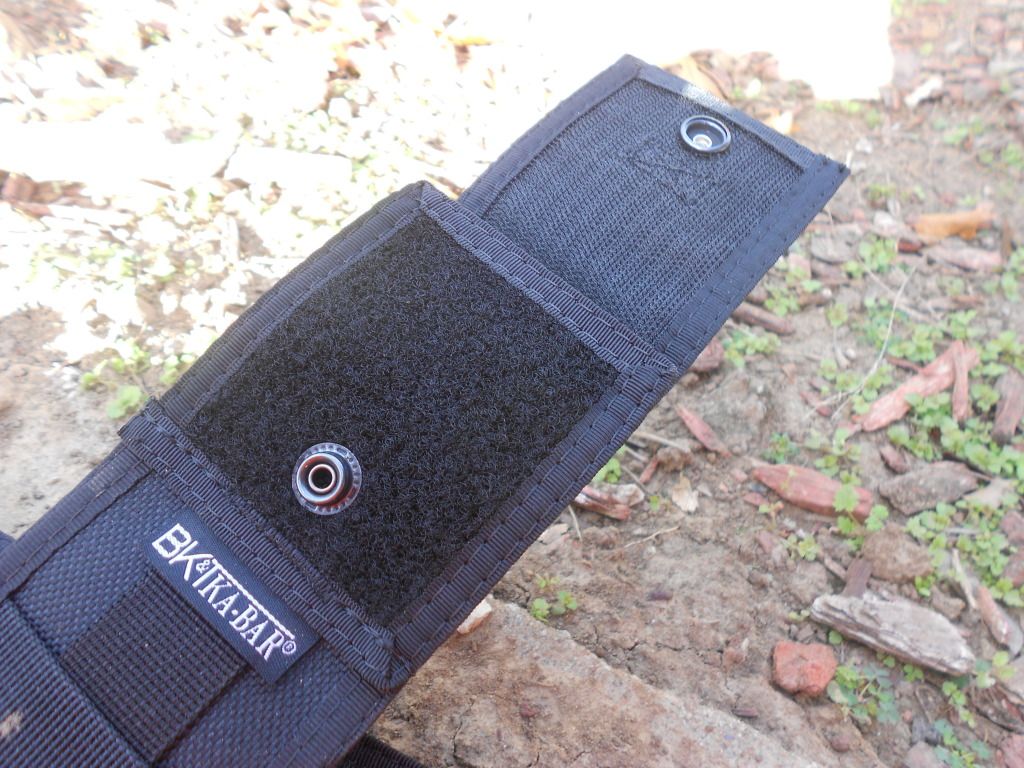

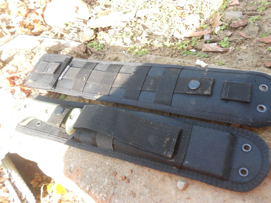

Hey I just saw the new nylon sheaths on the BK7 and the BK9, and I just wanted to say that they look great.
I was wondering though if the BK2 will be getting a similar nylon sheath?
Thanks ahead of time :)
