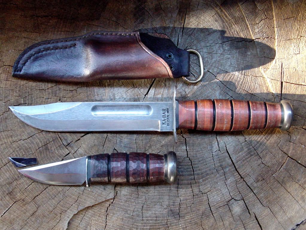

I agree that whacking a Kabar with what amounts to a small baseball bat into oak prolly isn't the best idea? However regardless of design that's a large chunk of steel. Quality steel that Kabar claims is heat treated properly etc. I'll admit I've split a few small logs with my Kabar. Never broke it. Could it be technique? As in pushing down on the handle and say where the blade meets the handle the wood is harder. Like a knot etc. Then you whack the blade further down creating a leverage situation? Sorry for the crappy explanation/example. But I think you all know what I'm getting at?

I certainly abused and broke the KABAR. However, before I went to the machete to finish cutting the kindling, I batoned a small 4" blade handmade rat tail tang knife made from a file into the same piece of oak with the same baton. It survived with no damage. I switched to the machete because it was longer and easier to baton.
I would have assumed the KABAR would have been stronger than the small handmade knife.

yes, what you were doing is outside their concept of "acceptable use", but a brand new knife still shouldn't have snapped like that.
there may have been a hidden flaw in the steel of the knife that would have allowed it to let go under "normal" use as well.

You're absolutely right. The point is when you intentionally beat on something, it'll break. There are knives now made to handle the rigors of batoning for those who choose not to pack an ax. Myself, I would only baton if the wood was absolutely soaked and no axe was available, but I make a point of having my small Estwing hatchet handy. Even then I only remember one time where wood was too wet to light up, so I split a couple of branches and got it going. If I carried a KaBar and for some reason didn't have a hatchet with me, I would baton with it if necessary. If it broke, well the rattail tang wasn't intended for that. Actually I'd be sure to use as soft of wood as I could find and then only use as much force as neccesary. That doesn't guarentee that the KaBar won't break, but usually when you respect the equipment it generally holds up.
So, one other thing I don't think had been mentioned yet, is that there is the possibility that the knife had an incorrect heat treat.
Now, I'm still not saying this knife was ever designed for this type of work, however, on this very forum we have seen the exact same model survive years of similar use before (or rather, if) they broke. I know for instance that moose (one of the mods here) broke one after three seasons of splitting kindling for his house (they had a wood burning stove). The knife was used hard, and did eventually break (the design is still not good for this), but his copy and others have taken lots more abuse.
So, again, not saying this knife was meant for this type of work. Just saying that a bad heat treat could have exacerbated the problem. I mean, you can find examples of many knives designed for batoning that have failed due to inclusions, bad ht, etc (Becker, esee, tops, buck, etc).
