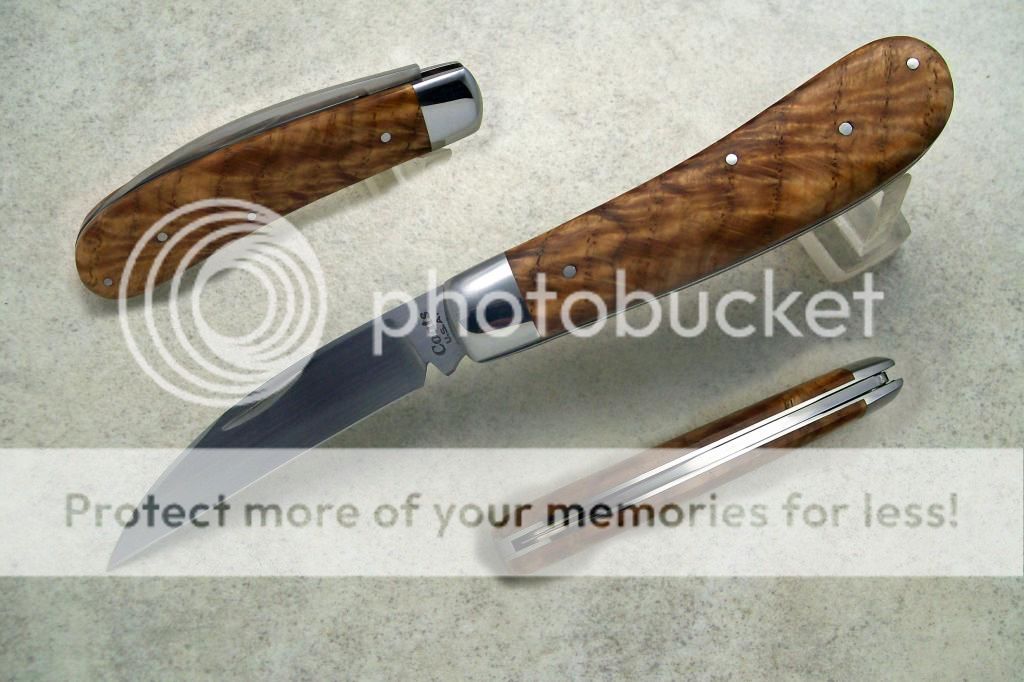

Here's a simple swayback going out tommorow, it has nice Burl Oak on
it. Comments welcome, NFS Ken.

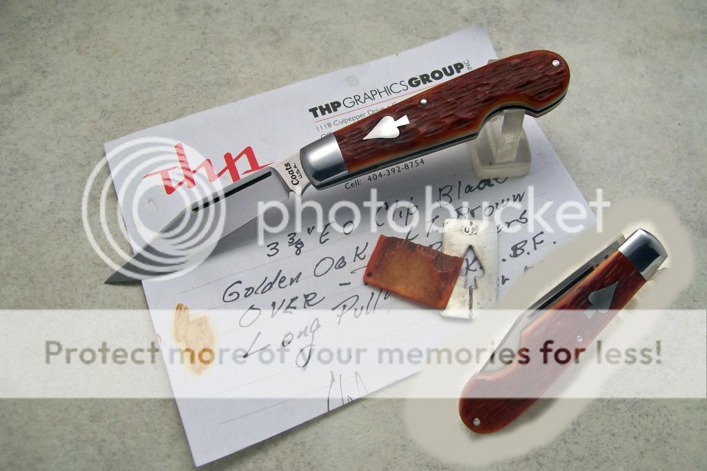

One I just finished up this afternoon, been a while since I've done
an EO with a clip. Also been a while since I've used my "Ace of Spades"
shield. 3 3/8" closed, my dyed and jigged bone. Comments welcome. Ken. NFS
Hubba! Hubba! What a beauty!
Those are some might fine lines on that clip.

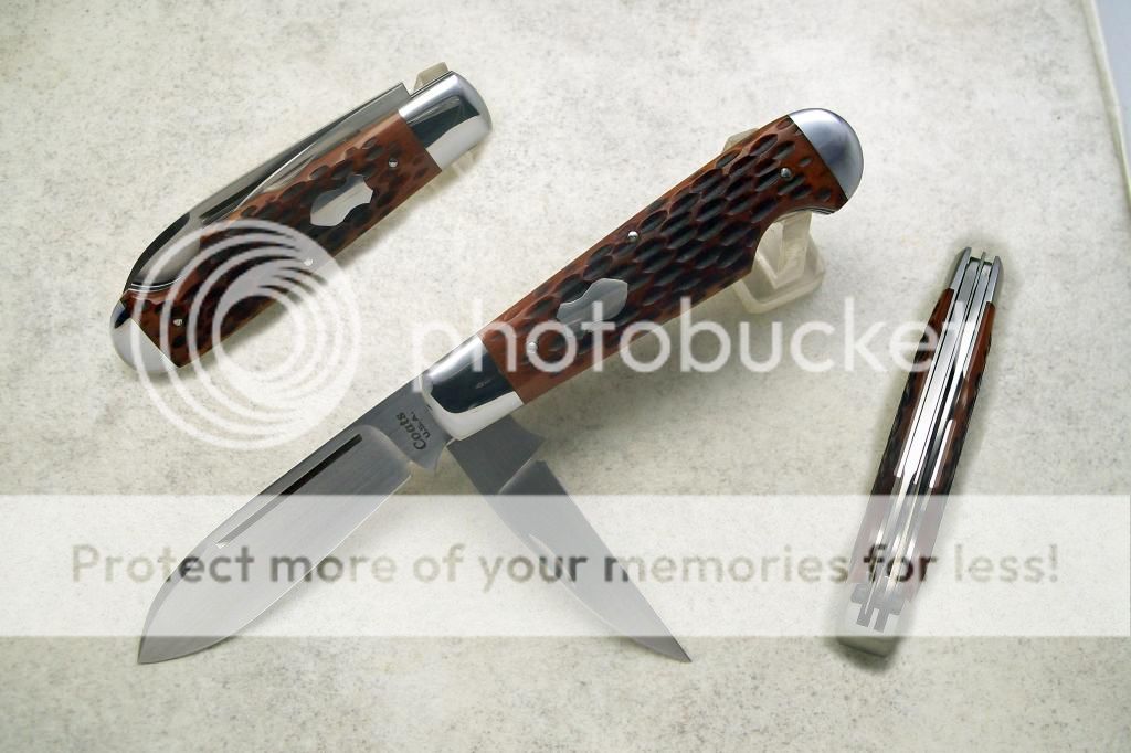

This one was one of those with no fight or problems in the build. Steel Ats-34,
my dyed and jigged bone, pinned shield, both blades lay center. The secondary
blade and spring was taken down to .072, primary at .092. 3 7/8" closed,
comments welcome and Thanks for the look. Ken. NFS
Sir, you are an artiste! It took me a moment to pick out, 'what's different about that knife?' (above). Then I realized it's the s/s liners. Simply gorgeous!
The combination of the EO cutout for the main blade and the recess for the nail nick for the secondary is great!
