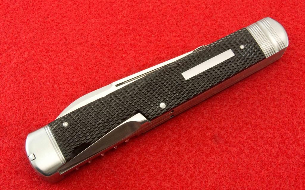

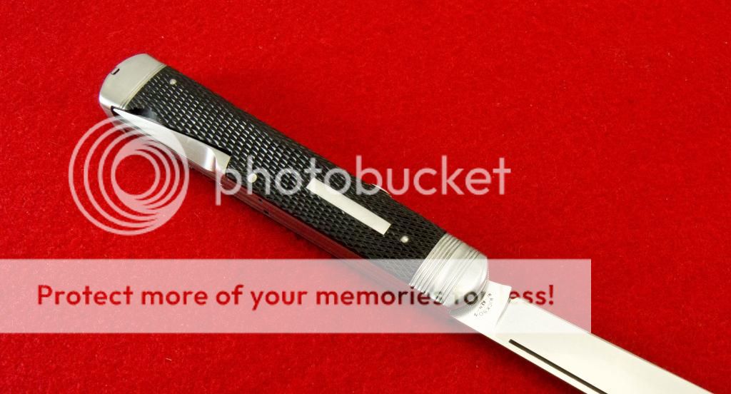

Great-looking Sportsman's knife Ken! It has quite a compliment of tools.
Can't wait to "see" the checkering. It doesn't show up at all on my screen.
Ken, Your knives are amazing, this last one is no exception.
I'm about to cut my first rat tails and i'm very nervous...i'm just watching your multi-threaded bolsters in awe!!!!
Wonderful piece, Ken. Congrats on another work of art. :thumbup:
Ken you are one of the few craftsman capable of taking on such a project!
You deserve a standing "O" for your attention to detail and superb final product, although
you're not completely finished.
Jeff
Another Masterpiece, Ken! I'd really like to see checkering on knife handles more often. I'm sure the time and talent it takes to accomplish that is pretty significant and adds considerably to the value and price of a knife. Very nice indeed!
Well, not much else to say, other than I agree with everyone else. Curious about how the checking was done, but don't want to get you off topic. Thanks for posting the pictures and congrats to the new owner.

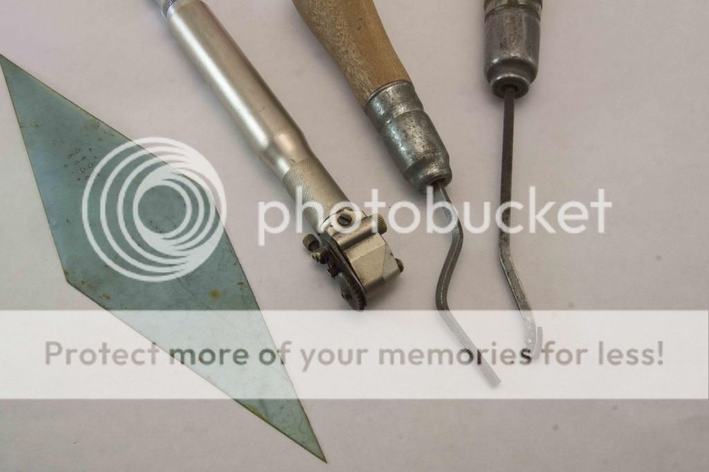

Mike, here is a picture of the tools I used for this checkering. The MMC power checkering head is a luxury that is a carry-over from my gunsmithing days.
While there are many more hand tools in my checkering arsenal these did the bulk of the job on this knife. The flexible clear lucite diamond is used to layout the master lines, the small single line cutter is used to cut the master lines an finish up after cutting the lines with the power tool. That long single line cutter, its used to correct crooked lines, ;) , not that I ever get any, lol.

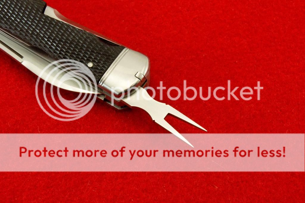

Thanks Ken for the additional details. Love the threaded bolsters, coined liners and long pull as well.
Yep, everything about this knife is absolutely stunning Ken, as Elliott said, a work of art :)
I smiled,and still am, looking at these last photos Ken.:) I hope you get as much from these as we do. I see why you might not need my knife.:)
The checkering on those scales is fantastic. Thanks for showing off the tools used to create the effect.
Really neat to see your process, Ken :thumbup:! Thanks again!
