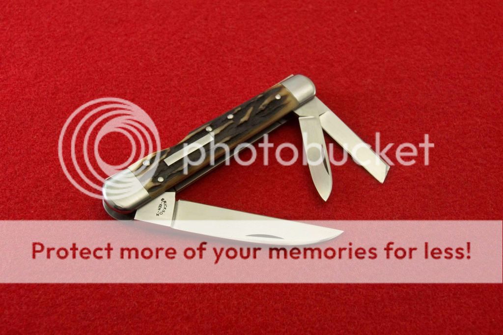

The stag for Monday through Saturday. The tortoise for Sunday and life would be complete!
The customer is one lucky person!
What a set - right off the planet!!
Nice work, Ken!! Great Stag application!!
I trust the change is positive.
It is,will be :)
Thanks again for the kind comments on my work guys, very much appreciated.
Ken they both turned out great but the torty is special indeed! Congrats on another couple of fine builds.

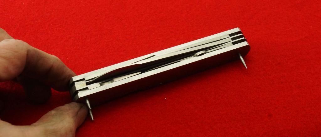

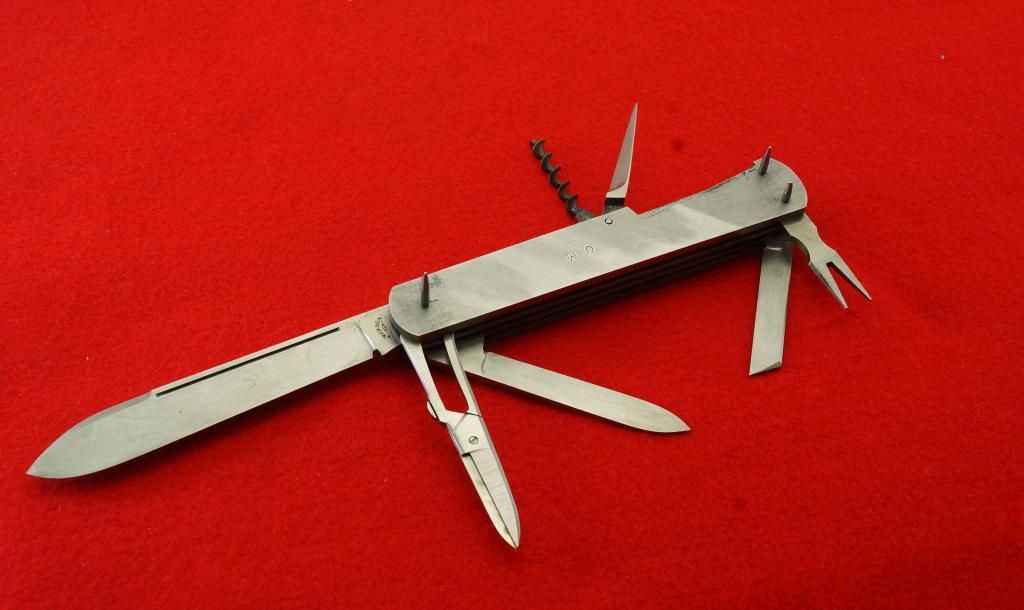

Here is a bit of teaser photo. I have been working on a Sheffield style large sportsman's knife for a while now. As you page thru the Sheffield Exhibition book you will notice a pretty good collection of these large 5 to 5 1/2 multi-blade sleaveboard type knives that feature a varied selection of blades and implements, and covered in ivory/metal/ebony and buffalo horn. While this knife is not a exact reproduction of anyone of these knives I hope to capture the intent.
After many days of making patterns and cutting parts along with heat treating I have the knife together and roughly fit-up with all springs working as they should.
Here are some of the specs,
5 1/4 closed
7 hinged blades/implements Large master spear, pen blade, coping blade, scissors, cigar fork, corkscrew and 3 cornered awl.
2 slide outs, pricker and tweezers.
Bolsters with checkered black Buff horn covers.

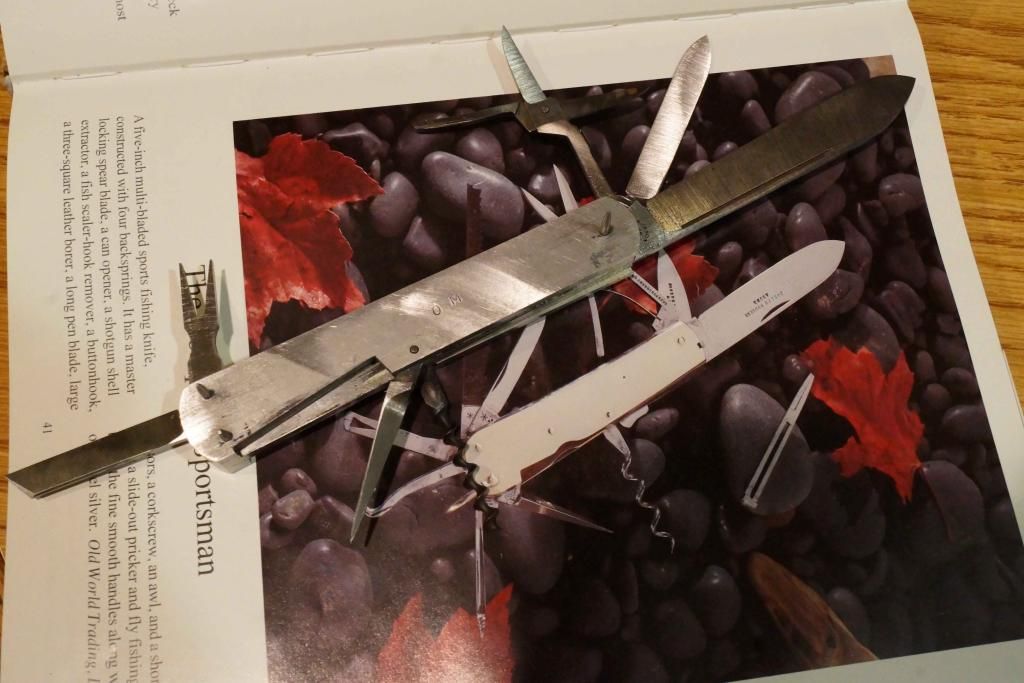

I've been curious as to how you were going to cover this one, great choice! I had to pull out my copy of this book to look at an example of the checkered horn and it's really a great look.
I am really excited on the checkered horn. Think its going to work very well with this one.

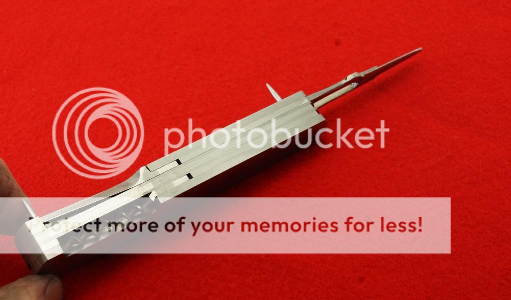

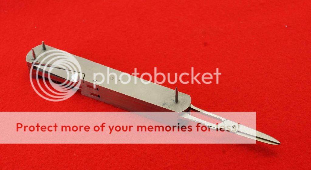

These are the first set of "decent" photos. I have been using my tablet camera.
These scissors are a first for me and have been happy with the results thus far. Every grind and swedge added make these look, feel and work like they should.
Have a few of Ken's knives and I really have not seen one I did not like of the ones he and many others have posted, but this one has been driving me nuts. I can not wait to see more of the progression.
