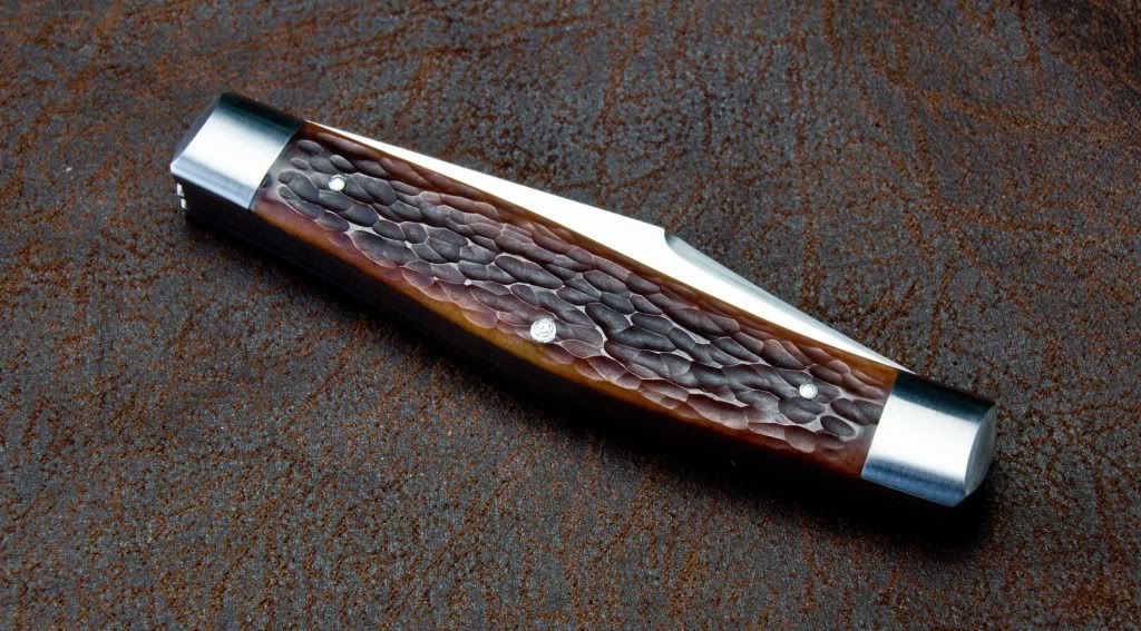

I have had a chance to finish up the Texas Jack this morning and overall real happy with the knife. Jared Oeser (a very talented maker branching out into slipjoints) had asked me if I would document my process for dyeing and jigging the bone scales. I guess the god's were smiling down on me with this set. I was able to achieve the two-tone affect with the colors I like. Here are the specifications on the knife.
D2 Flatground blades/springs
Hand finished 800 grit
Half-stops
410ss integral bolsters/frames
Extension spring for pen blade
2 3/4oz

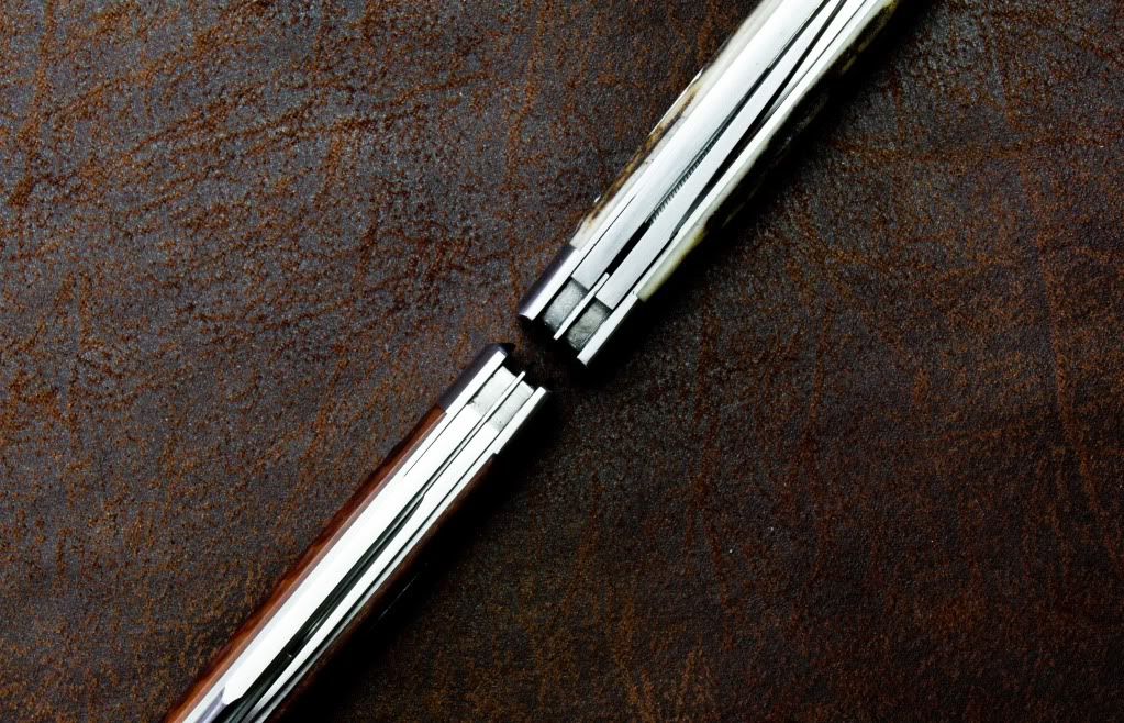

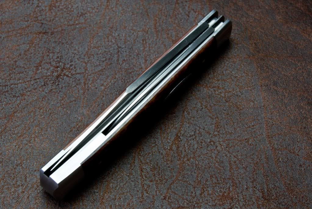

This picture shows the difference in thickness compared to a stockman I just finished in the same length.
Looks great, Ken, in all respects. A terrific pattern, well executed! :thumbup:
That bone looks great Ken. I think you managed to step it up a notch and I didn't think that was possible. And I like the pattern as well.
Thanks for the comments guys!

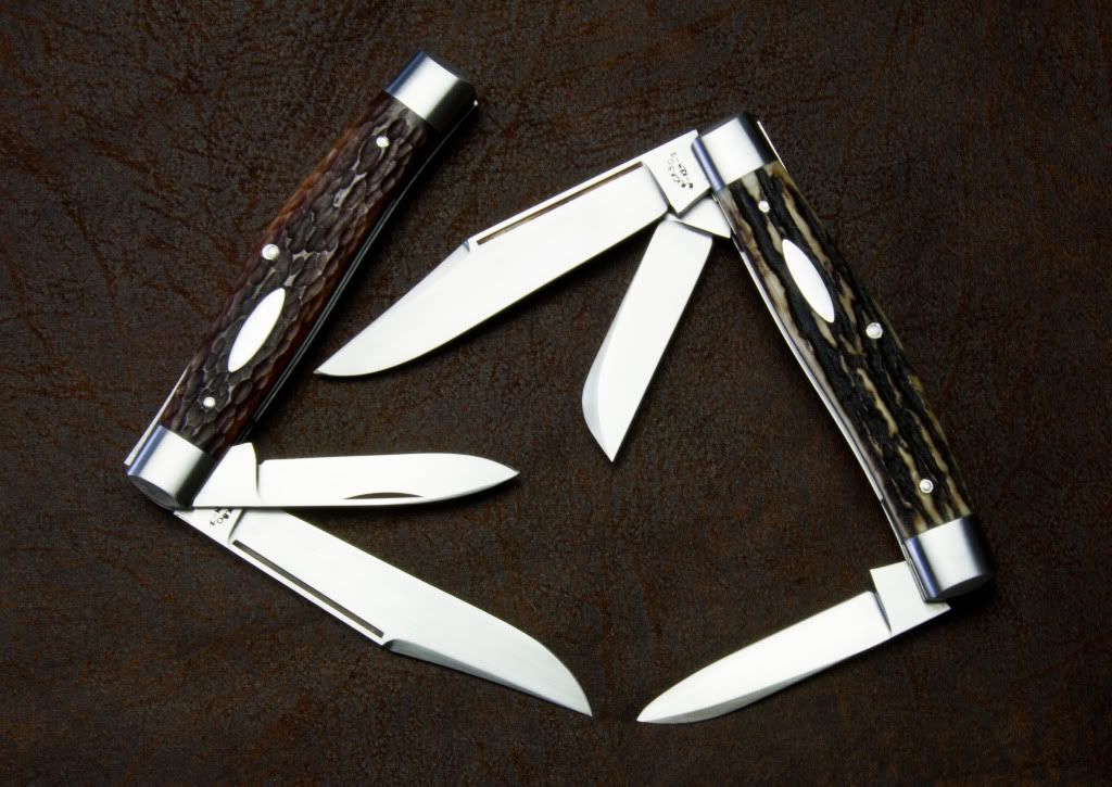

This recipe is one that Ken Coats passed on to me. I really like the colors and contrast between the lighter outer edges and darker center.
One more I call "two knives, five blades", LOL. Did want to mention again neither knife is available.
Ken, those knives are stunning. The jack knife especially reminds me of case at its very best, that shield and bone, fantastic.

I think I've said this before, Ken, but to my eye the proportions of this round of clip master blades is absolutely perfect. Also, as much as I love stag, I don't think you could have chosen a better material than the jigged and dyed bone.
Ken,
Two beautiful renditions of classic traditional folding knives. I am particularly drawn to the stag Stockman, terrific!
As usual, superb craftsmanship and clean lines make for a great result.
