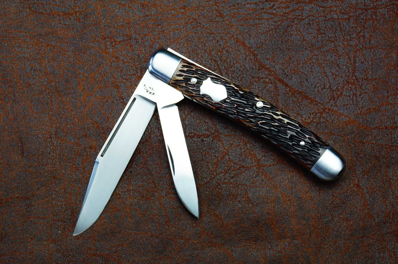

Ken, That's a fine looking jack knife. It'd go straight into my pocket too!
Look what that early work has evolved to, Ken!
That is one, fine peachseed Jack! Nice choice of blades, great bone! Good pocketable pattern!
Thanks for the kind comments guys!
My customer , after seeing the pictures, told me it was going straight to his pocket:thumbup:
The slight diagonal jigging is often seen on the Schrade's. My jigging is more random however. If you study a lot of peachseed you will see that it does have a bit of rhythm and rhyme to the pattern.
I liked the color on this knife, it has some interesting hues and variation to the color.
Thanks again!
This is great to hear!

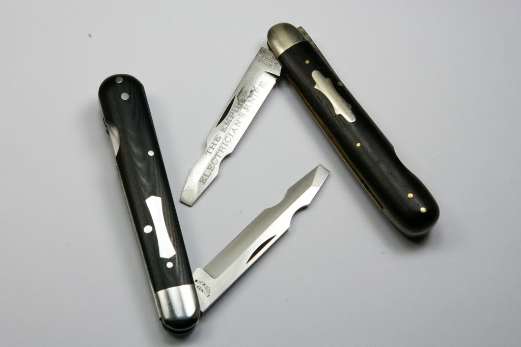

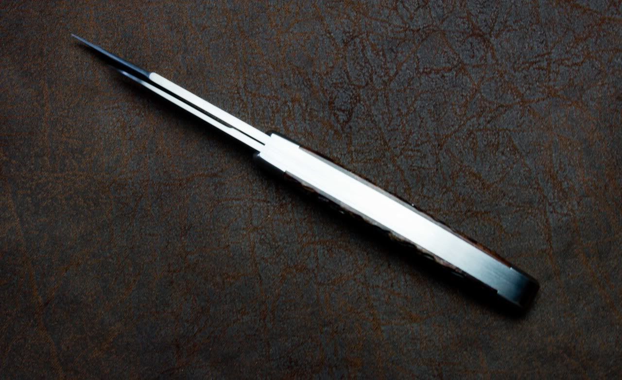

Here is , at least I think, an interesting build coming up. As some may know I have built a single blade electricians knife a year and half ago or so. Because of that knife I was asked if the two blade locking version interested me. Yep! What is also interesting about this knife is the fact that you push down on the master spear blade to unlock the screwdriver/wire stripper blade.
Here is a picture of the single blade version I made along with an original single blade Empire.

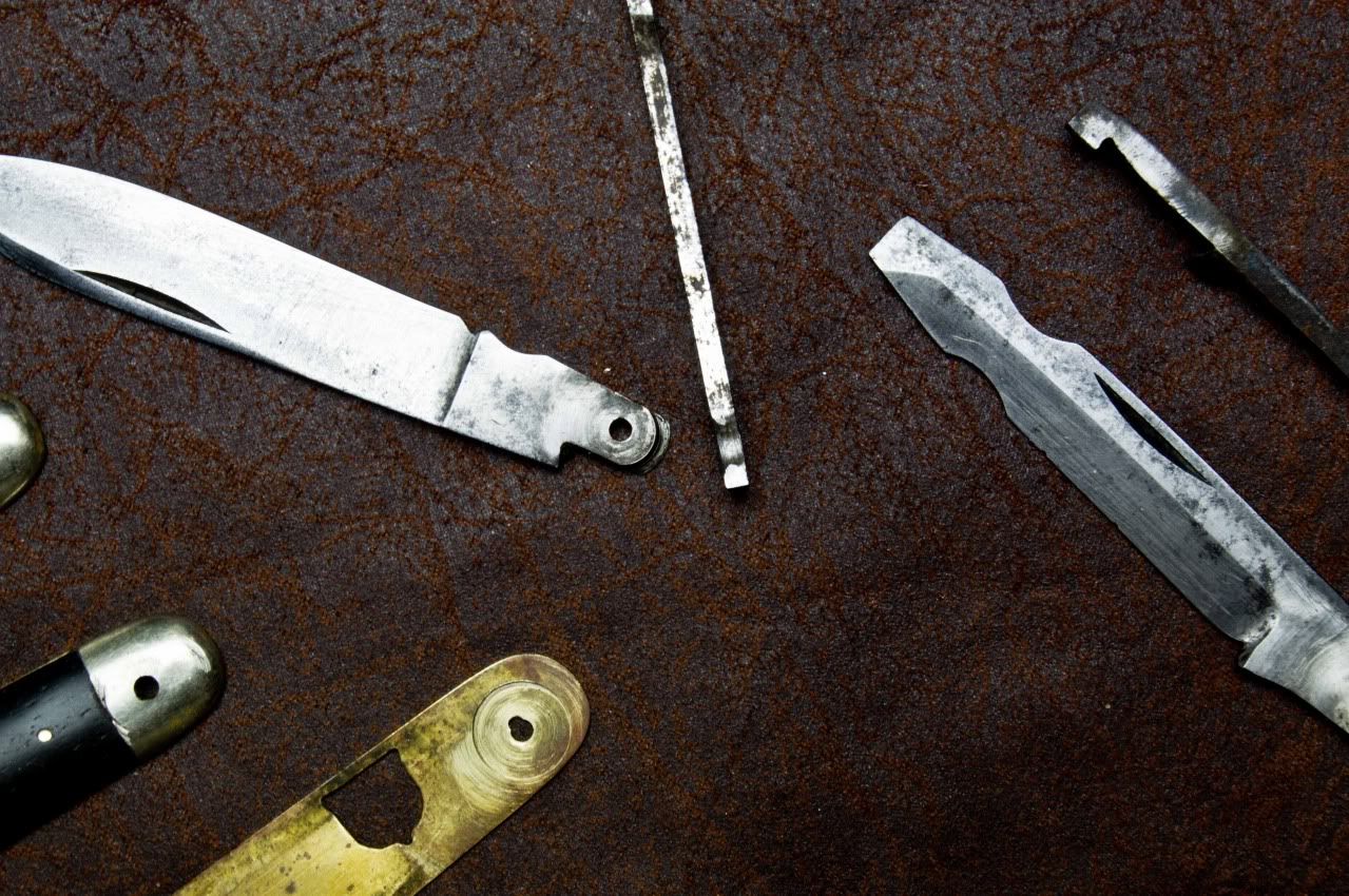

This picture shows an Empire that was sent to me to take apart as the master blade lost its "walk and talk". There is also a very nice example shown along side. I believe the stamp on this one is Ulster.

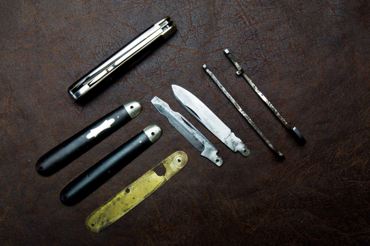

This picture shows a few things I think are noteworthy. This design requires a hole in the center liner that accommodates the lug that is depressed when pushing down on the spear master that unlocks the screwdriver blade. The hole looks as if it was punched with a shield punch and then modified a bit! Thoughts on this are more than welcome.
This picture also shows how important it is to oil your knives. The tang on the spear blade is worn leaving a very thin edge showing the original profile. The back spring is also very worn showing a deep divot where the tang rode. Oil, the life of the knife!
Nice project, Ken.
I've always wondered about the details of that mechanism. Empire made a lot of those knives.
Other companies either subcontracted Empire for theirs, or copied them exactly.
The kick on the master rides on the top of the lug connected to the backspring for the screwdriver blade. When you depress the master it pushes down on the lug, pushing down on the spring, unlocking the screwdriver blade.
Ken, I can't wait to see this. I have been wanting to make one of these for my dad to constantly breaks the tips of his knives using them as a screw driver. Please post some WIP pics, this should be a great build!
I think I understand it. Do you forge the lug over, or leave it standing with stock removal??
Jared,
I will do some wip pictures on this one for sure!
Charlie,
I plan on forging over the lug for starters. If that does now work for me I will do a stock removal lug.
