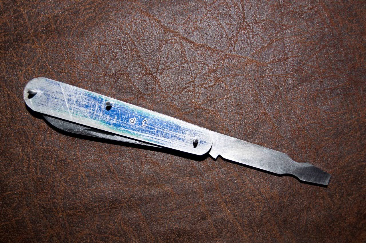

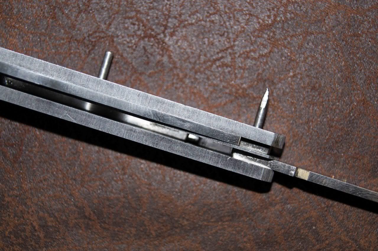

I had a chance to work on the locking electricians knife :eek::grumpy: and must say it is one finicky knife to get right. I still have fitting to do yet, to get the backsprings flush in open and closed positions etc. Getting the screwdriver blade to sit at the right attitude when open and still lock tight took several attempts. When this one is all done I will post a picture of the pile of parts I re-made! It does work at this point, the master unlocks the screwdriver blade, both blades have good walk and talk.

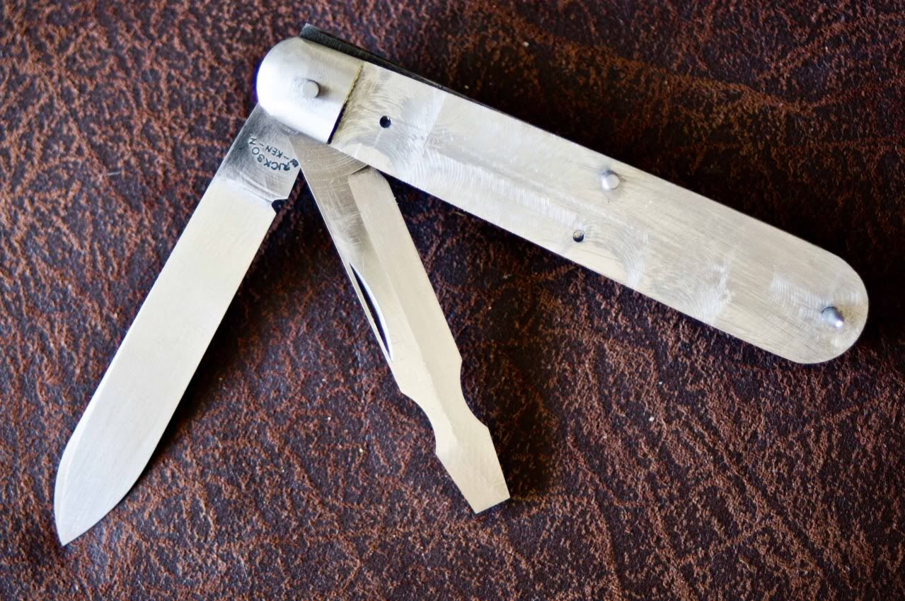

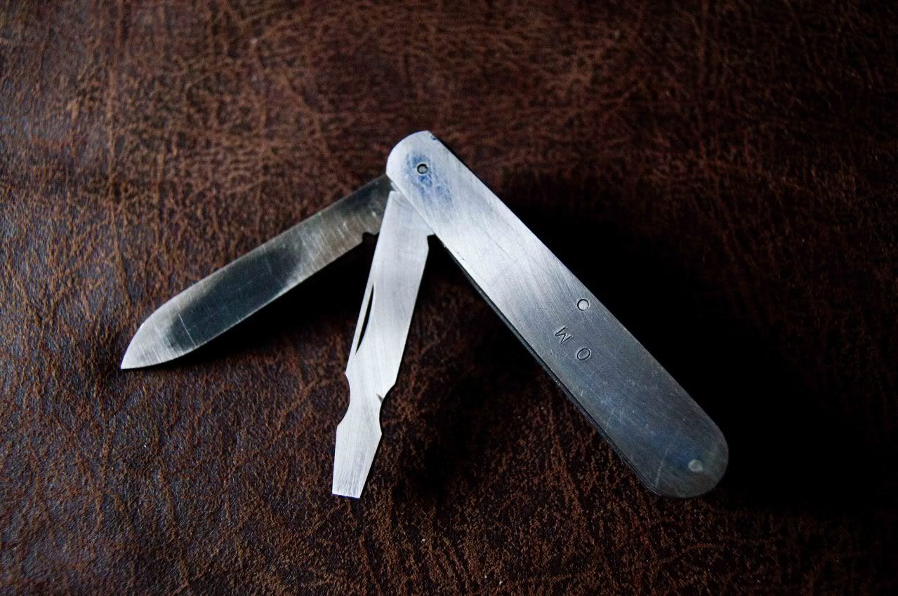

Had a chance to work on the electricians knife. I have the blades ground, frame/bolsters milled. The next step will be to fit the black linen Micarta scales. I opted for the black linen in place of Ebony for two reasons. The single blade electricians knife I made previously was hafted in Micarta. The other reason is that I think it is a very fitting material for the covers. I think if it had been available when these knives were being produced it would have been considered. Keep in mind things are pretty rough looking yet at this stage.

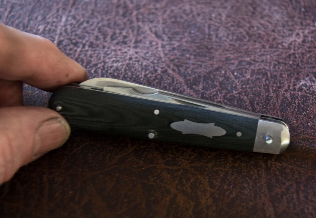

I did get the covers on and shield inlaid and pinned. Pretty much on the downhill slide now except for the finishing aspects.
Very nice, Ken. A beautiful interpretation of true classic carried by countless workmen (and women) over the years.
