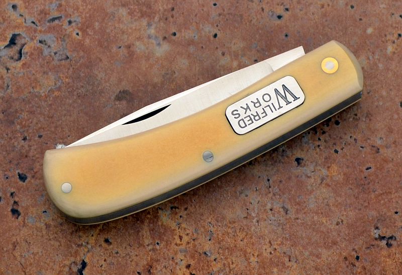

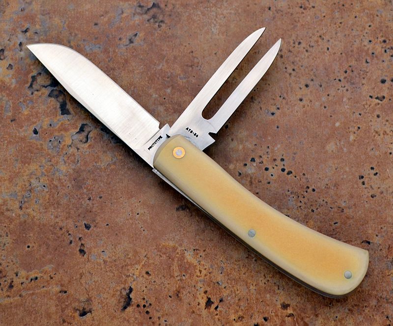

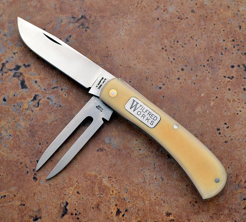

What's to say...just check out the dang images.It is a prototype and I will make some slight improvements but I am overall happy with the way this knife works. My brother has already called dibs on this one so it is going to get some immediate field testing. Judging from his play, I doubt that he will be using the the dimple fork ... EVER!

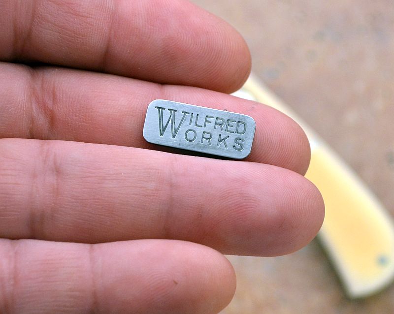

The shield is a removable ball marker. AIN'T THAT COOL, CAMPBELL!
What a unique and unusual knife, Kerry! Looks to be done to perfection! Makes me want to take up golfing again. Is the shield/ball marker held in place with a magnet? I can't think of another way to do that.
Is that a " Golf -ball -Buster " ????
HA! You can call it that. :thumbup:![]()

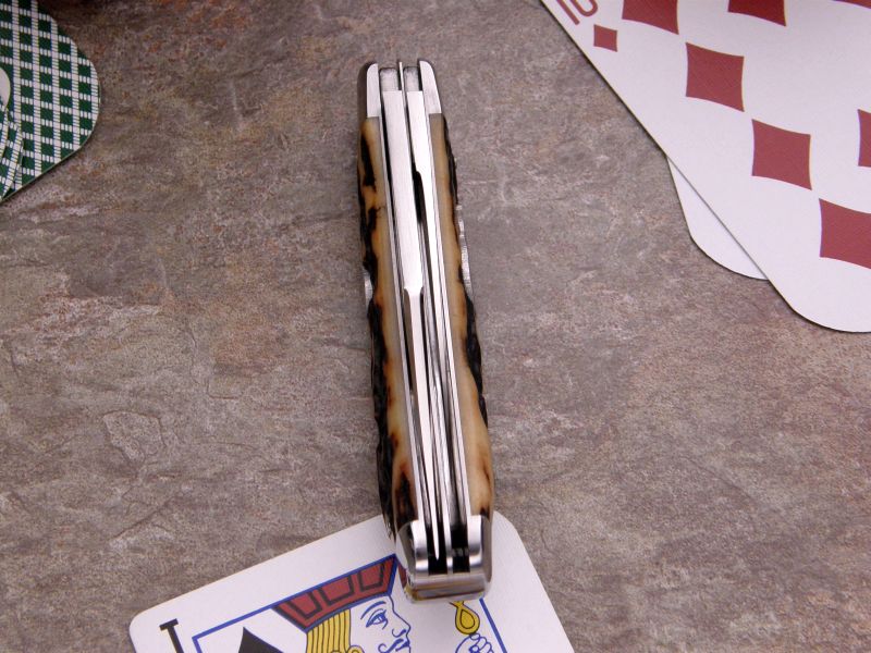

kh-418grncnvsBPdroppt5-2 by sc-sld, on FlickrThe swedge on that one is fantastic! Very nice knife. :thumbup:

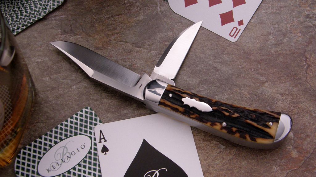

First let me say "Thank You" for all the very nice comments on the work (dare I say "play") I have been doing on the knives. So, I think I will keep doing it.

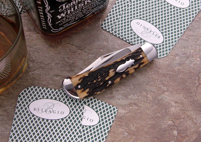

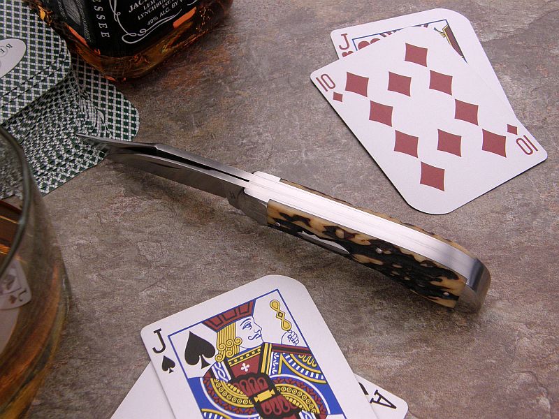

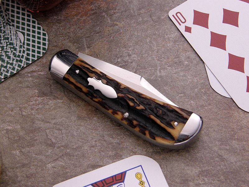

Now on to the matter at hand....that CNasty has some weird ideas, but I like him.He asked me to make for him a two-blade Lanny's Clip in the Wharncliffe Trapper configuration but I talked him out of it. I said it was too darn bulky and that W blade will stick up out of the frame too far...unhandy and fugly. He just HAD to have a two-blade Lanny's clip so I decided to make it into a jack configuration with a smaller secondary blade in front of the clip.
This knife turned out so special I felt that we needed to give it a name and I gave the honors (with my right of refusal, of course) to Campbell. He started texting me with ideas like they were being shot out of a 45 auto...and BAM!....Tennesee Jack! A totally appropriate name.
The blades and springs are 154CM. The clip is 1/8" stock and the wharncliffe blade is .108" stock. Campbell wanted it pimped up in his usual style with double, double-bomb shields and caps (PITA!)
In the words of a BF friend... "It's a beast!"
