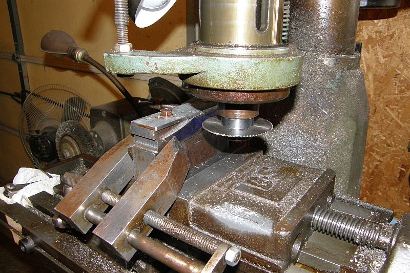

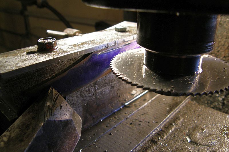

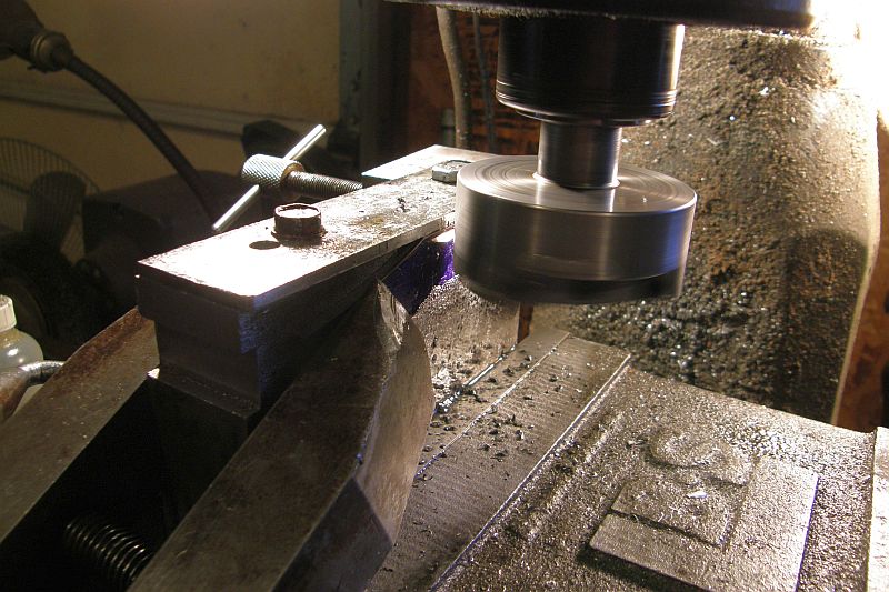

Just wondering, what do you use to cut your long pulls in with?
Ken
Here's the setup for cutting the two types of pulls. I first said that I thought it was a 4" slot cutting saw. It's actually 2 3/4". The first two pix show the saw. The third pic is the fly cutter.
Kerry,
Thanks for the follow up pictures! It is always nice to see other set-ups. I like the plate on top of the holding fixture to align the spine parallel.
Ken
