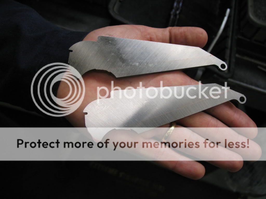

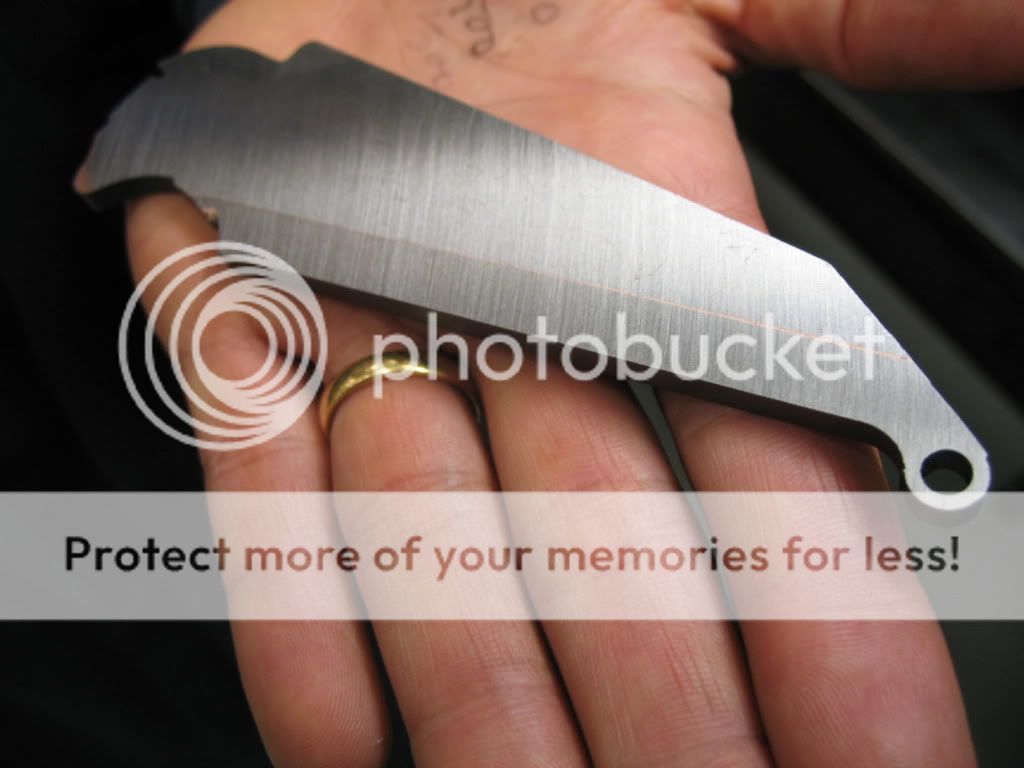

Blades are back from double disc grinding...

I just love pics from the fabrication process! To see how much work/love that is put into the blades make me appreciate the finished product even more... Keep the pictures coming Thomas, they keep me from migrating over to the crazy and craving ZT/hinderer-flipper crowd;)

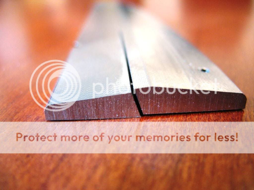

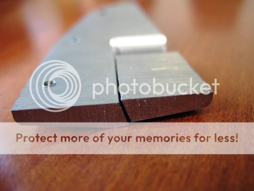

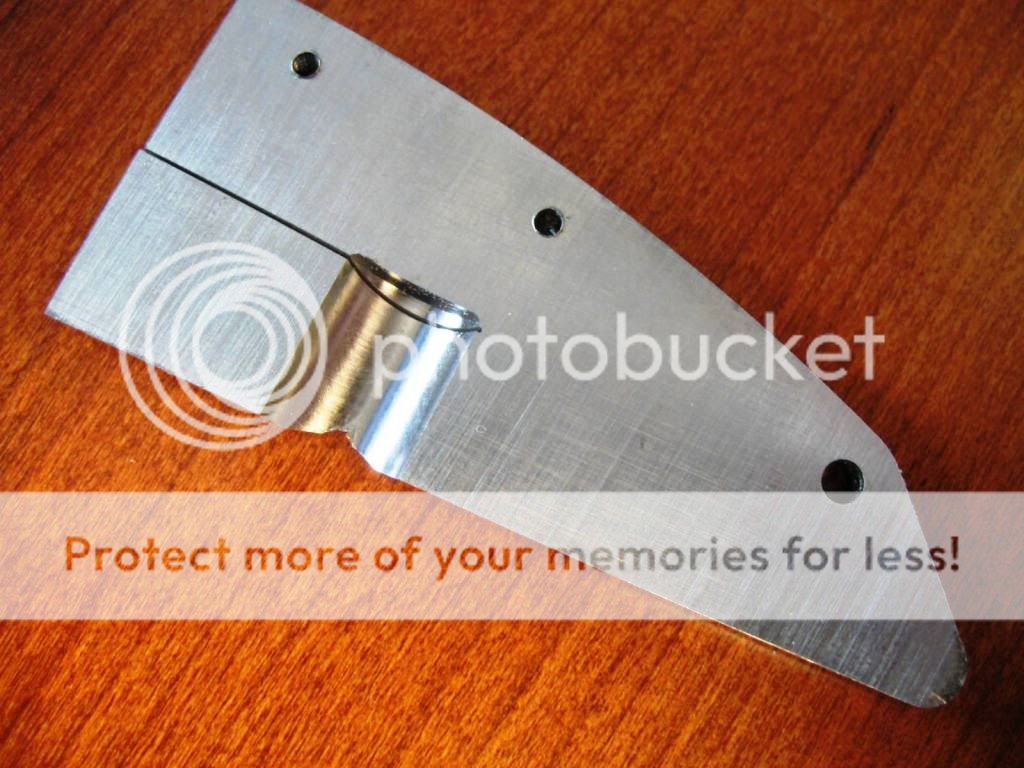

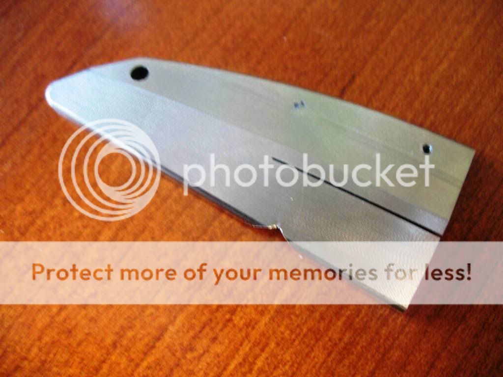

Damn! Nice shots of the lock being cut:thumbup: Thanks Thomas. I've been working on some designs and have to do mine with a Dremel and a cutting wheel!:eek: Can I come by the factory and use the machinery for a few hours??:D

Here was a past cross section image of the bias cut lock on the Speedform. We angle it at around 16 degrees. It works against itself, keeping the lock from over-extending. Kudos to our machinist Lloyd for coming up with this.
That's pretty cool idea, I hope that Lloyd got a raise for that!

requires no hardware to prevent over extension. I like it. Clean and simple.
I just thought this wouldn't be feasible to mass produce, it's deffinatly a machining challenge to mass produce. I didn't see a diagonal cut being realistic when working with waterjets, plasma cutters, and CNC machines. I'm glade to see that Kershaw has great machinists like Lloyd that can problem solve and push the industry to get the challenging items done.
Props to Lloyd.
