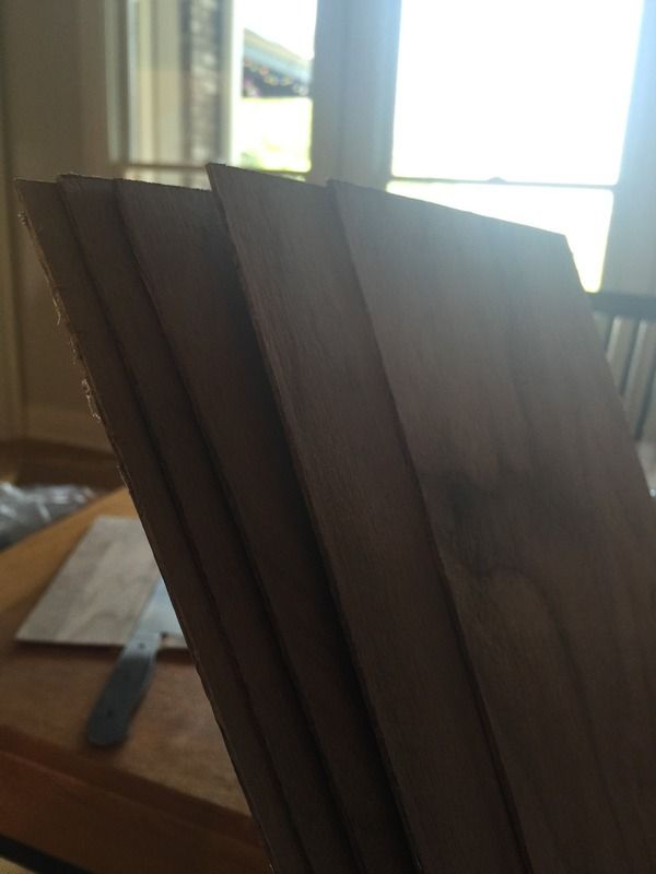

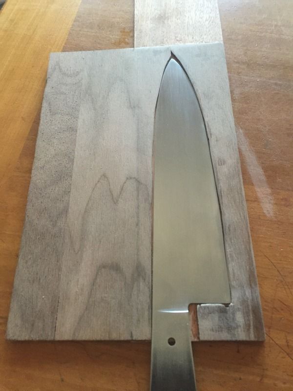

Well, I've never done a WIP or a KITH, so here's my first go at both. I decided to make a 'chefs' knife, and I had a piece of 12c 27 that I had been given, already hardened, so that's what I decided to use since it was reasonably thin stock to begin with. I got the blade shaped and ground to my goals, and next I started the education and construction process for a Saya. I started with some thin veneer stock in walnut--found at Amazon:
Next step was to check the fit of my blade into the outline I cut out of walnut:
Next up was to cut the other side out of mahogany, so the Saya is Mahogany/Walnut/Mahogany:

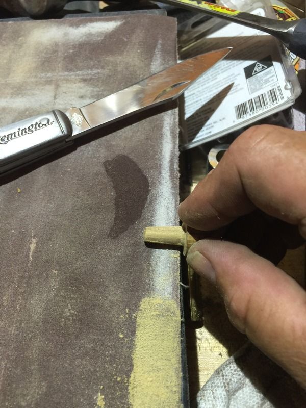

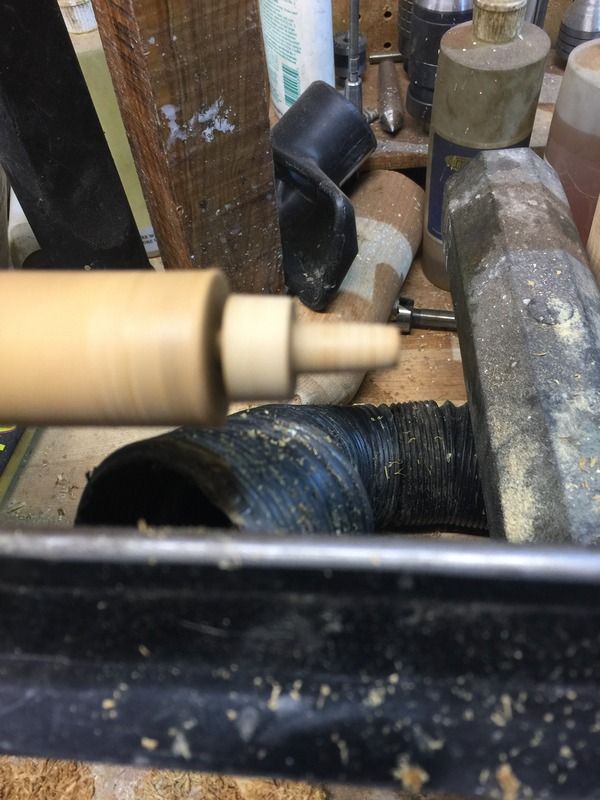

Then I had to make the 'pin' for the Saya--here is the piece to start on my lathe:
It turned out to be a real picky rascal to get to final shape--here it is getting hand sanded on my granite block:

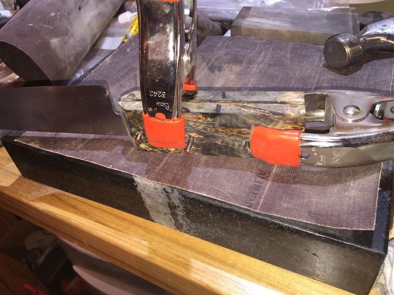

Next I fitted and checked some nice spalted pecan scales stabilized by KMG

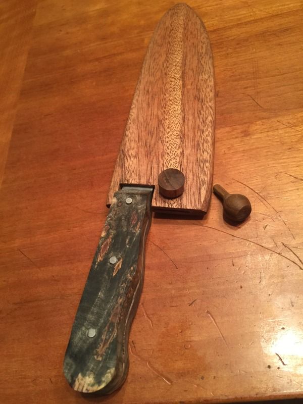

Here's final shot of the Saya and both 'pins' I made for it-
-Now have to finish up the handles and put my mark on the blade. I'll post that next week or so as it happens--feel pretty good about this one--I'll be honest, I would like this one myself :)

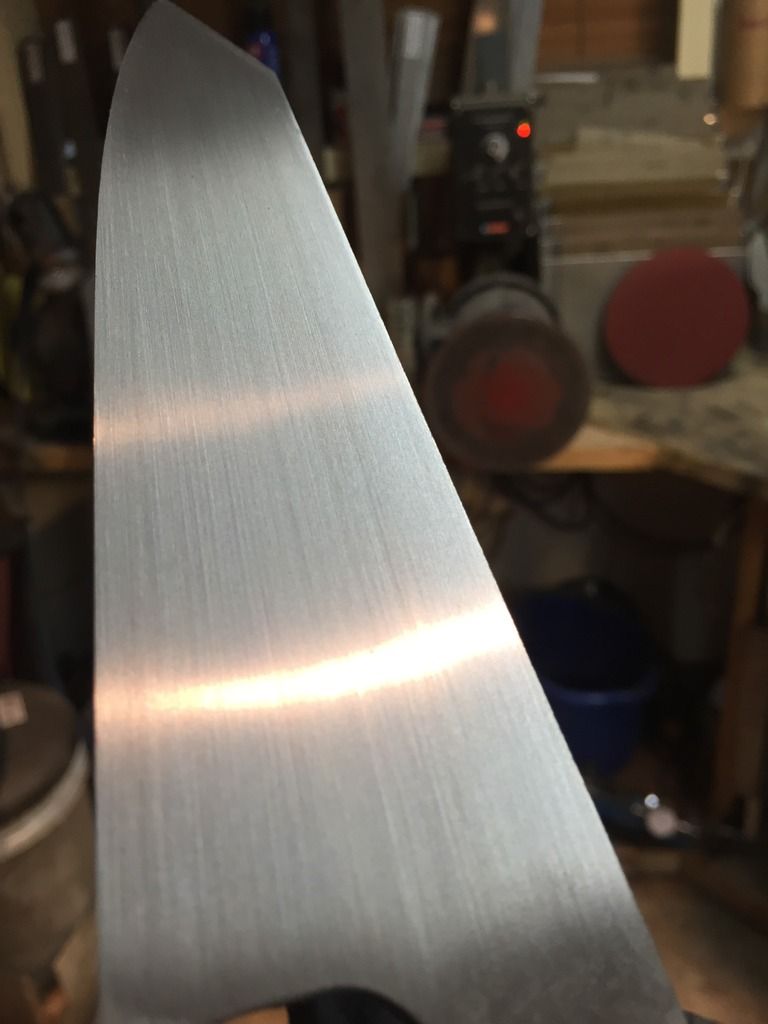

I've decided on a 7.5" 52100 Kirutsuke gyuto for the KITH. Got some decent progress on it today. I'm not exactly sure what wood but I'm thinking Ringed Gidgee and African Blackwood.

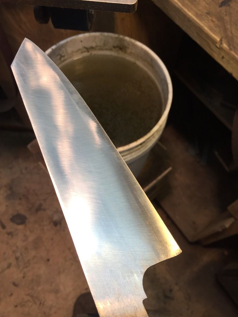

Just off the grinder:
I love the 400 grit stage:D
