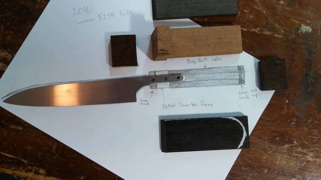

no worries all, we can do it again next year too. I lost my cell so no pics but I was able to finish shape my handle last night. now for finishing and then the saya.Ive got kind of a random mix of hardwoods goin on with this one, ironwood, yakal, bog oak, and curly maple. Being short on time, I had to use what ever parts I had that was closest to the finial shape. It looks really cool though!
