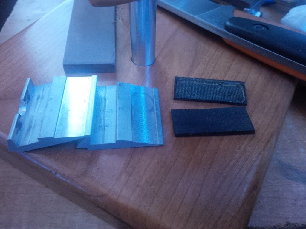

Anyone else had this happen to them? Not really sure WHAT happened. I lifted the clamps to remove my 24 and they fell out too. First "Issue" I've had!
