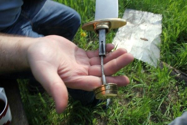

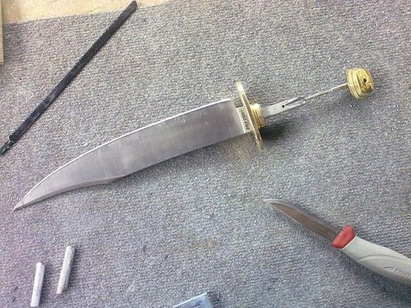

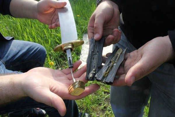

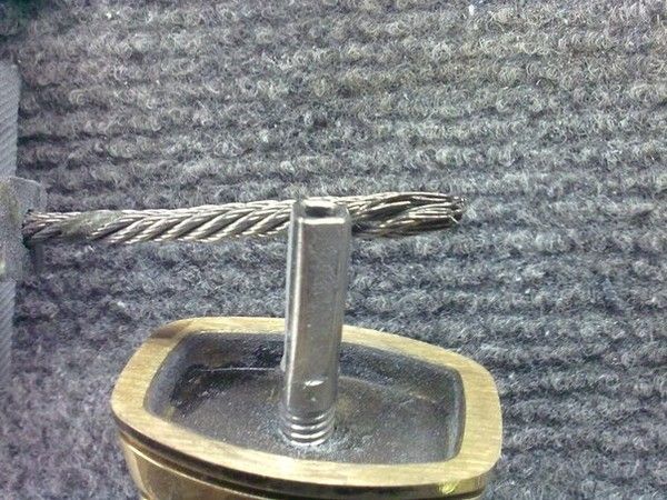

Speaking about knife fail:
This is what happened after the owner beat on the handle/pommel while using the Natchez to baton wood.
Strange construction (supposedly to alleviate vibrations), but even more strange that he beat on the handle part of the Bowie.
Im not out to bash CS BTW. I have some CS knives and quite like them.
Not going to buy a Natchez though, as I prefer a different handle/tang construction..
