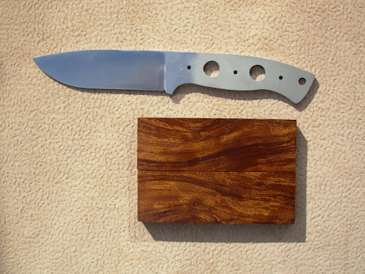

The scales I bought from Rob!:

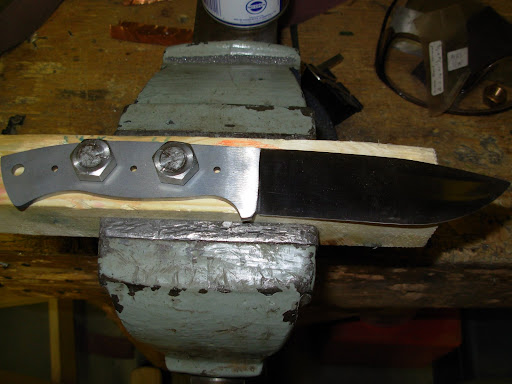

flattening:

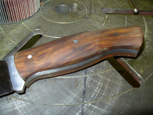

An ugly picture of one side roughed out:

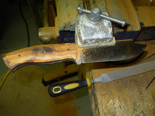

Working the other side, I have this panavice, but it didn't swivel as much as I wanted:
I wanted the pictures 800x600 but there was a setting when I uploaded them that made them even smaller...

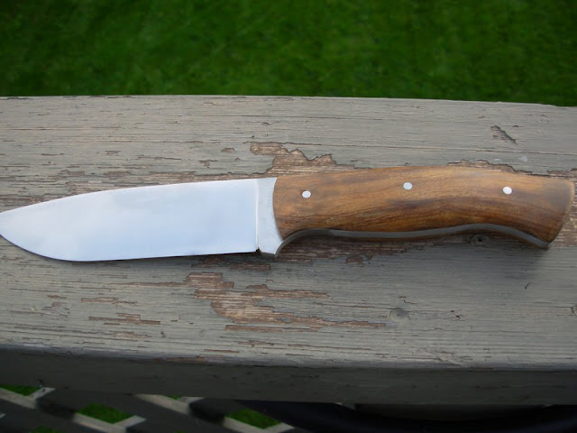

I was getting this thing done before I left for camp in NS, but now I am a little stuck on details. I was planning on trying to get some of them sanded out today. I might take a photo or two today.
I spent about 3 hours today filing the handle a little nicer, taking the height off of the pins with a sanding block and then sanding it to 220. I did a bunch of work trying to get the finish even on the blade, but I may have to leave one of the little scratches in the blade :(
