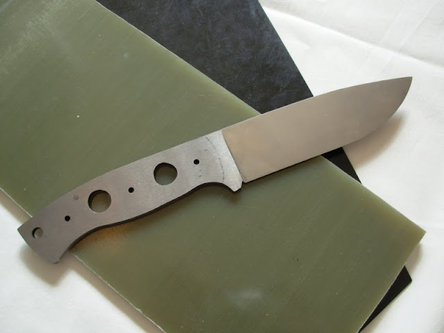

Knife in Progress.
Ive been sanding the one side with the a/o emery cloth... I hate sanding! it seems like the grit falls off after 30 seconds of sanding and furthermore, I have a small scratch in the middle and a leftover file scratch right at the plunge :( I guess I will have to go a grit lower...

Wow. I have been really neglectful of Robert's knife (this one)
I have kind of been stuck into a rut with this. I have been feeling crappy about myself too and have not been getting into the shop.
Today I tried some more to get the small scratch near the plunge out with the 220 a/o, which was what I sent it to Nick as. I then switched to 320 wet dry, it is almost ready for the 400.
How do you guys hand sand? I have been using a 8"x2"x3/16" piece of precision ground O1 as a block and cutting the paper into 2" strips.
I am excited to sharpen this thing! I measured the edge, and it is around 0.008"

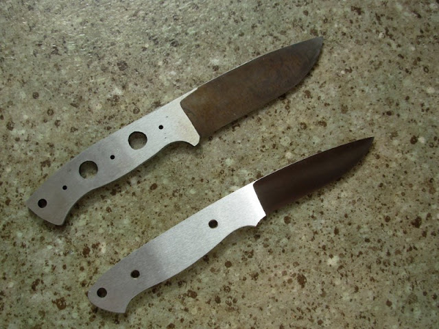

sure, there isn't much more done, and it is hard to photograph the sanding in this light.
This is how I got it back from Nick. He did a good job and the blade is quite clean. I think he may have used some sort of light abrasive to clean off the crud I left on there. Below it is the nice little knife he sent me. I will get some nice wood and corbies and finish that one, it should turn out nice!

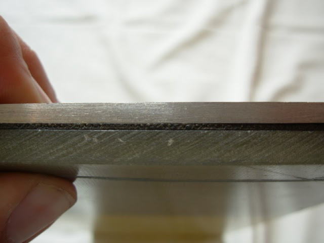

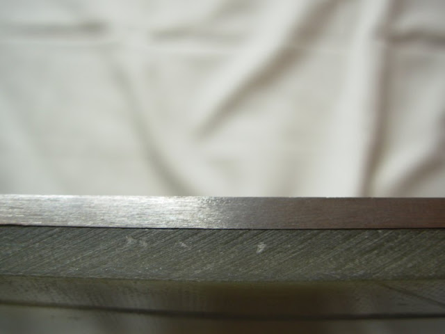

Nick surface ground my knife, showing if the grinds were even, which they were pretty close IMO.

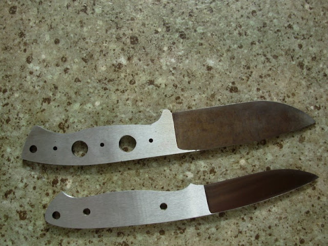

other side:

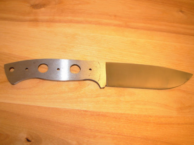

crappy photo of it cleaned up to 320
Thanks for posting the pictures! That really looks great. I can tell you have put a lot of time and effort into your work. Keep us posted on your progress, I'm interested in seeing the full finished product!
