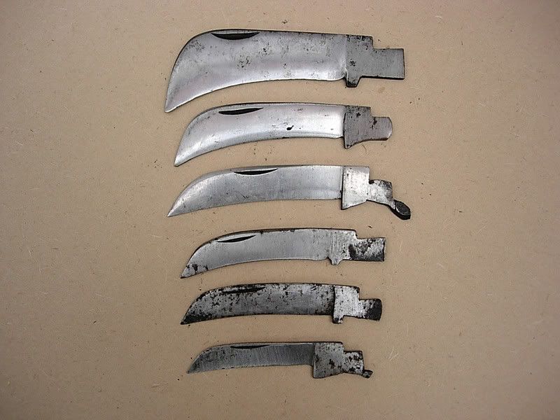

I believe forging blades with a 'stove pipe' kick meant that they were much more adaptable. The square kick could be filed down to meet the requirements of each particular knife without changing its shape. From the times when each knife was an individual.
From the days of hand forging, the 'neb' is the little bit at the end of the tang that gave the forger something to grip. Of course, it was then removed once the blade was properly shaped and ready for finishing.
See bottom and 4th from bottom blades in photo.

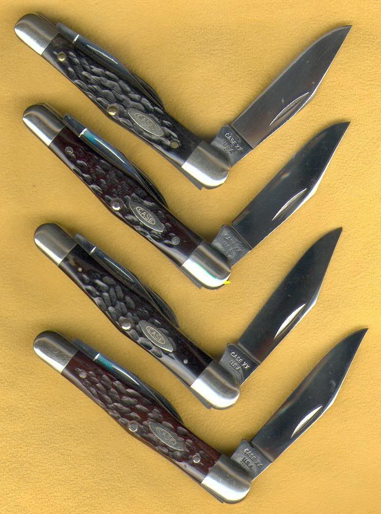

If it's reddish brown, is it redbone? How red does redbone have to be? There are some purist who take a narrow view of redbone, mostly Case collectors. I think there is no disputing that these are redbone;

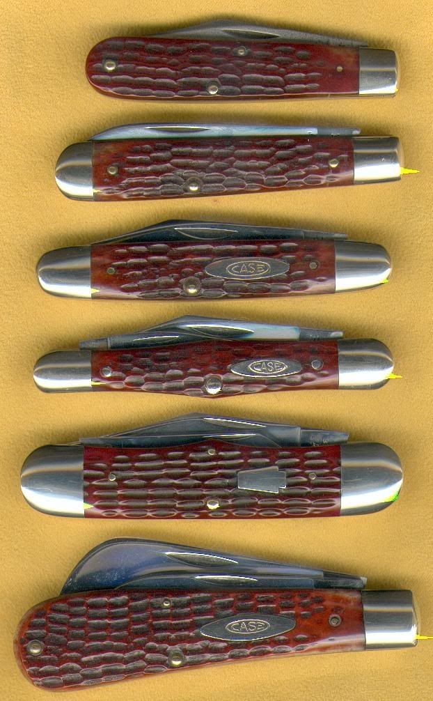

But what about these?? they certainly have some reddish color in them, but are they redbone?? Or even Greenbone??
I don't know. Opinions please.
I have heard that Red bone stopped in Case XX (1940-64). Therefore no USA XX (65-69) had Red bone Scales or Case XX USA Dotted Knives (1970- 79). Also Green Bone Stopped with Case XX (1940-64). More than one Case Expert has told me this.
Thanks waynorth for the pictorial of Case redbone. The bottom two knives in the top photo have a distinctive jigging pattern, longer lines. Is there a name for that type of jigging?

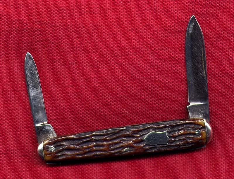

I've always liked New York Knife Co. bone. I'm told this Smith Brothers knife was done by NYK Co. Sorry for the crappy scan.
Thanks for the link, Mike. And for showing us your Smith Brothers! That's a nice one. We talk about jigging a lot around here, so I thought I'd follow the NYK path for a while, as a way to get into some disscussion on the different types.
