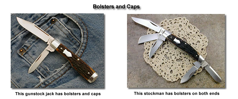

Bolsters are the component of a knife handle that creates a heavier support for the pivot pin of the blade(s). They also protect the end of the handle from damage from an impact that could chip the handle material, as in an inadvertant drop. Bolsters are also part of the aesthetic appeal of a knife and are often decorated with special grinds and engravings.
Caps are a decorative and protective addition to a knife handle and are found on single blade and jack knives. As with bolsters, they help protect the end of the handle from damage. Caps are also treated in the same way as bolsters in the various ways that they can be made fancy

On the left is a dogleg jack with caps and bolsters and the same pattern in a barehead version is on the right. "Barehead" is synonymous with "no caps".

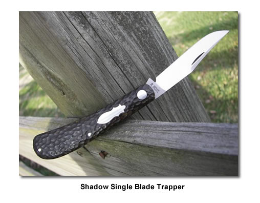

Here is a single blade trapper shadow pattern. "Shadow" is synonymous with "no bolsters or caps".
Great knives Kerry.... I particularly like the jack knife. I always called them double bolsters butt the cap makes more sense. A knife with no bolster is a barehead as exemplified by this sinister looking knife.
oops!!! I stand corrected. Shadow pattern then.

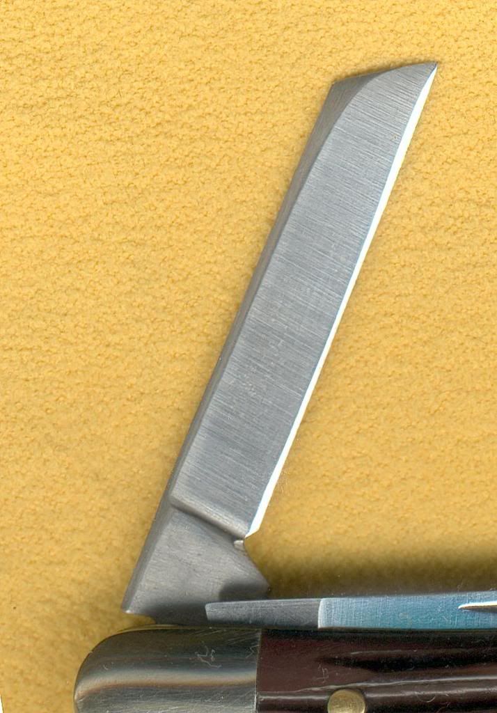

A COPING blade is usually a straight, relatively thin blade for use in shaving moldings to fit, in carpentry. When you join a decorative molding at a corner, for instance, to a achieve a good tight fit, you trace an outline of the profile on the piece you are fitting, cut it with a COPING saw, then trim it with a COPING blade for the final fit.
The thin blade helps you shave inside a curve for that final fit. You can also use files and sandpaper to help achieve a good joint, but an experienced finish carpenter can do it all with the saw and a coping blade, for a fit that is much superior to a miter joint, on complex (i.e: crown) moldings.

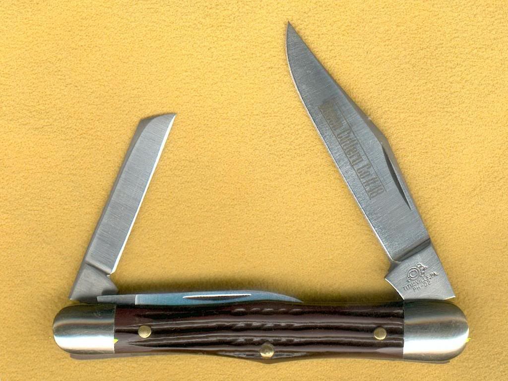

Here are some pictures of a Queen whittler with a nicely designed COPING blade.
Those close-ups I do are brutal! Show every flaw! Note the "slip" near the choil on that Queen whittler. It won't affect the function; that knife has D-2 blades, and Delrin handles, and is ready to WORK, but that little ding wouldn't be acceptable on a custom knife.

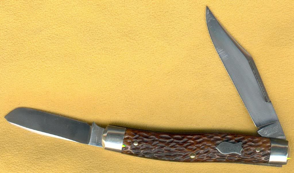

While we still have premium stock knives nearby, here's a knife that I think of as a derivative of a stockman. It has the same handle profile, and a clip master blade, and a spey blade which is a stock person's tool. But it only has one backspring, and is missing the third blade that would put it in Premium Stockman territory.
O.K, O.K, it's not a two blade Stock knife; but some reptilian part of my brain wants to call it that.
Schrade calls it a Texas Jack in their Catalog E published in 1926. So let's segue on into;
