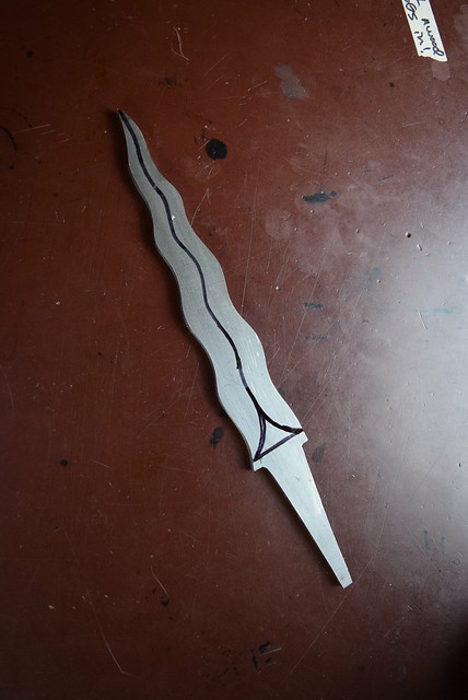

That steel won't take a hamon. All blades need grinding and/or sanding afterHT. Don't go below .02" at the edge pre-HT. Use sandpaper wrapped around a dowel to sand along the curves. Files won't cut on hardened steel. Stones, abrasive paper, grinding belts are needed after HT.

Well, I finished most of the grind at 80 grit just free-handing (this is post HT).
I will jump to 120 and up to finish.
No major problems yet.

I still can t feel my fingers :) it seems that I forgot how deep scratches make file ...... I end up with almost sharp edge at the end . HT and temper , done , no bend no wrap and hard . Now handle .............Balance on this kind of knife , where is best to be ? I need to know before I start to work on handle .....Always when I HT blade I HT small piece of same steel to see inside....
Knife is HT to red line , is it that some problem ?

Im right if I think that on horizontal belt grinder with contact wheel will be best to grind this thinggggggggggg?
I've been grinding just on the edge of a flat platen with the belt overhanging a little. I'm not sure what will happen with the higher grits when the belts get more flexible...
OK, I ran the belt slow and didn't have too much trouble taking it up to 320.
