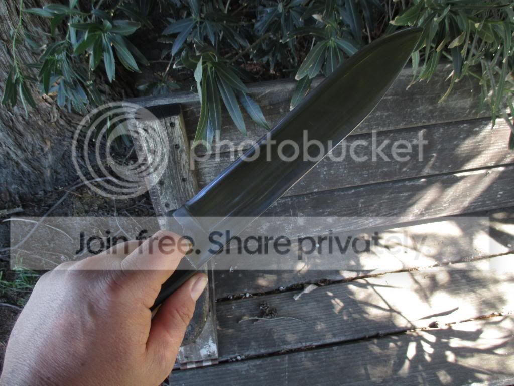

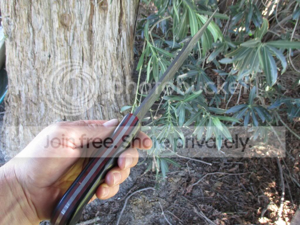

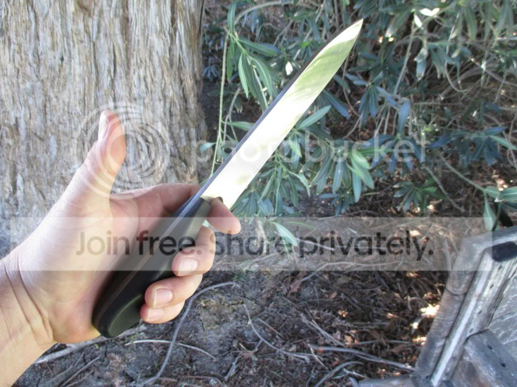

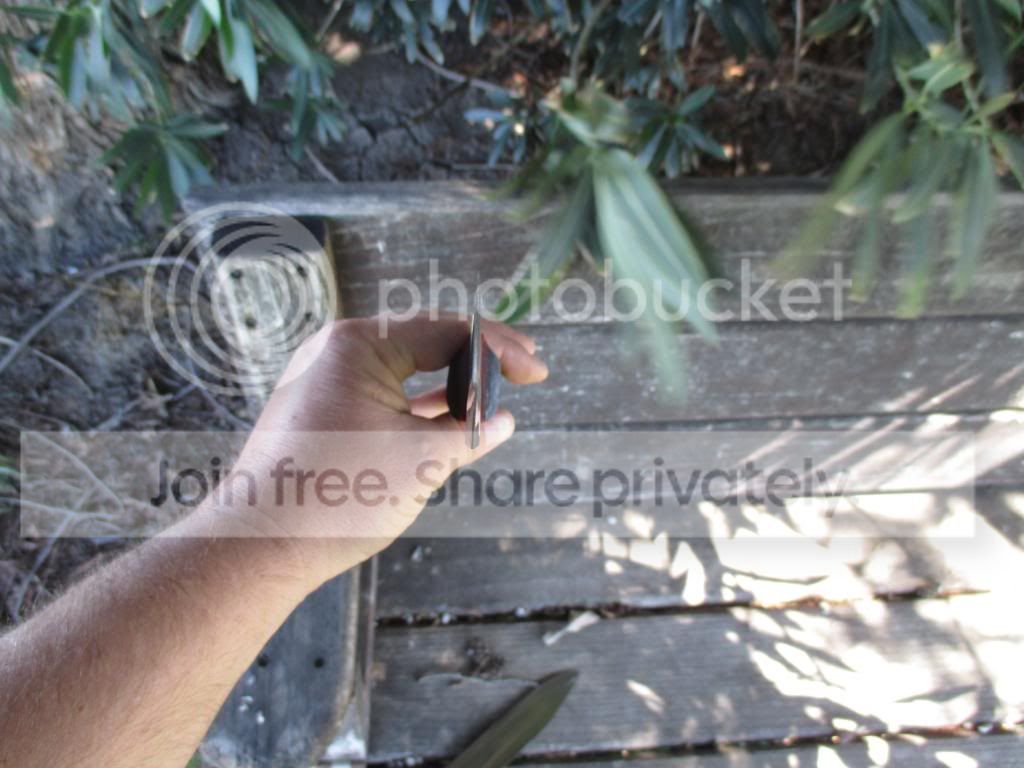

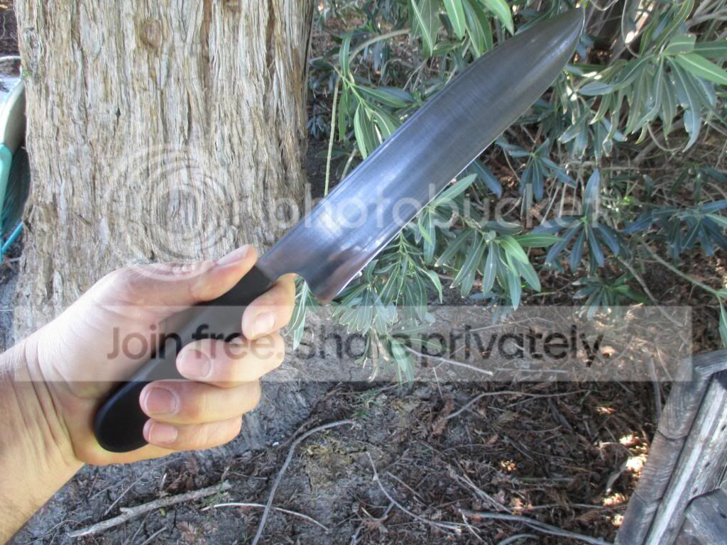

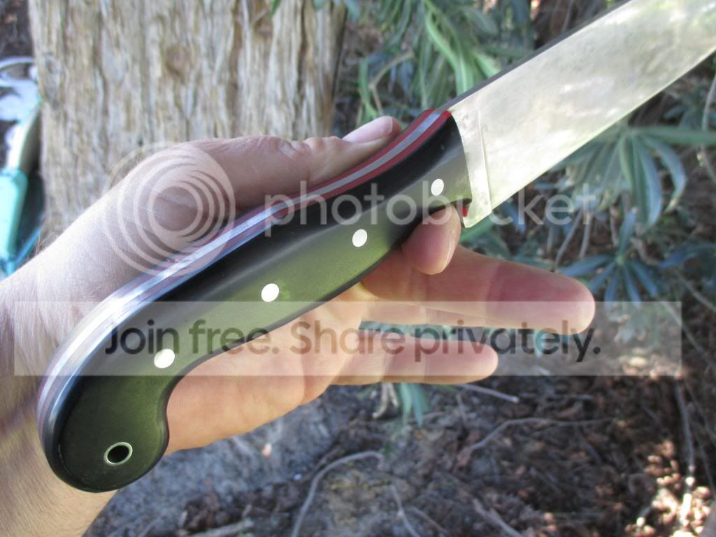

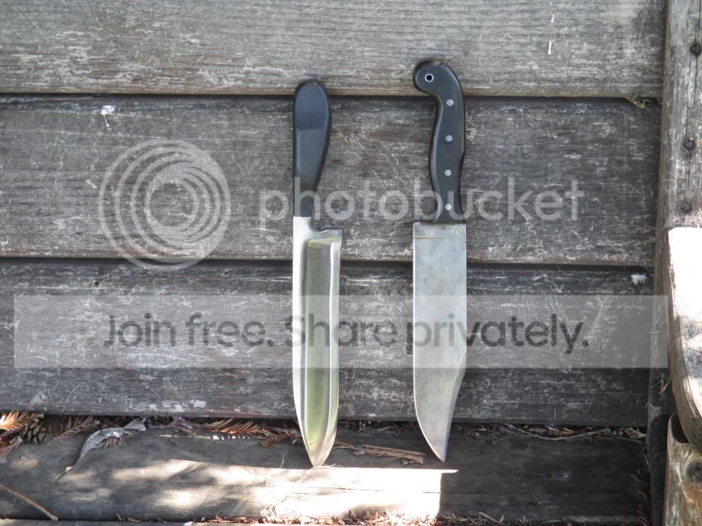

I'm getting to spend a bit of time with one of Richard's knives: K2. I brought it out with the camp knife I just made myself, while spending some time at my sister's place near the Sacramento River Delta.
Richard's knife is differentially hardened, with a sweet convex chisel grind, and really comfortable neoprene handle scales. Mine is fully hardened, full flat ground. The blade is much thinner than Richard's but doesn't take as nice of an edge. Also after handling K2, I feel that I need to put some lateral contours on my handle scales, so it feels a little better in hand.
K2:
Mine:
The tip of my knife is much more fine. I think Richard's knife cuts better and would handle more "abuse" than my knife ever would.

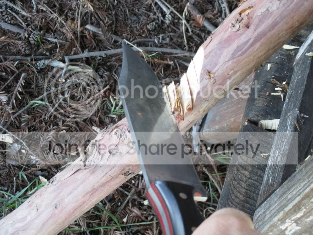

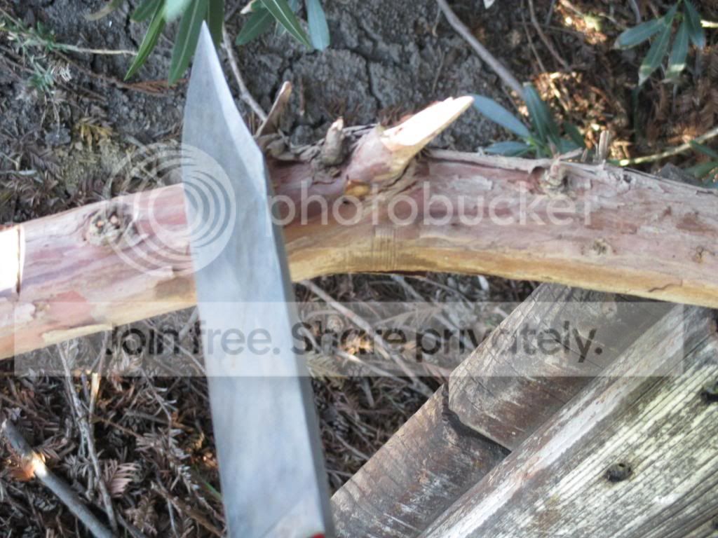

Here I chopped at a dried out sycamore branch with the knives.

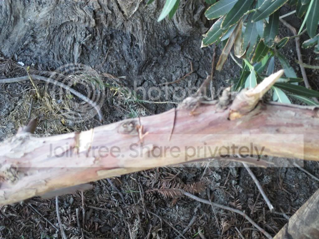

Richards knife popped out a nice chunk of wood. Mine cut into the branch, but stuck in it a little.

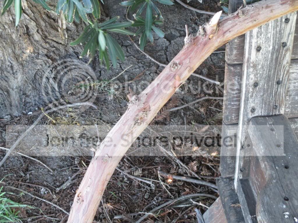

Here I chopped at the branch with both knives. Richards was able to make a better perpendicular cut- really did a number on the branch.

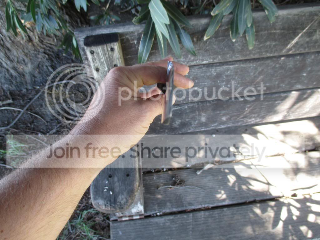

Of course, the edge on Richard's K2 is still shaving hair.
