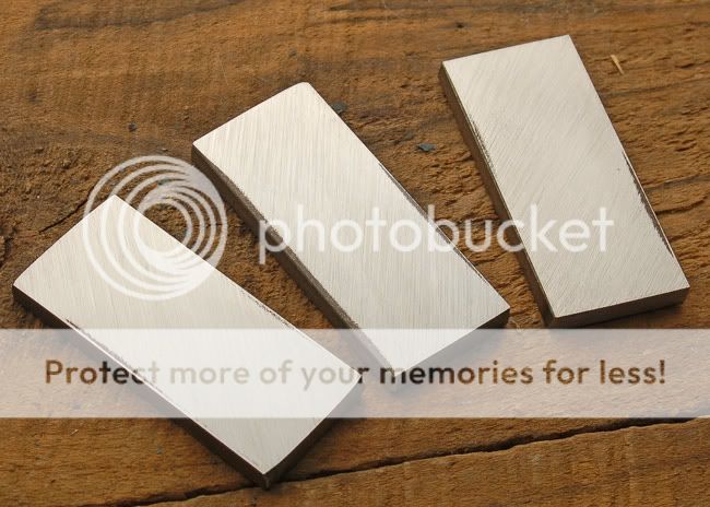

Here, three pieces of steel, (two 416 stainless and one 52100) are cleaned.
Some Loctite Professional super glue (not the civilian stuff, the Professional grade) is applied to each piece.
The pieces are clamped and left for at least 48 hours. If left for less than this, the molecular diffusion will not adequately take place.

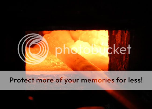

Here's the actual start of the process....

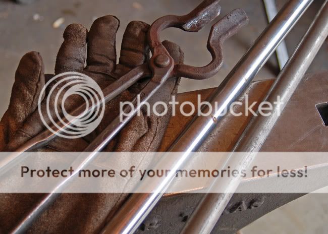

Here are two bars of steel. 416 stainless and 52100. I use round bars for a lot of things, mostly because I can use it to make a lot of different sizes.

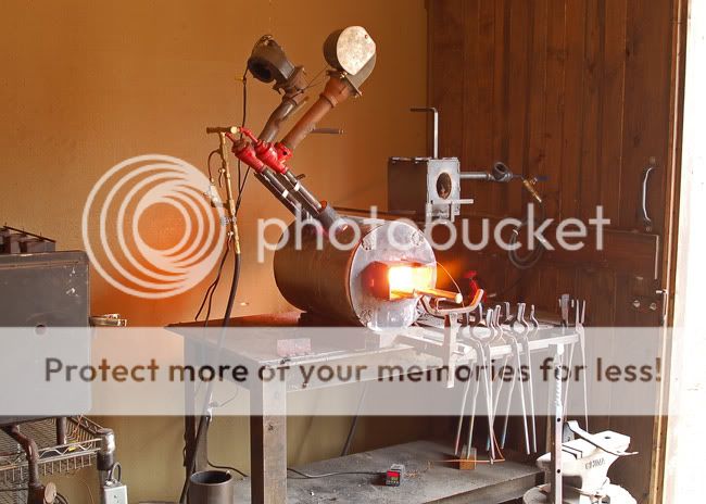

Here's my goofy forge. Last time I built a forge, I thought the venturi burners would be the way to go. They worked well for a while, but as they deteriorated, they lost efficiency, so I added one, then two burners screwed right into the top of the burners. I'm going back to blowers, but I haven't gotten around to rebuilding the forge. Just FYI, the small forge on the right is a Len Landrum 2-brick forge that's super slick for regular non-welding type forging.
Heating up the stainless...

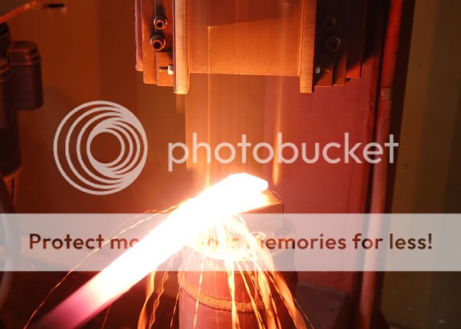

Flattening it under the power hammer. You can get some really cool photos with steel this hot.

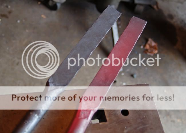

Here are the two pieces of stainless, about 1.5" wide and 5/16" thick.

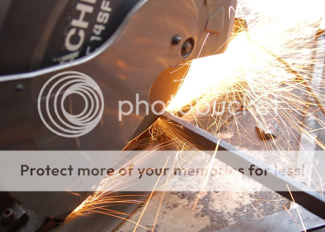

Cutting the bars to length.
