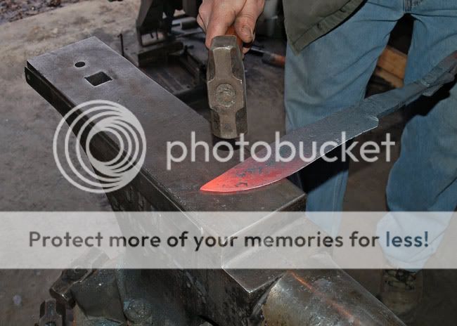

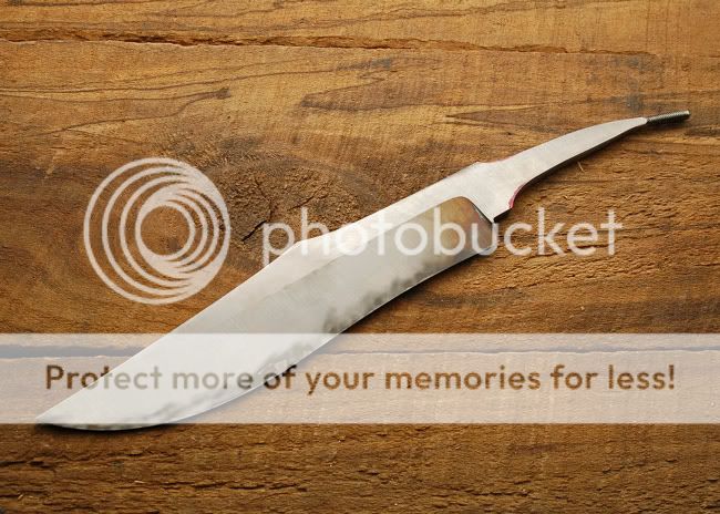

Lorien, no this will have a clip point, but I dare not try to forge the profile too close as strange things can happen with the core. It doesn't hurt to forge the steel on edge, but when the shape gets this far along, you can distort the core more than you'd want to.

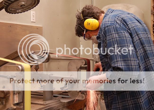

Rough grinding the profile, and yes, I'm having a bad hair day. :D
I've ground down to the outer edges of the core...

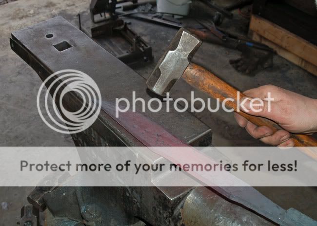

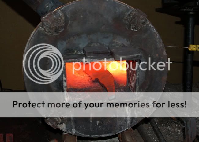

And I re-heat the blade...
And re-forge the edge until it's perfectly straight.
I start at the base of the edge and end at the tip. This will ensure that the core is in the dead center of the blade.

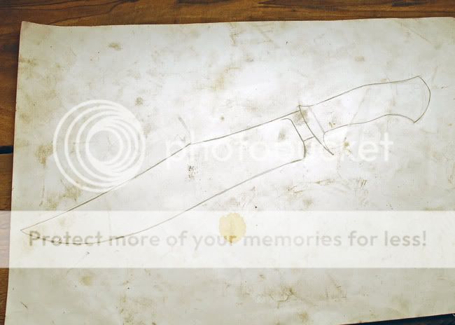

Once the blade is forged, and the profile rough ground, the whole knife is sketched out. From this point on, I really try to work to the drawing. And apparently times here are tough because even for a knife this nice, I still use a piece of paper that looks like it was sitting under an old, leaky car for the last year... :confused:

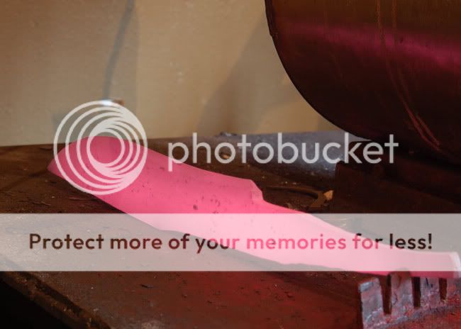

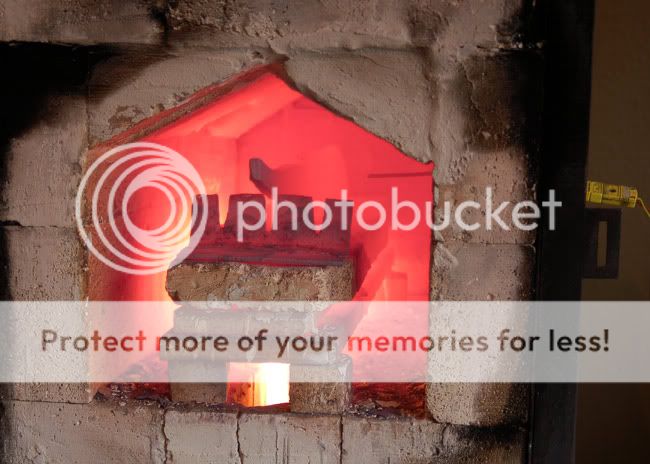

Blade is in the heat treating oven for normalizing. Just in case it's misleading, there is a door on the oven, but for the photo, I opened the door.
The heated blade is allowed to air cool during the normalizing process.

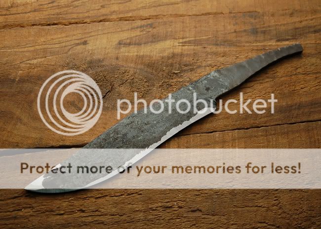

And here is the blade rough ground, prior to heat treating.
