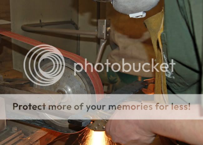

I'm grinding the weld off the edges of the billet. Didn't want to wait for it to cool down, so it's screaming hot and I'm holding it with vise grips.

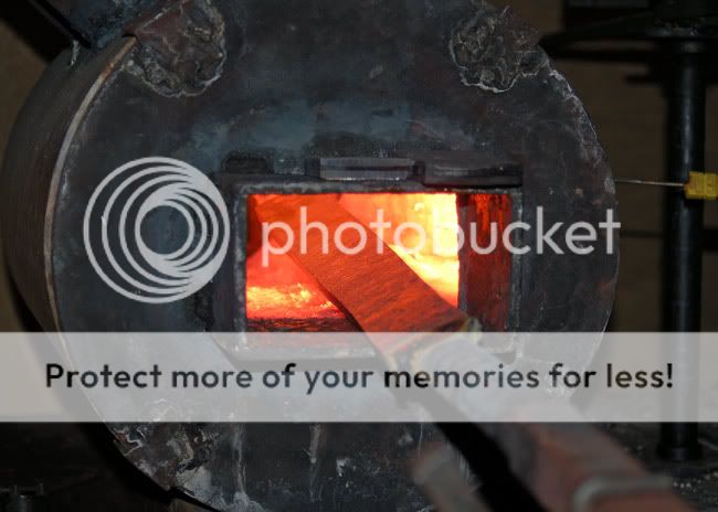

Re-heating the billet.

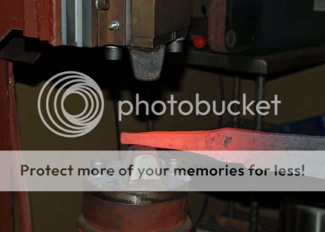

And now the point is done. It's a lot easier to just put a thin core into these laminated blades and grind them to shape with little or no forging. But forging is fun, and being able to forge the blade to shape shows the strong bond between the layers.

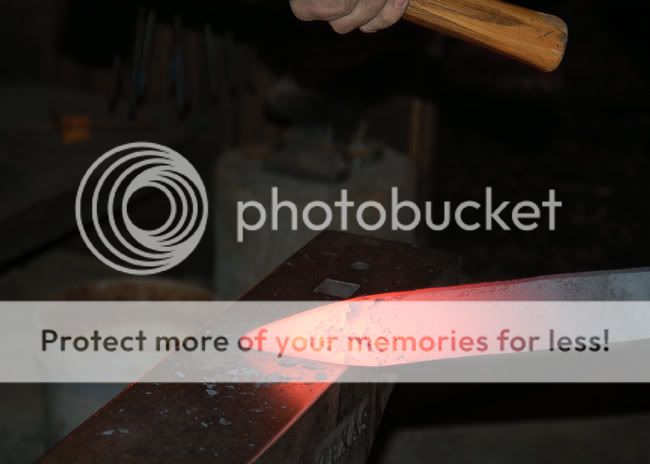

Forging the lower edge narrower, as this will be a recurved blade.

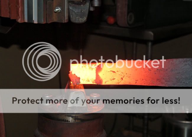

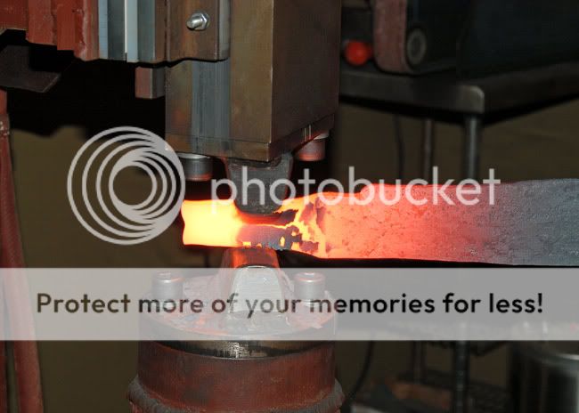

This is one of the little known dangers of getting your steel too hot - it can eat off the front of your hammer. :D

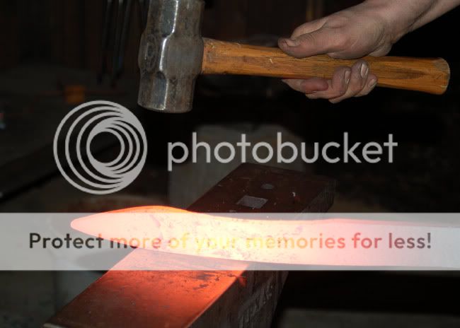

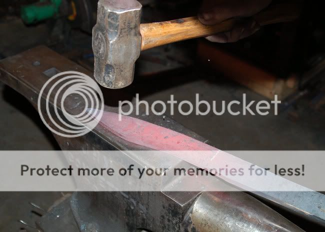

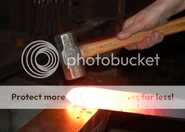

Fixed the hammer. I hand-forge the bevels first before starting with the power hammer.

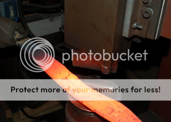

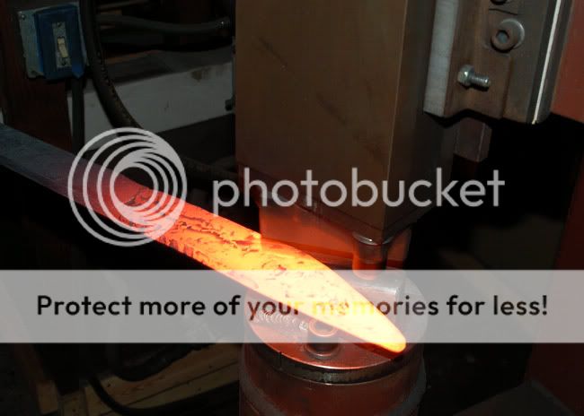

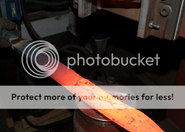

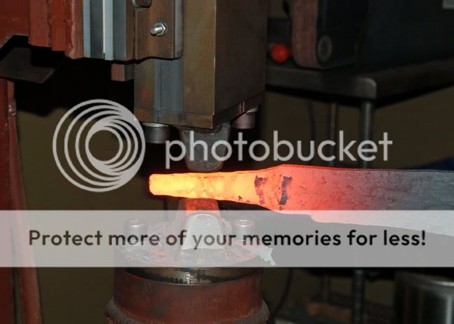

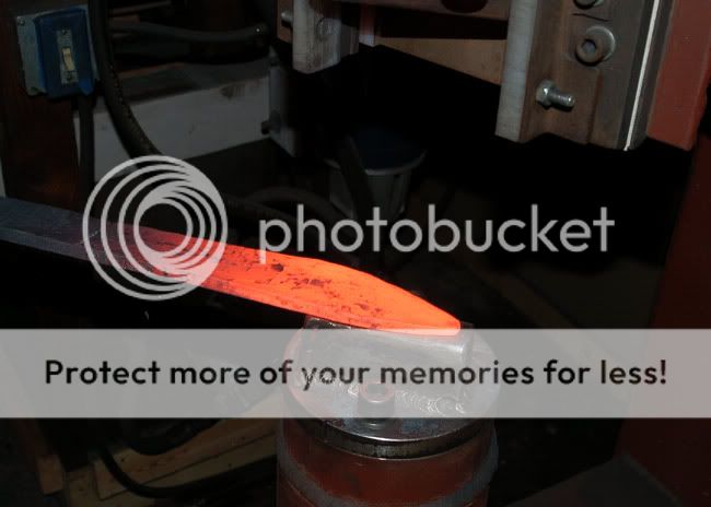

Pulling the bevels down with the power hammer, starting at the choil...
And finally finishing with the tip.

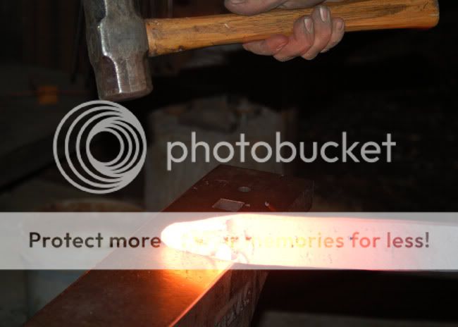

After the power hammer, I'll go back by hand and clean up the forge marks left by the hammer. This is as close as I'll forge the blade profile on this knife. With laminated steel, you need to careful that you don't try to forge in every detail if doing so might radically affect the placement of the core steel.

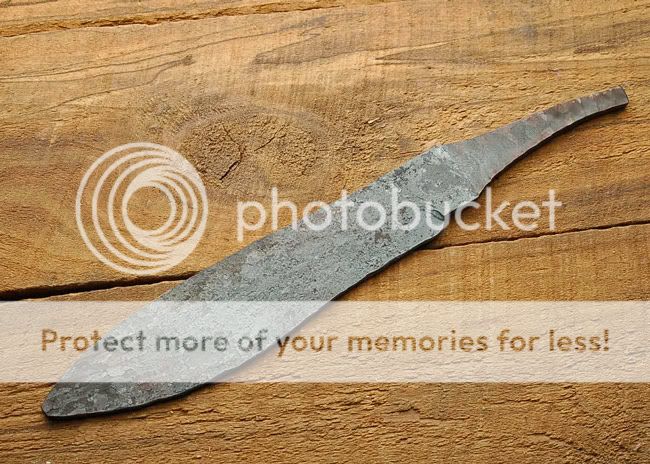

And the tang is done. For now....

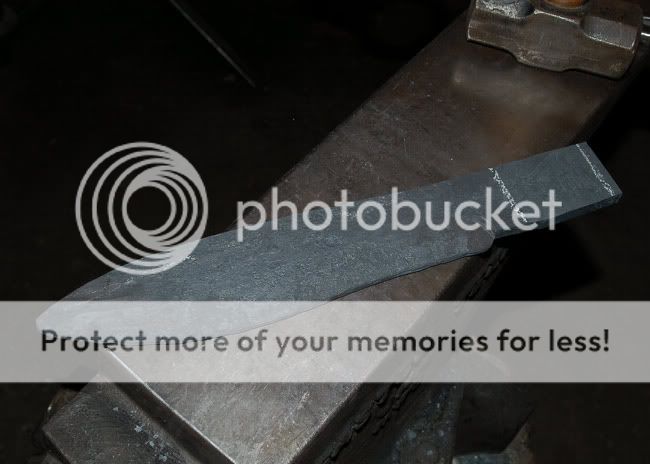

This is the blade, as forged, before I start grinding. There will be one more forging step to come, but this is where I am for now.
