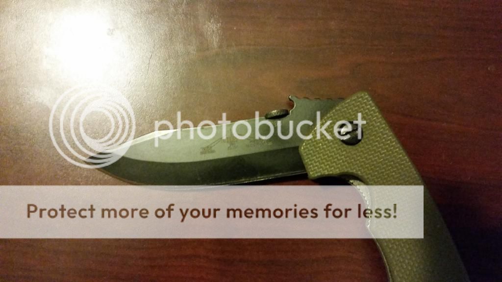

Last week I bought a few knives of which one was my first Emerson and a Lansky sharpening set.
The Emerson is a CQC 8BT which was hard to open and gritty and had lock stick. So as with all my I spent a few days flipping it and working it, then pulled it apart, cleaned everything, NANO lubed the washers and reassembled. Grit was gone, and became very smooth to work and lock stick was gone. However now lock contact is lacking and pivot screw loosens. A little Blue Locktight and pivot pin is good, but liner lock will probably need to be sent in.
Usability: The blade tends to want to deploy too easily when removing from pocket and thought needs to be given each time I reach into that pocket to prevent being bitten. Also, when deployment is wanted, the blade tends to grab outer garments, I think this is a blade size thing.
Sharpening episode.
This happens to be the knife I had in front of me when I decided to try my new Lansky kit.
Problem one... The rubber in the vice jaws kept sliding around
Problem two... Grip and method - ALL ON ME
Problem three... Emerson has NO defined angle from the factory
Result: Started at 20 Degrees - Bad move, really opened up the exposed edge from the black blade and nicked a couple of spots I didn't want to.
Deciding now I have an expensive beater, I moved to 25 degrees on both side and it is now sharper than a mean woman's tongue.
In the end I'll be carrying this as a work knife and will need to send it in to get the lock fixed at some point.

They have a chisel edge. One side is sharpened 20° ish and the other is flat. Is the flat side where you meant it has no defined angle?
I found out too that if you rebevel your blade to have a standard V edge as opposed to the Emerson chisel, it voids your warrantee. I myself do not care for the chisel edge and had it professionally redone to the more common V type edge.
When I sent in the knife to repair the liner lock from sliding off the blade face with very little spine pressure, they refused to work on it because of this. Told me I voided the warrantee, even though I'd never had it apart or anything and the knife was basically new. I wasn't very happy as I didn't understand what one had to do with the other. Don't carry an Emerson anymore. But many others are very pleased with theirs, which is fine.
i think he means it was hand/belt sharpened or whatever the emerson factory does............ so the bevel, like just about every production knife, isn't even in angle. this is one of the curses of sharpening with a fixed angle sharpener. free handed on a belt or whatever sharpened requires adjusting to match the bevel or reprofile.....
i tend to reprofile them when i can't keep them sharp on the sharpmaker anymore. major pain, but it is what it is....
that said....my emersons all seem to come closer to high 20's to 30 plus degrees on the bevel side, and there is a micro bevel on the other side, but i couldn't tell you the angle...maybe 15 degrees? just a guess...
i have maybe 6 emersons and all are no where close to 20 degrees on the bevel side. maybe i got unlucky with who sharpened mine?
It took me a sum total of 2 seconds looking at my first Emerson to realize I was gonna need to sharpen it freehand. Quickly found that the ceramic rods that come with the sharpmaker and a strop will keep an Emerson screaming sharp. As for QC issues, mine are all 2014 knives, and aside from my Traveler being slightly off center outta the box, which I've since fixed, I have no complaints whatsoever..... and if you don't like the wave feature, remove it.
