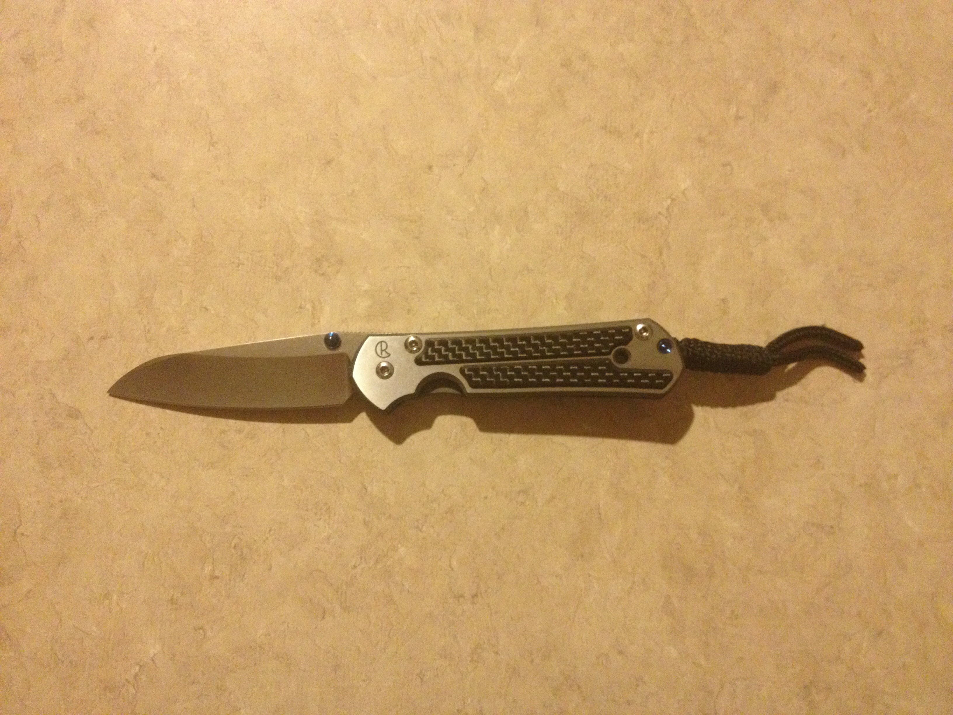

on the modified wharncliffe front, and that slight curve upward - it is a similar profile to the sebenza insingo
I've got one, love it. in reality, the cutting edge itself isn't really all THAT different from a classic drop point, just a little less belly at the end. with less accidental pokings and a beefier tip. it's actually one of my favorite cutters/slicers.
I do like the looks of that blade shape! It's a nice gradual curve. Nice.

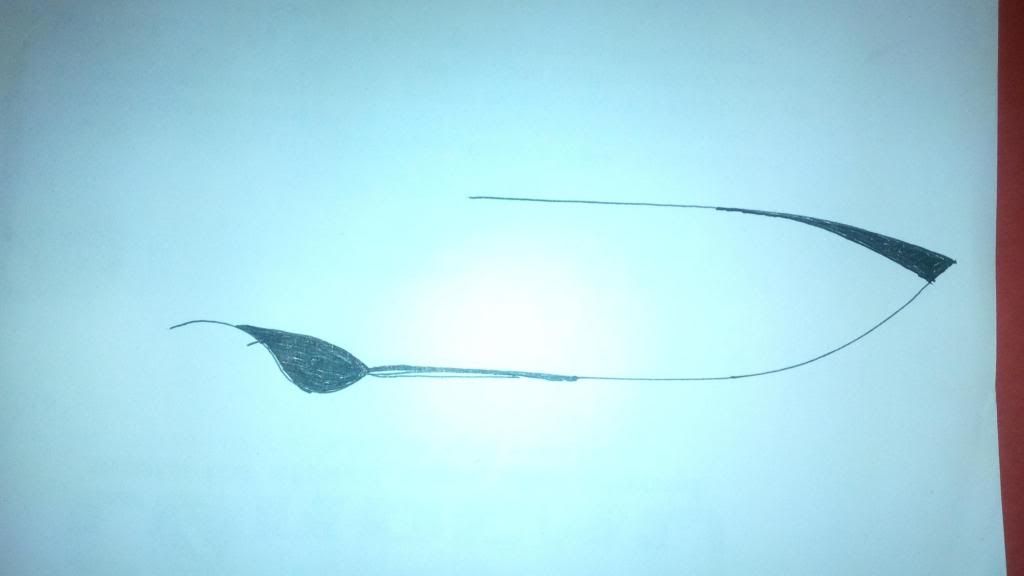

So, this is what I was thinking. The darkened part are the original blade "negative". Mind you, I'm not an artist and I don't take good pictures with my phone either. So without further ado, here we go.
Drop the point down more in line with the middle of the of the blade (in the picture it may not be exactly the middle but yeah) and then take out the ricasso allowing you to come up much farther towards the blade. I was actually thinking of taking it right up to the sharpening notch.

What's up guys? Sketched out a few designs last night and this morning. Got my scanner working so I was able to get a decent pic.
Still playing around with the butt end of the handles and trying to get my blade lines and curves right. Man it's so much harder than it looks to draw this stuff out. lol

Nice drawings.
I'd recommend not curving the back of the edge on the modified wharnie because it will make it difficult to use against flat surfaces. Also, the edge will get very thick there because you'll be moving up the primary bevel.
I like curly maple. It's not super tough though, and it can move a good bit after you shape it if it's not stabilized.
how about laying back the drop a bit more, add a top swedge and a recurve at the edge going towards the handle? don't have a photo right now, but it would be similar to a muela commando. the bottom guard can follow the curve of the recurve in one flowing sweep, leaving a "talon" a la swamp rat guards.
