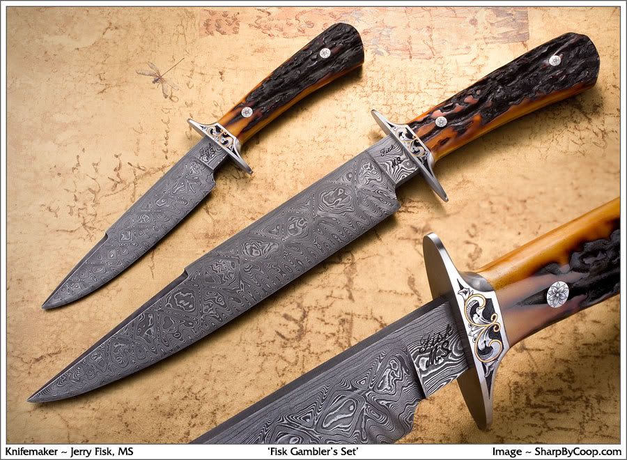

Kevin, the intimidating part about the handles on those knives to me as a maker are not the shaping of the stag scales, but the shaping of the bolts/pins that secure them.
Yep, Joe that's what I was getting at. ;) Doing a good job on the 'fit-up' and shaping of the stag while retaining that desirable stag color/look/texture can be fairly difficult as opposed to using wood or synthetic handle materials.
Here's better photos of the Fisk knives you referenced which demonstrate a complex but well executed use of stag handle material.
