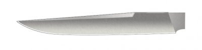

Gradient Tool...STEEL #1 Selected...Click and DRAG from above the Clip to BELOW the Edge....LIKE THIS!
attachment.php
”Pretty darn Cool! But, what if I drag diagonally across the other way?”
Try IT! In fact try lots of different ways. Why don’t you try clicking and dragging from inside the Blade Shape? You can keep playing as long as the Shape is still SELECTED.
BUT....WHATEVER YOU DO...DO NOT DRAG STRAIGHT UP AND DOWN!
When you’re finished playing, let’s see if we can make this look even more like Steel.
In the LAYERS Palette, you’ll see a Box marked LOCK...Click the Box and make sure there’s a CHECK Mark in it. This will lock your transparent pixels...or in other words keep the next actions inside the lines of the blade shape.
In the FILTERS Menu > NOISE > ADD NOISE...Mine is set to 3.79%...Gaussian...Monochromatic CHECKED.
FILTERS Menu > BLUR > MOTION BLUR...withe the PREVIEW Box Checked...ANGLE -45º...DISTANCE 8 Pixels.
