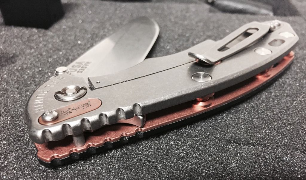

Decided to accent the spanto with some copper :thumbup::D
Love the copper liners. I put one on my Spanto a while back but switched out the scale and liner for full ti. Might need to go back to it soon. Nice shot!
I've actually been putting off finding a Ti scale now since I would have to remove the copper liner! I love the contrasting colors between the G10, copper and titanium.
