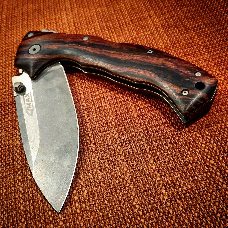

Zieg
Polished stainless steel is the worst thing for knife scales,so I dark stonewashed these with silicone carbide and fine sand and gravel. now its got a grip to it and hides marks,too.
