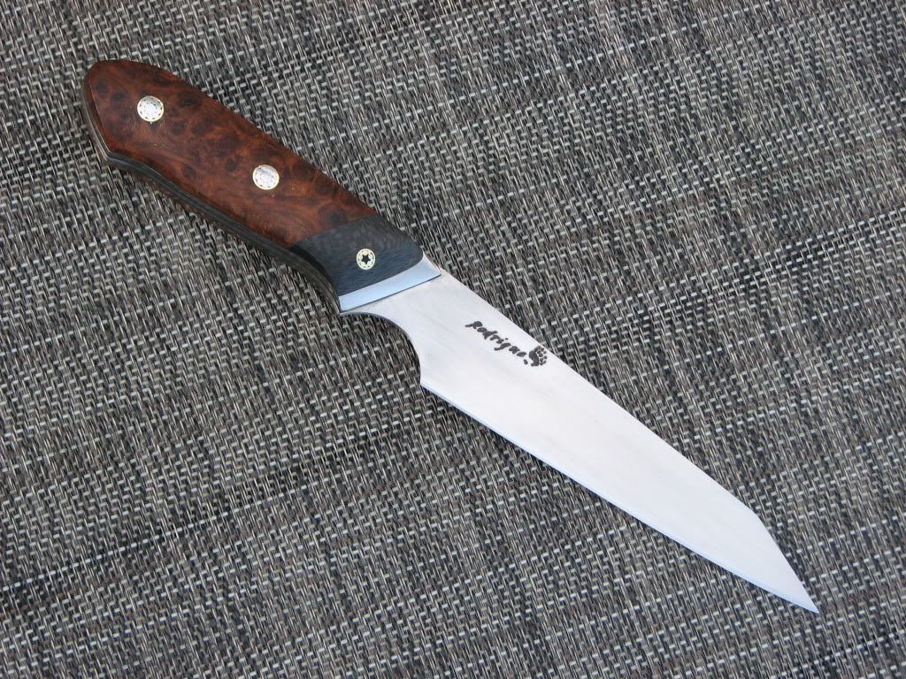

here's 2 of mine:
Pierre Rodrigue Custom Petty/Utility Knife (on its way to me in the mail)

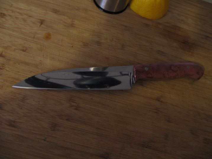

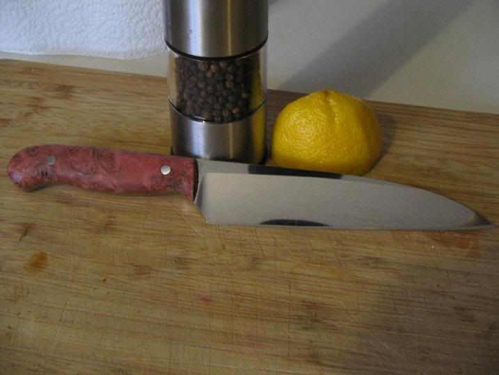

Brand new and shiny
[/IMG]
After a week with the beginnings of a patina
[/IMG]
