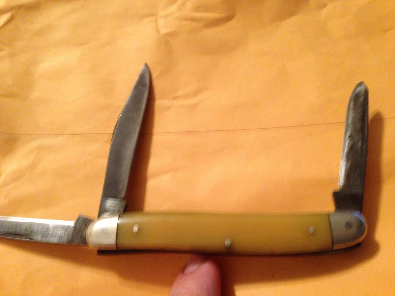

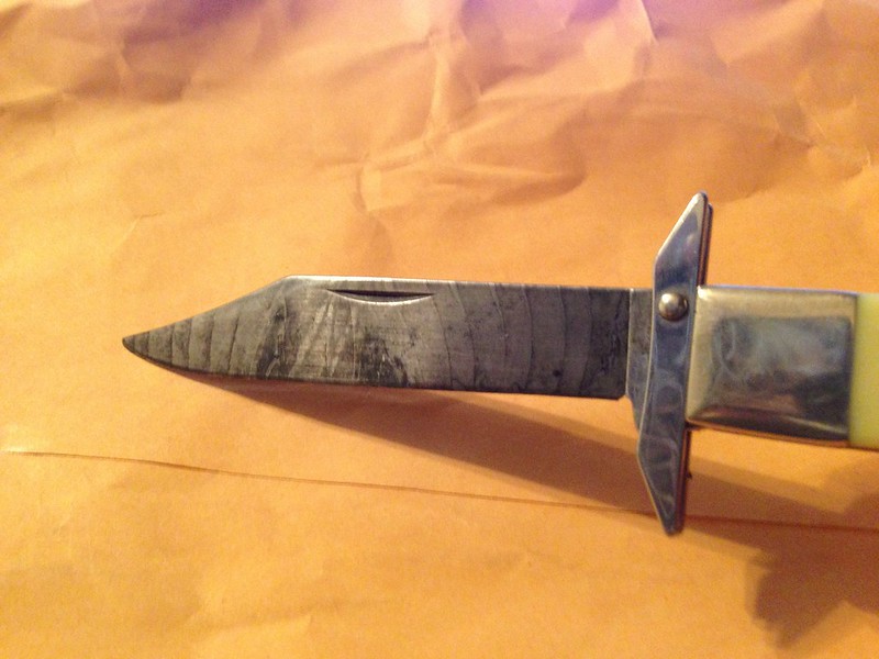

This is from when I was experimenting with patinas. I put two chunks of lemon on each side of the blade and left them there overnight. The smell was terrible! I got a kind of black finish very similar to the decarb you get when heat treating knife blades and didn't really like it at all. I never realized I could just lightly sand it off. Well yesterday I grab the Trapper and take some 1000 grit paper to it and viola! The black coating is gone and I was left with a very interesting pattern. I seems the acid from the lemon actually ate away at the steel and left a pattern sort of similar to damascus. You can actually feel the tiny dips in the steel if you run your fingernail across it.
Wow! That looks like it's a hundred years old!

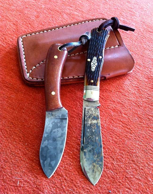

Here are a few of mine:
My Coghlan's Opinel #8 starting a nice patina.
the patina is getting started quite nicely after a week of consistent use. wish i would have taken a before pic.
