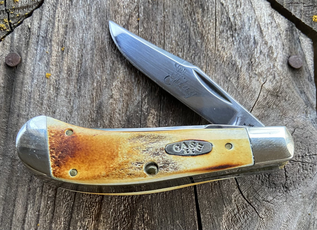

I'm not an expert but I can give my opinion.They don't have blade wobble; however, they are not as solid as some of my other knives. I'm sure they are within spec of what Case produces; although, they are not as solid as my GECs or Queens. I was trying to figure out why that may be the case, not pun intended......
Best regards,
The Case knives I own have a much weaker pull than GEC's , so the springs are not as strong and you don't get that snap like you do with a GEC.
Also the blades on Case knives are tumbled as part of the polishing process and the tangs are slightly rounded. So they are not square where they meet the backspring in the open position.
GEC's are perfectly flush. I don't know if this has anything to do with it, but it gives the impression of not being as solid.
