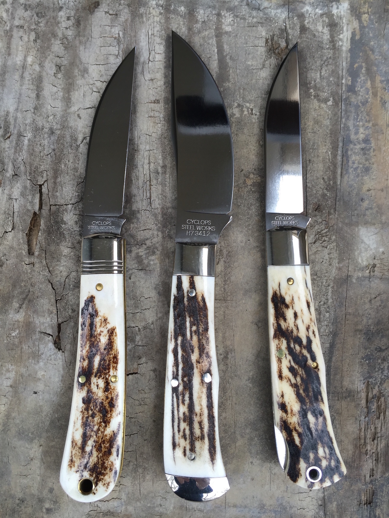

You're not wrong (removing material is one way) but it may sometimes be possible to peen the kick on an annealed tang to raise it a little. I think Charlie (Waynorth) may have posted some photos of his attempt. Here are some photos of one my knives. It's straight out of my pocket so please excuse any pocket lint.![]()
