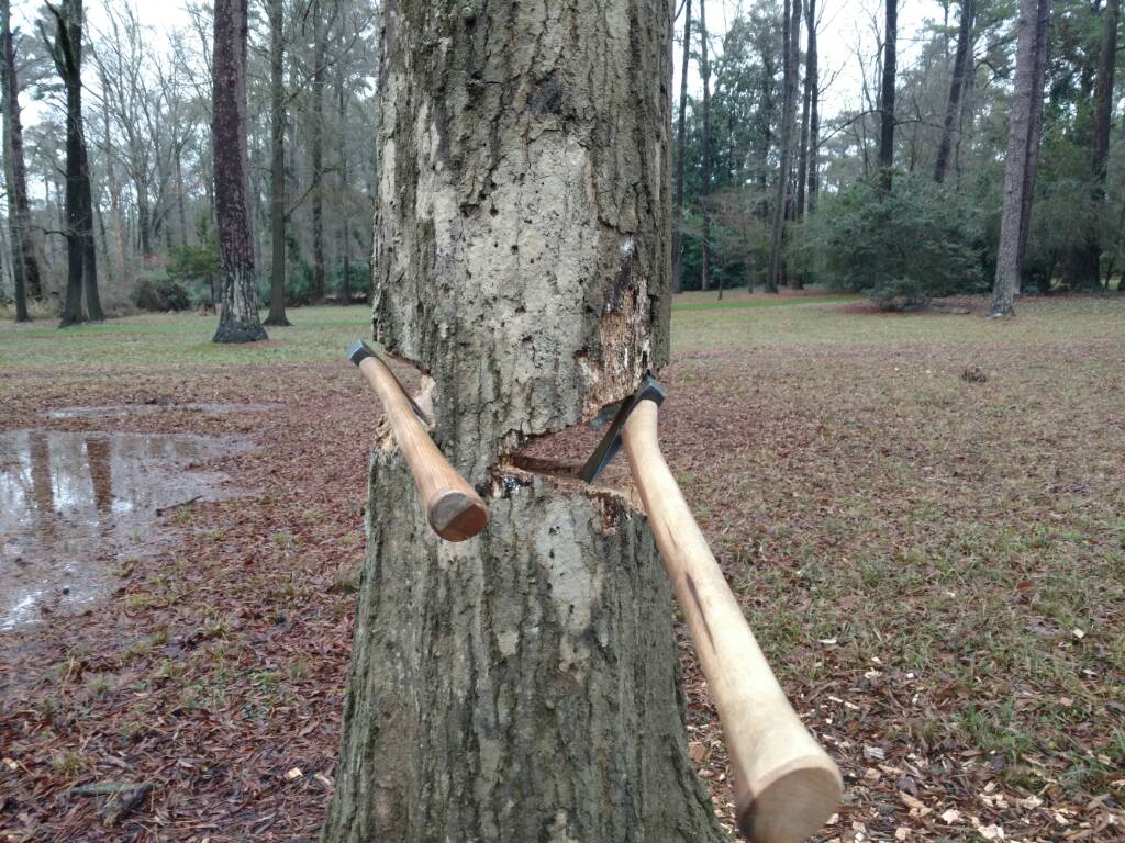

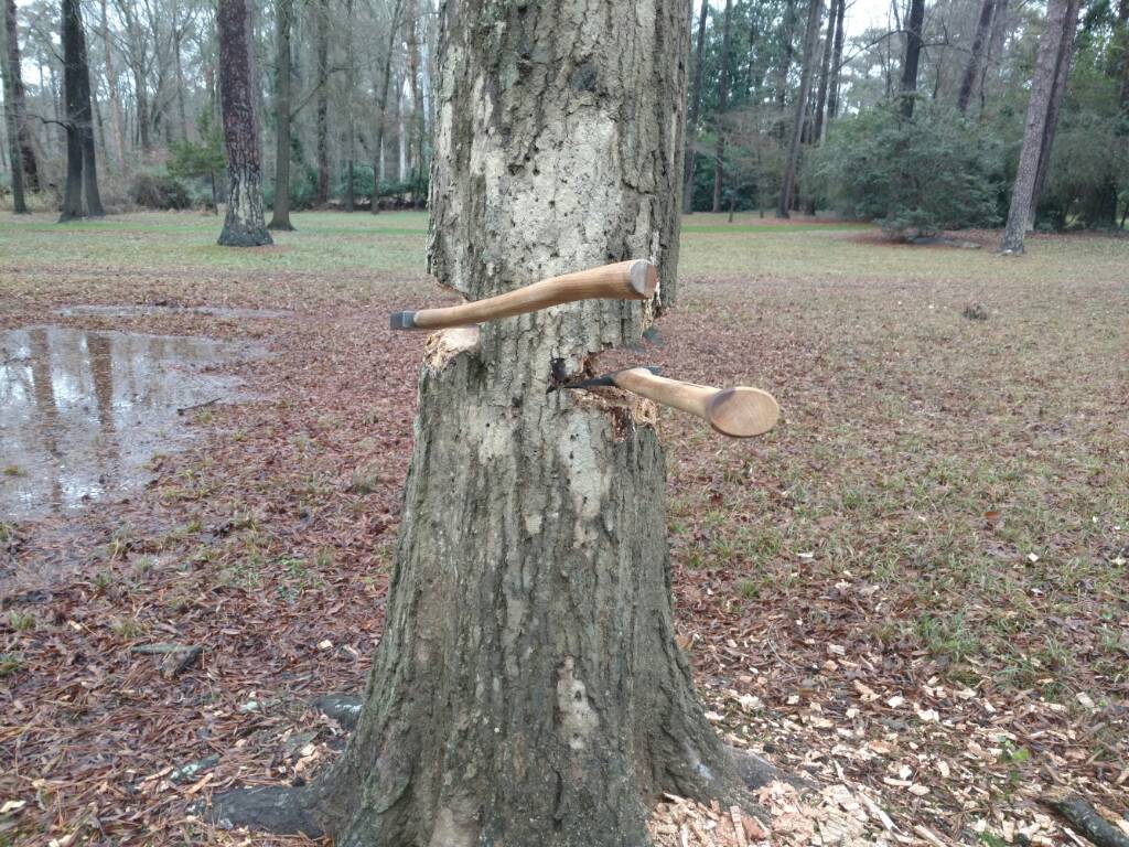

Lets use those axes for what they were ment for.

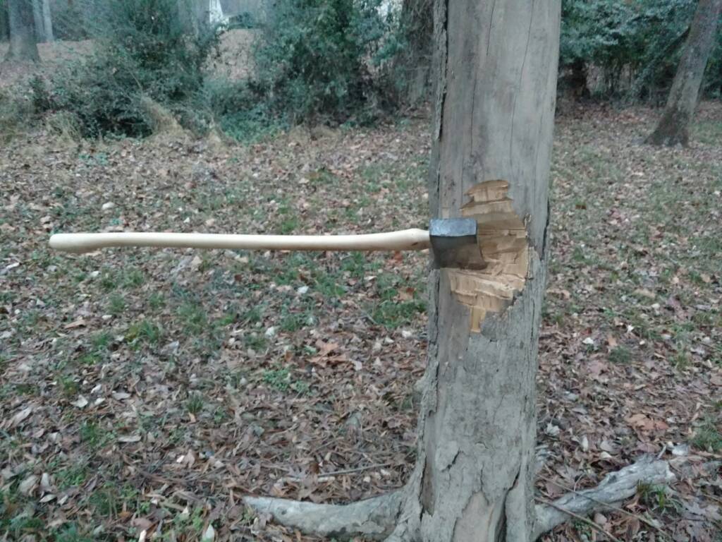

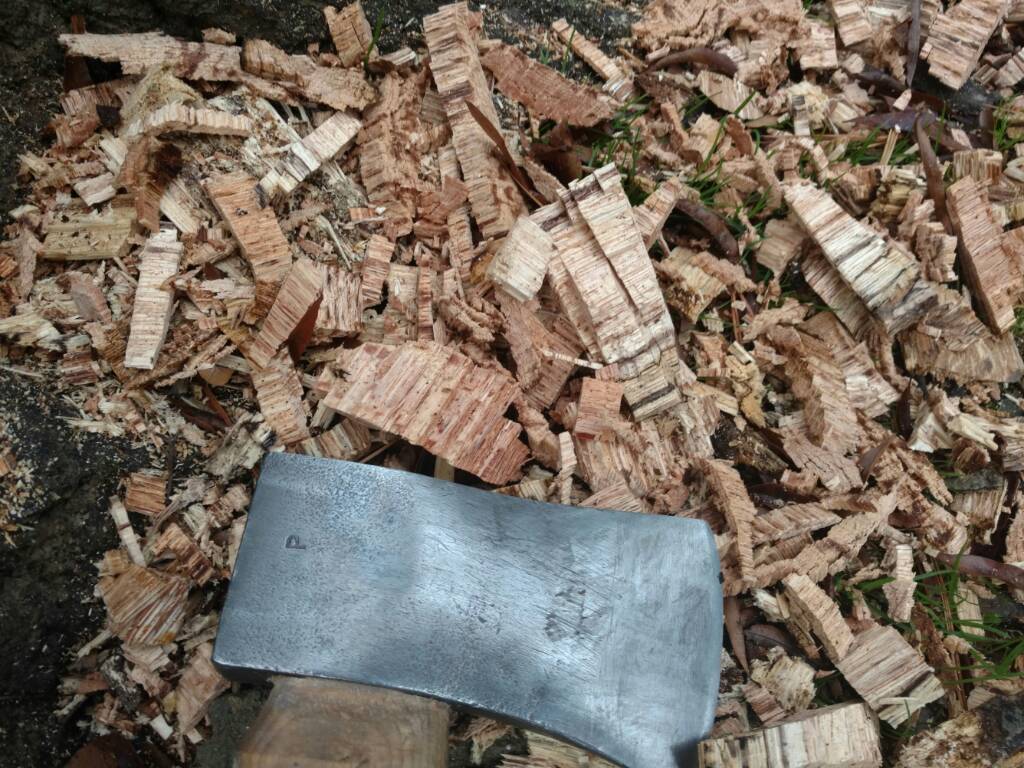

Some work I did yesterday next to the river on a dead gum tree. With a recently restored 4lb Collins bit

Good work. Is that tree recently dead?

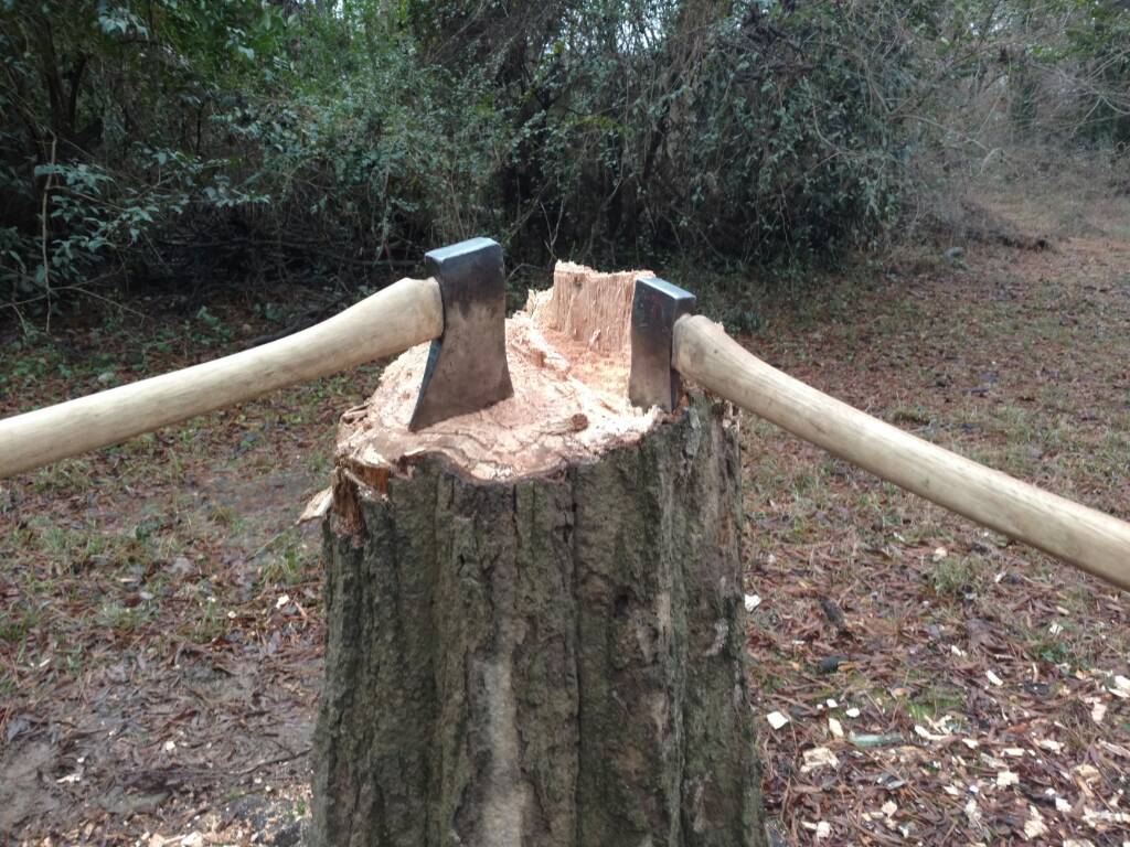

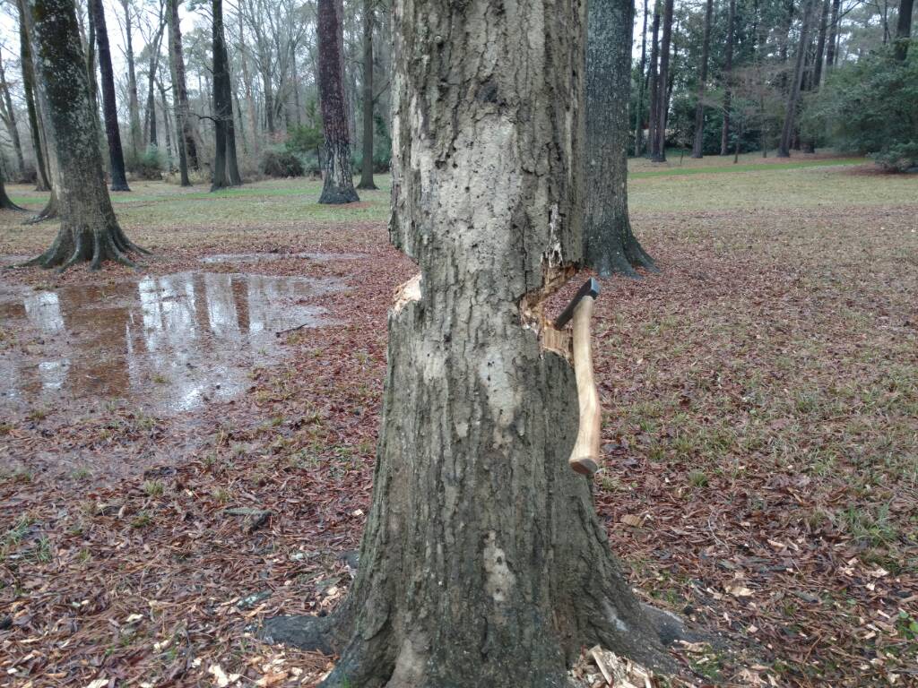

Since Hurricane Floyd hit us back in 1999 there have been several oaks that have perished in the floods. Just couldn't take being submerged in water for so long. Had to use a saw to get the last oak cut into logs. I'll post a pic below. Got to get these trees split into firewood within the next few days

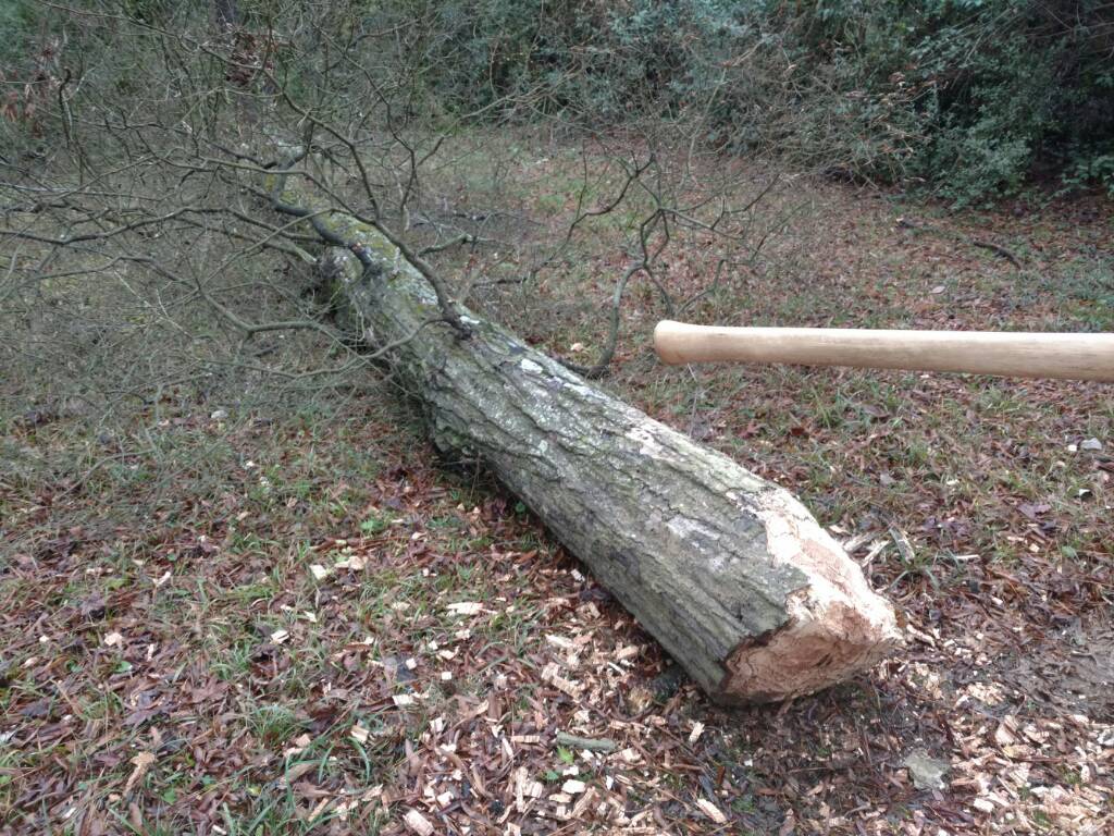

Once I got the first oak cut into logs:

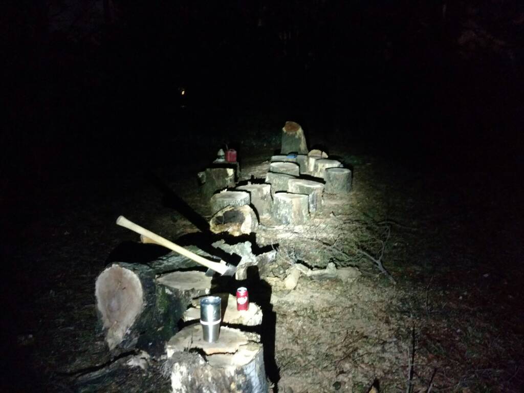

I hate for it to sit and rot so I process as much as I can into firewood. Some to use in the house and some to sell. I burn the scraps left over and use the ash to spread out on the property. Hopefully it is doing some bit of good. I'll know in the spring when I plant some food plots for the four legged friends.

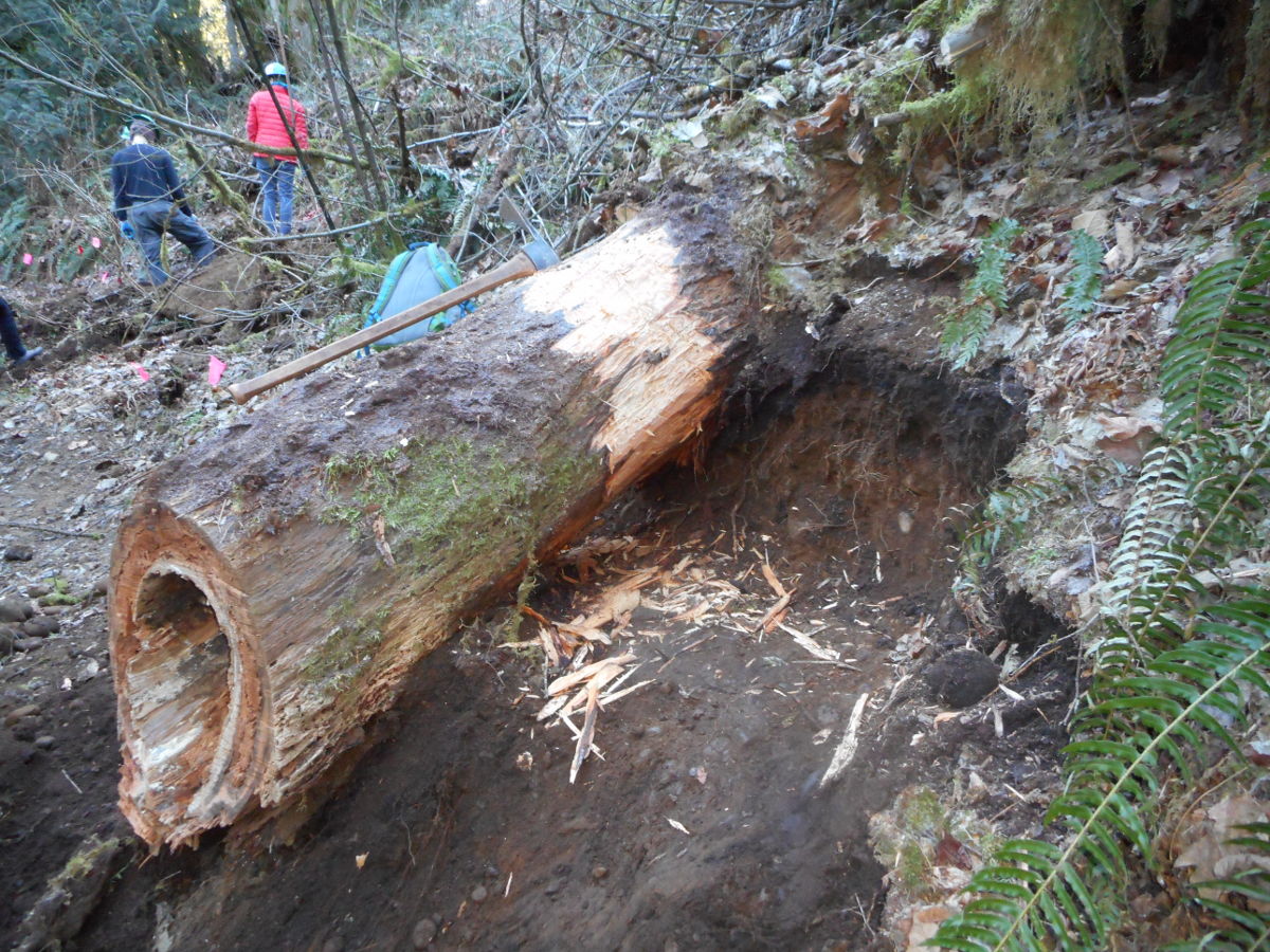

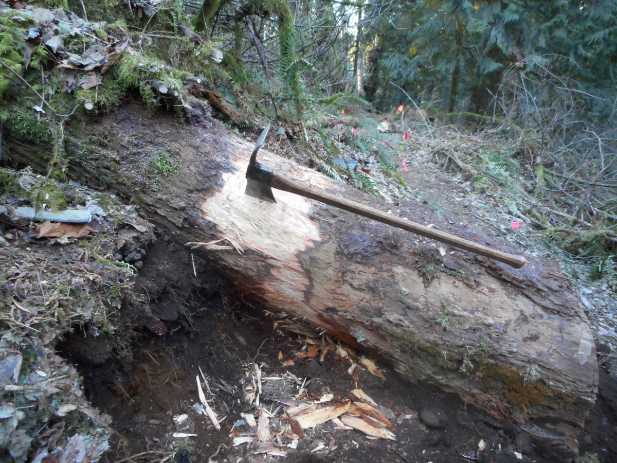

Not much chopping today but I did some peeling with my pulaski. We're pushing this trail about 3 feet upslope to get on some better ground. We needed to cut this old log back so I'm cleaning the outer surface to protect my crosscut saw. I warmed my pulaski with a cigarette lighter before chopping with it. I didn't want to risk a chip.
The work was made more difficult because the top half of the log was frozen solid. The lower half I just axcavated ( :D ) and it was warm in the ground. You can see the center is quite rotten.

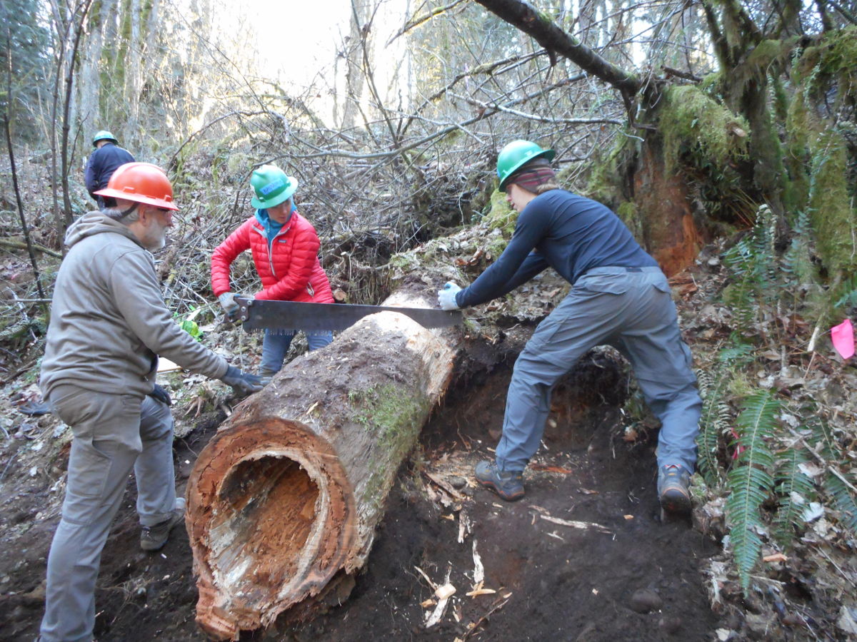

Two new trailworkers get their first taste of using the crosscut saw. They had a great time even though we had some difficulty. As the frozen wood became heated by friction it swelled and caused some bind. I'm going to have to set up another saw for winter with more set in the teeth. We had trouble getting a plastic felling wedge into the frozen cut. I ended up using my pulaski as a wedge and driving it with my boys axe. I have never used a pulaski like that before. There's enough of a poll under the adze to receive a blow. Once I got the kerf open with the pulaski the plastic wedges went right in. I'm definitely going to remember that trick.
That rotten stuff in the bottom was like paste and it caused a lot of bind. It filled up the gullets and in between the teeth. Made for a miserable pull.

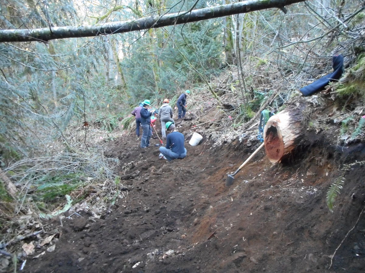

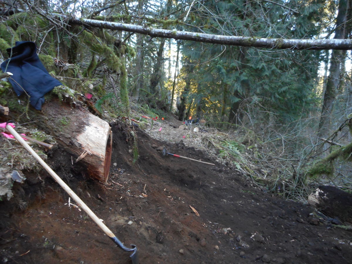

You can see that Forest Service shovel I re-hung behind the log. I'm liking the longer handle on that tool.
We're removing the duff layer and getting down to mineral soil which will make a lasting trail bed. Note the brown soil exposed where we've peeled back the dark duff layer. First we had to chip through 4 inches of frozen ground. Sometimes I gave up on chipping ground with the pulaski and went for the pick mattock. In deeper frost I've had to use a railroad pick.
