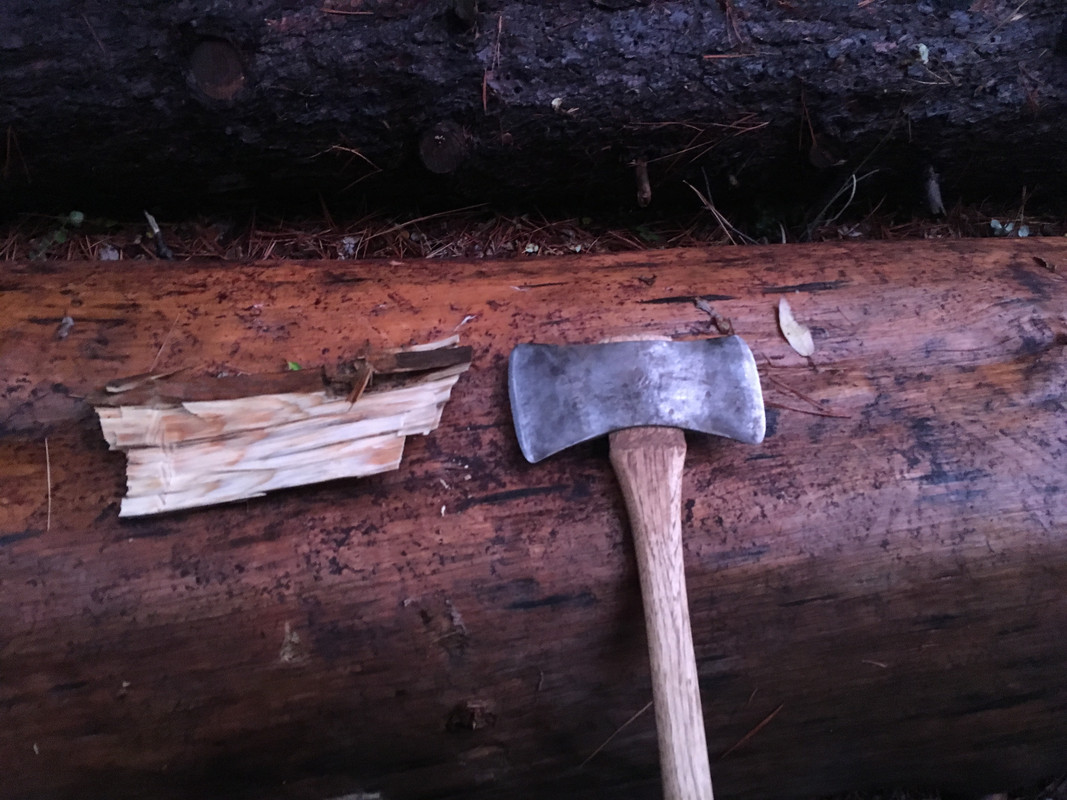

I don't see your chalk line on that log. But if it was made with blue chalk then it would be low contrast and might not show up in the image. I try to cut my juggles close to the line without going deep. Start by leaving an extra 1/2"-3/4" until you're comfortable with getting closer. The tendency is to overcut the bottom of the juggle so watch out for that.
Juggling is very similar to the underhand chop in competition and similar short handled axes (28"-32") will be most useful. A wide bit and minimal curve make it easier to connect your cuts and control your depth.

I worked a long day today and it's supposed to rain tomorrow so i don't know when I'll have an opportunity to finish hewing that log. But i can't wait to do it again and have a finished piece! My first hewn log! I will juggle a little closer together for sure. Other than needing log dogs my set up worked okay. This was a pretty knotty log so that really complicated things. Here's a before and after pic of my e&s.
It doesn't look like it but i put over an hour into filing that! There's still one small nick left but i think it'll be alright. This axe is hung on a 29" haft. I'm 6' 1-1/2" tall and an axe between 28"-30" is best for me for the undercuts. As square peg suggested i think a slightly wider bit with less of a curve would work a little better. Hmmmm, which axe will it be??
I sorta thought that too. I guess I just needed to hear someone else say it. I started juggling? joggling? the mantle log today. I took 8 axes to fiddle with and ended up only using 2 before my light failed. A17 and my hand forged double bit (far right two) got to attack the log first. I noticed the hand forged one had a side forged thicker than the other for splitting and rough work. The thin side pops pretty good chips, though. Also, my view was pretty nice, huh?
