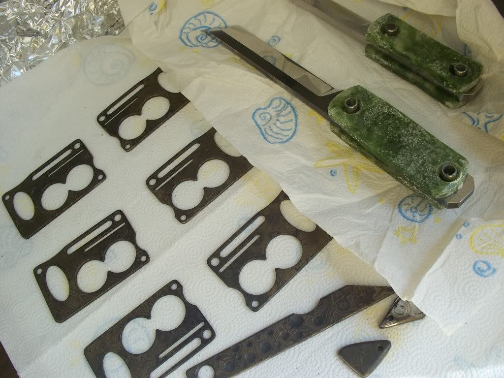

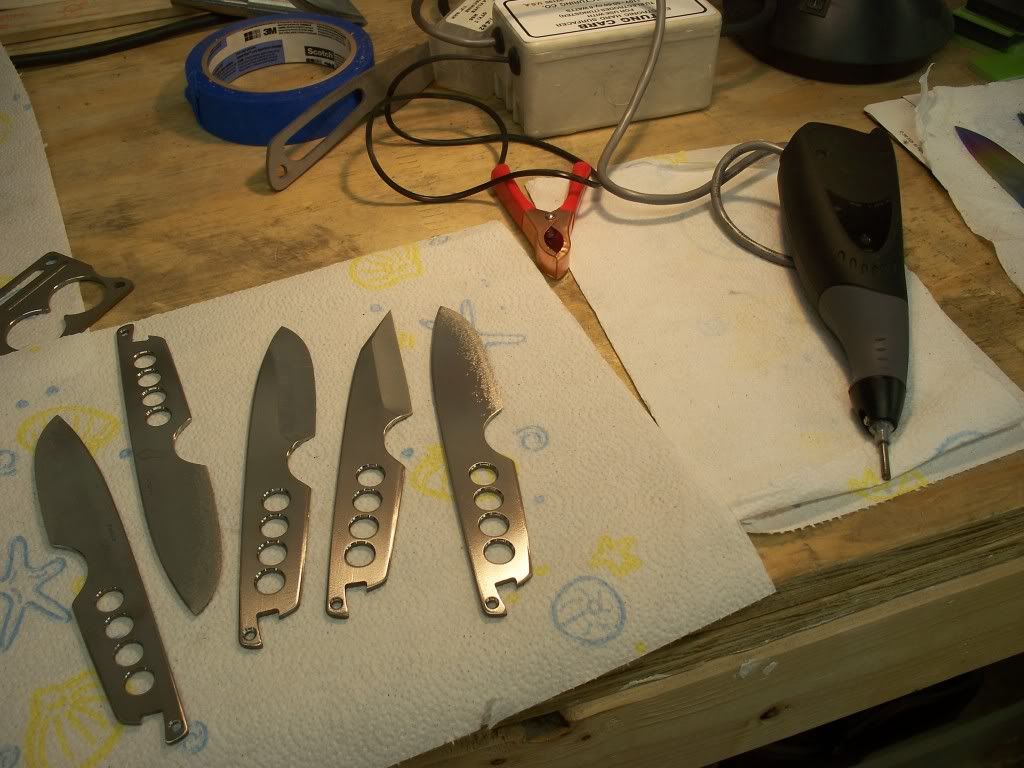

Carbide application

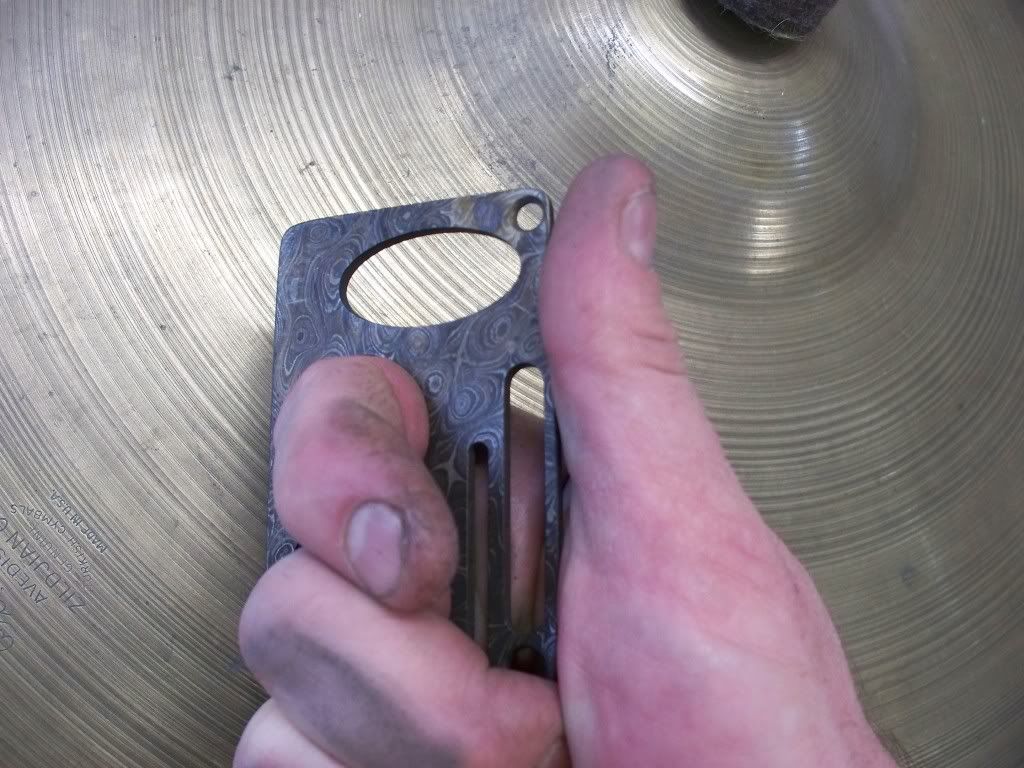

D2 tanto handles to be ground and recently heat treated damascus
freshly heat treat damascus CC Knife... these were taken up to 900 grit pre heat treat, the "decarb" will buff right off... they are mirror shiny right under the thin layer

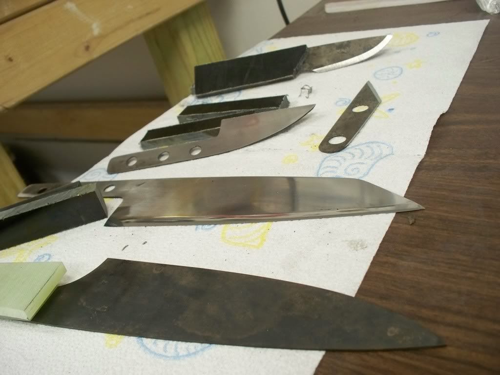

scale material selection for the .049 15n20 - black canvas micarta, black paper micarta, jade G10

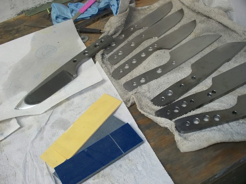

S7 Batch, a LH Chisel... G10 and micarta waiting to be ground rough for glue up
Is the chefs knife on the bottom spoken for??
No it is not spoken for... I'm planning on the Jade G10 and a chisel grind like the one on the other chef's knife. It is like a laser at .049, I plan on grinding it thin but let me know if you have any ideas for it. $150 range for the knife
However it's ground, it would have to stand up to my wife's abuse:eek::rolleyes:
Sounds good! I can put a small microbevel on it when it is ground, that will make the edge tough enough for just about anything. 15n20 is known for it's toughness, it is used for the big bandsaw blades that process whole logs!
