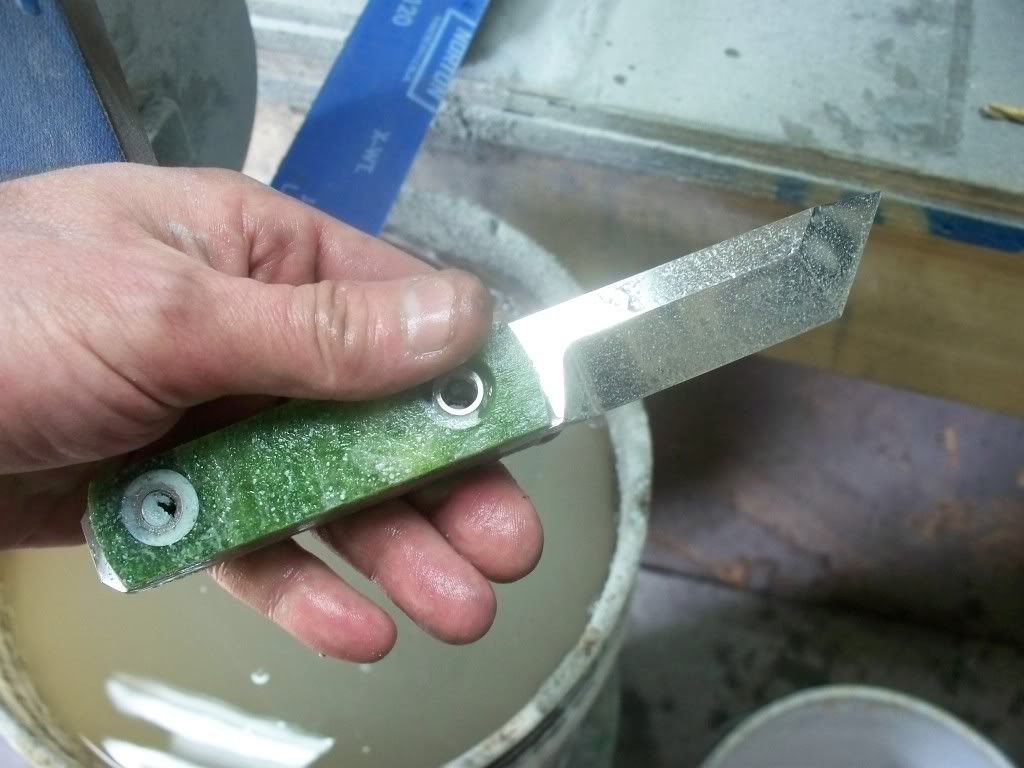

Curious: On the kiridashi, can the etching be extended into the dimples?
For sure! Those are just out of the heat treat oven... the different steels color differently from temper. They also have "decarb" something all carbon steel gets during heat treat, it is a layer of carbon that has migrated from the steel. They will get cleaned up to a mirror polish before the etch.

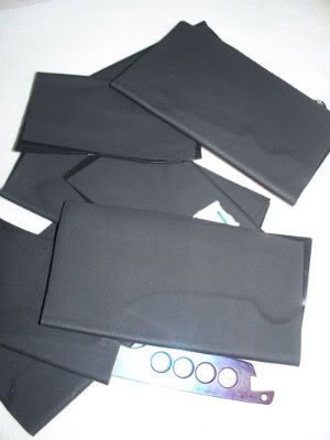

Making sheaths for some more Ti Bottle Opener Knives... I may have to do another run of them as well.

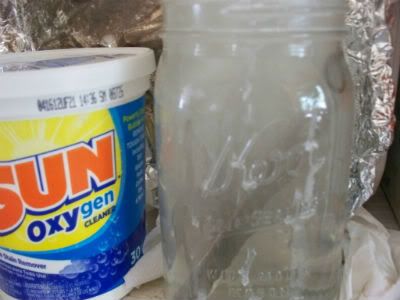

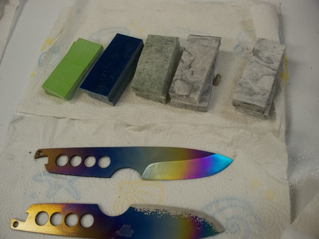

I'm oxidizing some Ti here. The treatment seems to anodize the Titanium but with more of a mottled grey look, I'll stonewash them next. You can see some colors poking through, the colors run in the same order and color spectrum as heat coloring or anodizing but they are much more subtle. This finish seems to protect the Ti from scratching...
Ha, you weren't kidding you are Oxydizing them fo sho. I love the McGeyver look i.e. mason jar etc. Impressive out put/fin product for the set up you have. I appreciate the lack of CNC machines and such. True Hand Custom here, and I cannot wait to get my first : ) Mucho Respect Sir.

freshly heat treat damascus CC Knife... these were taken up to 900 grit pre heat treat, the "decarb" will buff right off... they are mirror shiny right under the thin layer

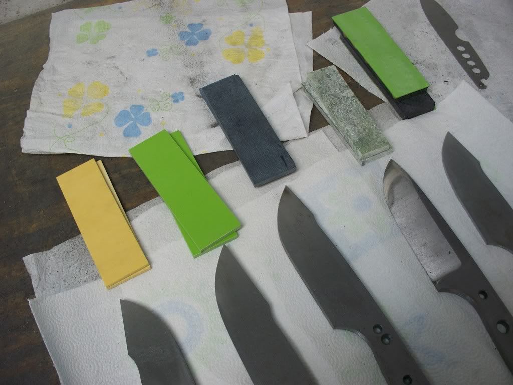

Great scale choices, i don't see very many yellow scaled blades, and the krypto is def one of my favs. Toxic is da shit, and blue's cool. Yup, they're gonna be lookers.

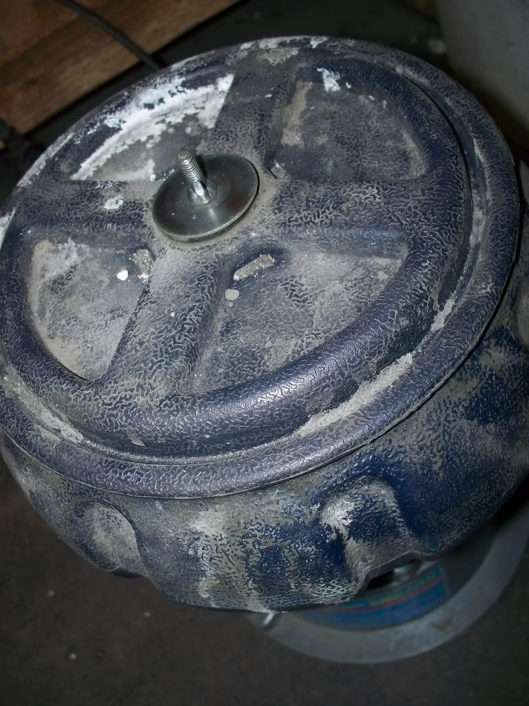

Tumbling some random stuff - tubes to deburr, before that I stonewashed a couple of Ti knives in the ceramic media

Thanks! Those yellowish ones are antique ivory micarta, old material. It has a "rind" on the outside which looks cool when the white stuff underneath is exposed... kind of like a sunburst guitar.
