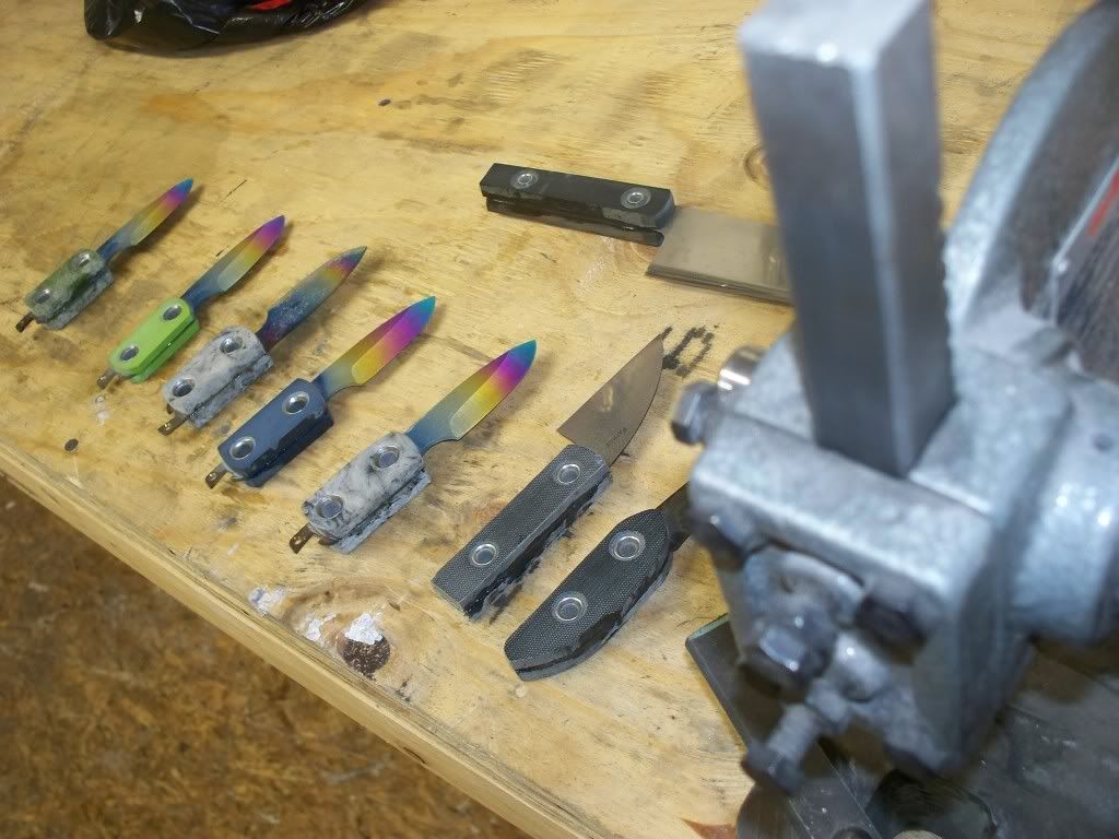

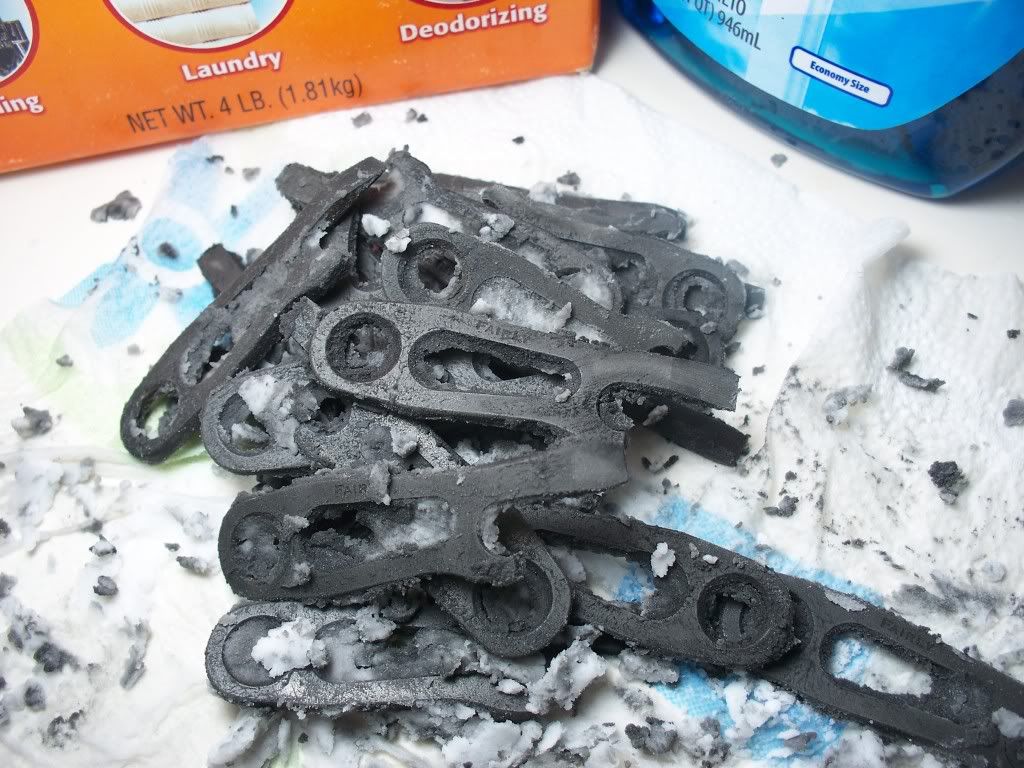

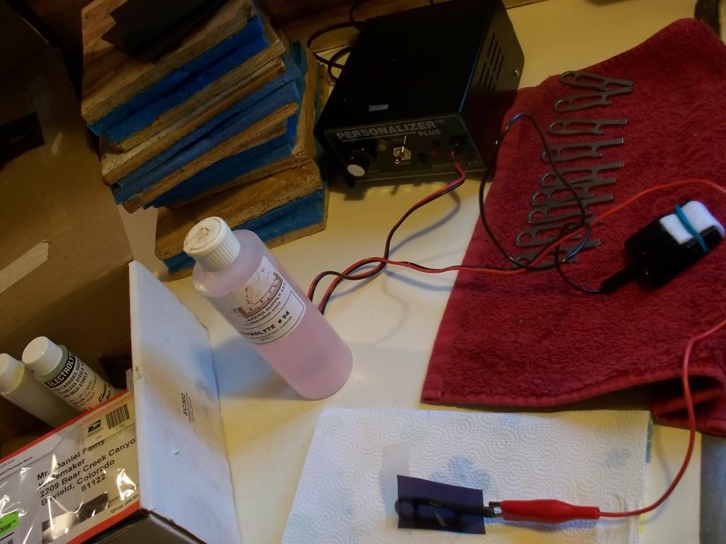

Last night... cleaning etchant off of Titanium with water, the hooks are Titanium ones I made to survive the etch/ano process. This is the final cleaning after a 10 step prep process for anodizing.
Right now! I'm etching some keychain tools while I wait for my oven to heat up, kydex molding is next.
That's 4 sheath molds in the background with my kydex on top.

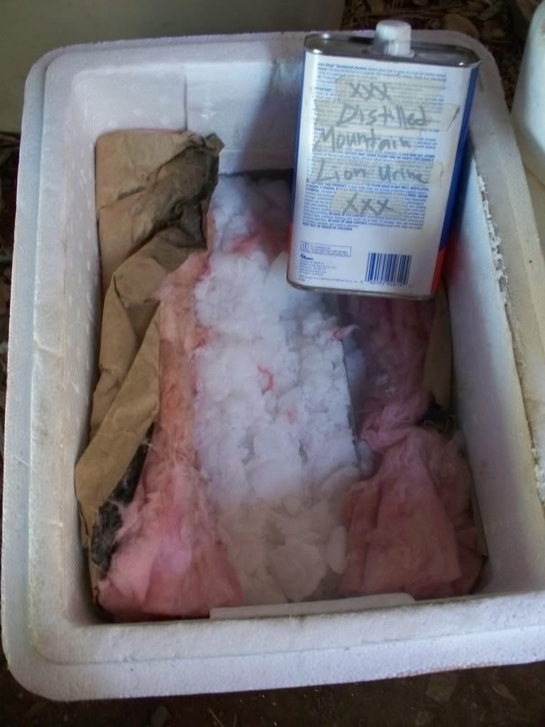

These keychain tools in the stainless packet I'm showing have been in sub zero treatment all night. I do this after a snap temper, the treatment reduces retained austenite. Stronger tools at higher HRC!
This works especially well with the D2 I am using, a lot of steels do not respond to the treatment. The sub zero is essentially an extension of the quench with D2, the point where the steel transforms. Cryo is a bit different at -300F, I am going to roughy -100F.
Check the vapor descending, it looks like spiderwebs! :cool:
Here is my sub-zero setup! I have a stainless container bedded in insulation... I fill up that container with a dry ice/alcohol slurry, put in the knives or tools, more plastic then insulation... it all goes in the thick styrofoam cooler. I can keep dry ice in this setup overnight with no visible melting!

Hey that's why I live on the mountain... mountain lions and moonshining!
I didn't mean to post that photo, that distilled mountain lion urine is a key component in my heat treat. Oh well, they will never reverse engineer my secret formula! :D
