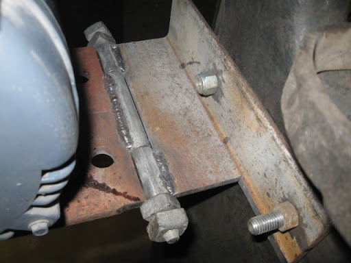

I scrounged around, and came up with some flat plate, some angle iron, some ¾” plumbing pipe, and some 5/8” all thread and nuts.
I welded the plates together to make the motor mount base. I filed the seam out of the pipe so the all thread fit through, and sectioned the pipe to make hinge knuckles.
I measured the angle so the motor would sit with the pulleys centered, then cut it and drilled it to match the two holes in the side of the hammer frame.
I welded the middle hinge knuckle to the base plate, then the outer ones to the angle. I mounted the angle on the hammer frame, held up the base plate, and slid the all thread home. Then I propped it up and bolted the motor on. The weight of the motor will hold tension on the belts.
