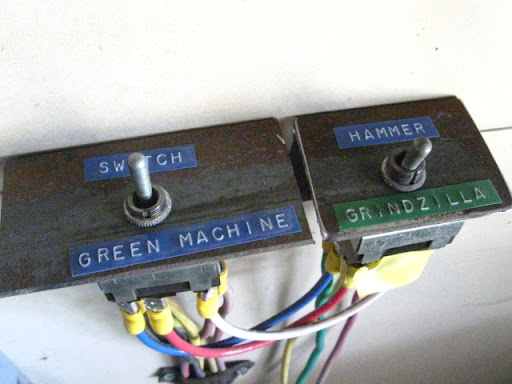

Then I turned to wiring power and switches to the hammer. The motor I got is 3 phase, so I'm running it with my VFD.
I patched the machine into the power-out lines from the VFD:
I added a switch to the power-to-grinder lines in the grinding room:
I ran the power along the wall and over the door to the machine, and added a switch within reach of the hammer:
The hammer, with motor tested operational in place.

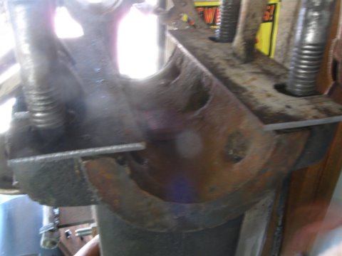

We made cardboard templates, then cut some 1/8” steel shims for the pedestal bolting surfaces.
I’ve read to use brass shim stock, in a bewildering array of thicknesses, all designed to facilitate the removal of minute amounts of thickness to tighten the bearing as it wears. After a conversation with Sid Suedmeier, (very helpful, nice guy) I felt it was okay to revert to my default blacksmith sensibility and just use steel for now. I can grind them thinner as needed, or make some thin shims later. I didn’t feel like spending $200 on brass shim stock and three days cutting shims.
We cut out four plywood dams, using an adjustable bit and dremel to make the 2” holes tap-fit onto the shaft.
We blackened the shaft thoroughly with an acetylene flame. This is best done with the shaft off of the pedestals. By the end of the day, we figured it’s best to pre-heat the shaft now, too. The inner boards were installed prior to blackening.
With the shaft sooted, we put it up on the leather shims, and slid on the outer boards. After originally centering, we had clamped the shims onto the pedestals so they’d hold as a reference for replacing the shaft. This worked well.
We slid on the outer boards, then used bar clamps to snug the boards up tight to the pedestals, one on each side, four total. After clamping, we removed the shims.
With the assembly clamped in, we caulked it all up with Babbittrite damming compound. We made a little dam along each side of the top of the bearing, to help pour in and keep in any over flow.

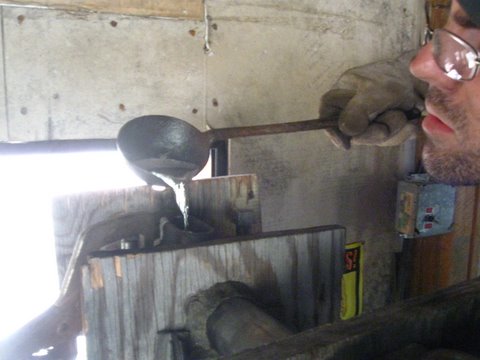

With the assembly ready to pour, we fired up the rosebud torch and threw the old Babbitt scraps in the melting pot. The torch quickly melted them; stirring with a wood stick helped.
We skimmed the schmutz off the top with a tablespoon, and when the stir stick toasted nicely in the babbitt, we poured the metal into a ladle, then poured the front bearing.
It didn’t flow very well. The ladle needed to be pre-heated. Oops. Also, the shaft and pedestal needed more heat. We figured right away it would need to be re-poured.
Armed with our lesson from the first bearing, we melted more. This time, we took a plumbing torch and pre-heated the shaft and pedestals a lot more before the pour. Also, we blasted the ladle a bit with the rosebud right before transfer.
The second bearing went a lot better. It’s all about thorough pre-heat.

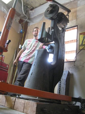

I still had to bolt the hammer down to it’s pad. So, with the hammer sitting just how I wanted it, I used the bolt holes in the hammer casting to guide the bit, drilling ½” holes an inch deep or so. Then, I used the engine hoist to pick the hammer up, and slid the pad out from under it. I had to block the hoist’s wheels up about 5 inches, to get clearance to slide the pad under it.
I then finished drilling the holes through.
I flipped the pad over, and used an adjustable bit in an old brace to counter bore the holes for washers and bolt heads. I had wanted to use some sort of rubber belting between the hammer and pad, but hadn’t come up with anything. Then I remembered that the previous tenants had left a busted treadmill in the other shed… ten minutes and some knife work later, I had managed to cut a double layer of matting out of the old tread to put on the hammer pad.
I set the hammer back down over the bolts with some help from my buddy Zack. Then we used the hoist to pick the crankshaft assembly onto the pedestals. I’m leaving the hoist there for now, as I’m going to have to pick the shaft up a bit again to get the two v-belts onto the big pulley.

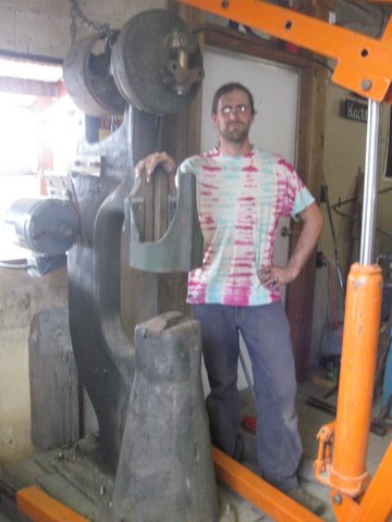

Sorry you all have to keep seeing me pose with this thing, heck I just think we look good together.
