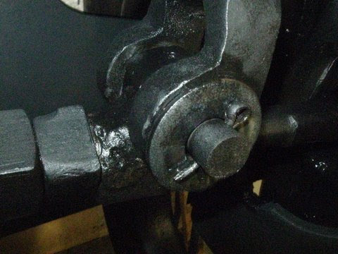

I put a bit more work into it tonight. I've got the ram sliding much more freely with the front guide bolted on tight- I had to remove a spacer washer from the crankshaft in between the front face of the front bearing and back of the crankplate, and move it to the back of the front bearing, in front of the spider. This moved the crankplate back about 1/8". I removed some play from the right toggle arm/crosshead joint by adding a washer between the arm and the inside of the crosshead ear.
This being on the front side of the arm, it also helped to push the arm back about 1/8" back toward the frame v-slide. So, I removed about half of the 1/2" gap between the ram when hanging free, and the back v-slide.
I also added another thin shim between the front guide and the frame on each side. The result is that the ram slides freely with much less play, with the guide bolts tightened. No more sticking. The shims are necessitated partly by the fact that a previous owner welded steel angle iron to the inside of the front v-guide.

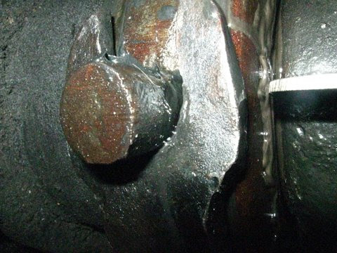

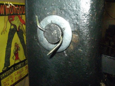

First off, the hammer would skid itself around a bit when running. Since I rent this shop and don't want to have to cut a hole in the floor and pour a hammer foundation, the wooden pad will have to do. To improve this, I drilled holes in the slab for 1/2" drop-in anchor bolts, then bolted angle iron stops along the sides and front of the hammer pad to contain the hammer pad from walking. The angles are only bolted to the floor, not to the wood. I figure if they are connected to the hammer as well, they'll probably tear up the slab at the bolt holes.
This worked well, so far. The hammer is now stable when running, and doesn't rock side to side much, either.

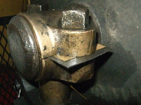

So, I figured the clutch pulley was riding too tight on the crankshaft. There is a grease zerk on the inside of the pulley, for the clutch babbitt bearing. I greased the heck out of the bearing, spun it by hand, greased it more, ran the pulley at an idle, greased it some more, idled it more. After a while, the pulley spun on the shaft with much less grab. At this point, the clutch began to disengage fine. I ended up putting a couple of shims back under the clutch blocks when finished. I may put one more back tomorrow, as the tread ring bottoms out slightly when fully engaged. (Edit- I did put one more back. It works well now.)
While working on this, I noticed that the shift fork was badly shaped. Some one had weld repaired it crudely in the past, failing to bend/align it correctly afterward. I took it off again and re-welded it more strongly, then hammered it and checked it until it fit more correctly.
At this point, it fit well, but no longer lined up right with the pivot pin hole. I used the oxyace torch to cut the bottom of the fork out about 1/4" deeper on both sides, and filed it back smooth. Now it fit up and the pivot pin went through smoothly.

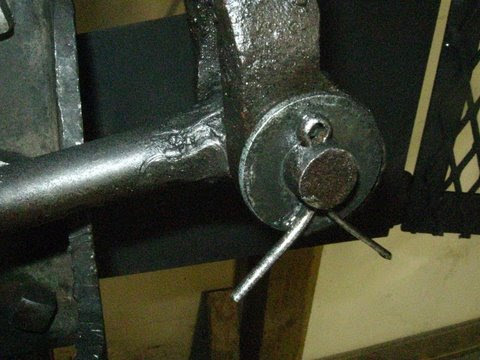

I also added a new washer to the cotter side of the pin here.
I added washers to the front of the toggle arm/link joints to remove some play.

Several points of interest that you might not know. The clutch fork and arms are case steel. I noticed you said you cut the hole out bigger on the pivot point of the clutch fork. You could have welded the original hole closed and drilled a new hole. During the rebuild course this is what we do. You can do the same with the arms if the pivots are to out of round.

That does make sense Dave, thanks for the pointers. What I did was cut the ears a little deeper on both sides of the clutch fork- not cut the pivot hole bigger. I may try that trick with the bolt, though.

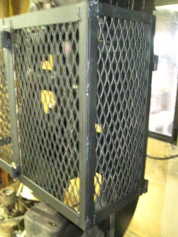

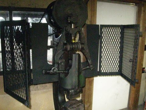

I built a safety cage around the linkage today. I found a nifty grate of expanded metal in an outbuilding here (another legacy of previous tenants) that turned out to be perfect. My other materials were 5/8” and 1” round stock, ¼” and 5/16” pin stock, some 1/4”x 1-½” flat stock, some angle iron, and some steel curb forms I had as scrap. All welding on this project was done at 125 amps AC with 1/8” 6011 rod.
I didn’t have any hinges, I live far from the hardware store, hinges are expensive, and generally under built anyway. So, I made my own hinge/knuckles by center drilling pieces of round stock, then sawing in half. I used 5/8” round with a ¼” hole for ¼” pins for all the corner hinges. I cold hammered a rivet head on the top of the pin.
I did the same thing, but with 1” stock and 5/16” pins for the shackles (?) in the front. They lock up nice and tight, but easy.

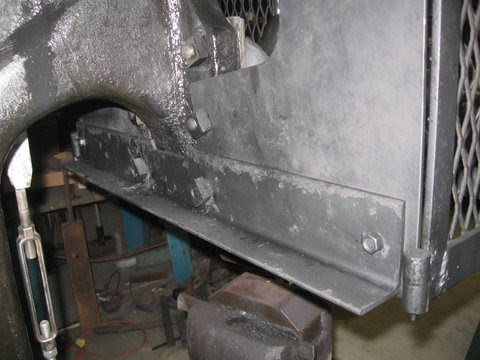

The curb forms were 3/16” thick by odd-shaped. They form the sheet steel pieces on the back sides of the cage. They only needed a little trimming to be just right. I ran the hammer after installing the cage, and the cage flopped around too much; the sheet steel in the back was a little too thin to support the weight of the cage solidly with the slight rocking of the hammer. So, I added a piece of angle iron in the back to connect them. I wanted to weld it but went with bolts, to make it easy to remove. It solved the problem.
I made it 22” high, 10” deep, and 28” wide. It clears the front of the guide by about an inch, and the adjustable toggle link end (two in the future) by about three inches.
It swings out really well to afford access for maintenance and oiling. I gave it a coat of rattlecan rustoleum black to pretty it up a bit.

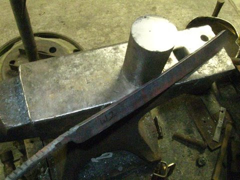

By the way, here’s a piece of drawn out W2 next to the round stock I cut the “cookie” off of. It took me barely two heats to draw it out nice and clean. I’ve done this by hand several times, that takes many heats and MUCH effort. NO LONGER! I use a lot of 52100 bearings, too. The hammer makes short work of those as well. Now I have a big cable billet prepped and several cable billets and a Harley chain billet to finish.

Exactly. And now when friends come by the shop I don't hand them a 10 lb. sledge.
