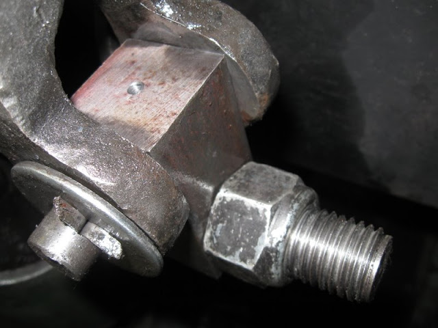

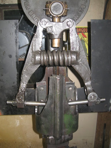

I worked on my Little Giant today. Finally went ahead and fabricated a new set of adjustable toggle links and knuckles. The old links were comically worn out and broken/welded. Check 'em out.
I'm now able to preload the spring a little bit, taking the sag out of the links, (they should be about level at rest) and more evenly now that both sides adjust. There is less slop and mechanical noise, and the hit feels more solid.
I had a machinist friend turn class 2 threads, 1 inch NC, on some cold rolled round stock. I measured a threaded piece for length on the adjustable side of the old link, then cut both new links to that length.
I took 2 pieces of 1" cold rolled round, 3" long each, clamped them into a squared t-joint with the well beveled ends of the links, and welded first a hot root pass, then chipped and brushed, welded more passes, until I had it built up fully all around. I then went to the belt grinder and removed any excess bulk of the top of the beads and at the sides, so the t-links would pivot freely in the ram. It's important to burn this joint together very well, for obvious reasons.
The stock I used is a bit bigger than the old links, they seemed to be rough forged 3/4"-7/8" dia.
I made new knuckles for the pivot points where pins connect the toggle arms to the links. I used 2 pieces of 1.5" hot rolled square stock, 3" long each. I used calipers to scribe centers for the link and the pin. Both were located 3/4 in from an end, and centered in the stock. Centered in the end I suppose. The pin hole is 3/4" diameter, and runs 90 degrees to the link hole, which is 1" diameter. The pics should help.
I don't have a metal lathe, and drilling the holes would have resulted in too sloppy a fit. So, I turned to the milling machine. I first predrilled the pin hole at 1/4" using a collet and twist drill, then stepped up to a 5/8" twist bit and collet, then finish bored with a 3/4" end mill. I used collets throughout to avoid clearance issues when changing the bits (round column mill/drill.) The 3/4 pin slid in nice, as it's about 10 thou undersize. I did the other knuckle pin hole the same way.
I used a similar progression for the 1" bores for the links. After the 3/4" mill I stepped up to a 1" end mill. The fit was still a bit tight, so I ran the mill side to side just a little four ways. That got me a nice clean sliding fit for the links.
I had to grind the insides of the toggle arm joints flat and true, they were both a little too tight for the 1.5" knuckles. They needed it anyway.
I then drilled an oil hole in the top of each knuckle, intersecting with the pin hole. Later I will tap these for grease zerks.
I used nylocks for style. So far they seem to hold position well, I can add jam nuts if necessary. These knuckles and links came from both Richard Kern's book, and a conversation with Sid Suedmeier.
I also flipped the toggle arms around, and welded up one of the spring centers to center the spring better. I've seen pics of a hammer where the crankplate was worn incredibly by the top toggle pins and even the spring rubbing it- bad news. I was able to adjust the linkage out away from the crankplate a little more, and get more snappy controllable action from the hammer. The top die had a little side kick to the end of its stroke before, now it does not. Big improvement.
Oh, the new knuckles lowered the link clearance a bit, so I raised the crosshead/pitman adjustment until at the bottom of the stroke the dies are 1.5" apart when resting.

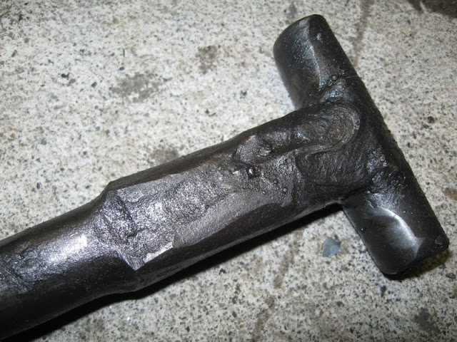

Here's something of interest from your photo's. Your toggle arms were forged and someone added a welded in brace. You will notice the hammered surface. Early style 50's had forged arms. Your arms were beefed up to make them look like newer arms which are cast. You have the original arms. Little Giant made them this way for awhile, but this is a slick mod.

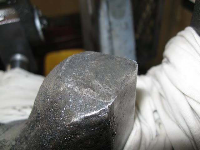

Okay, one thing that you might want to look at since your photo's and rebuilding skills are above par. We need to look at your ram. As noted in your photo's, your toggle links are worn. If you look at them the ends where they sit in the ram are worn and rounded. You need to check where these set in you ram. I can almost guarantee that your ram is worn the same way on the ears of your ram. I bet there is a lip on the inside of your ram (on the ears of the ram where the toggle links T set). With your new toggle links they might run on this lip and will cause excessive wear in this area. Two choices build this area up with weld or grind off with a burr.
Take a look at this. I've seen some extremely badly worn ears on the rams that have almost cut themselves through the ram. Caused by under lubrication or plugged lube holes.

Thanks Dave. It's true about the arms, they are reinforced- the ends are pretty hammered, though. I'd like to get new ones when I can. They did a good job off welding in the extra.
I did check on that. The ram itself is not as badly worn as I thought it might be when I checked it- there is a little lip on the inside, probably 3/16" or less max. The links are welded up in such a way that they don't ride on the lips badly, although they do a bit. Do you mean altering the link ends or the ram? Because welding or grinding inside the ram would be no walk in the park...

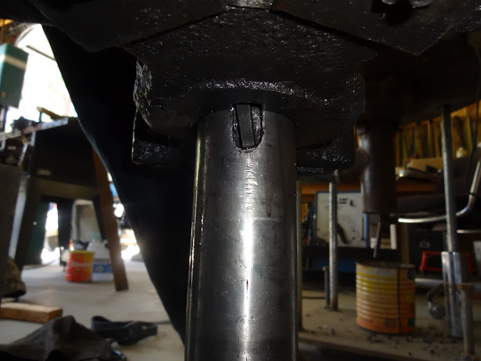

Upon inspection today, it turned out to be the spider. The crankplate ain't going anywhere, it's ON there. took the front bearing cap off to look, the spider had obviously slid about 1/2" back into the clutch side.
So, I ran a prybar between the clutch pulley face and the side of the spider casting to hold the spider from moving, and slugged on the crankplate with my big deadblow. Bingo, the shaft slid into the spider a bit. I kept doing this until the end play was down to less than 1/8".
I figured the key was probably at fault. I assumed that the key would correctly be driven in tighter from the front bearing side, so I took some punches and a hammer and got the key in a good 1/4" farther. I cleaned up the little burrs raised on the side of the keyway with a file so they wouldn't ding up the babbitt in use.
Then it occurred to me to call Sid Suedmeier to see whether my assumption about the key was correct. He picked up the phone and proceeded to give me all kinds of good advice. It turned out I was right about the key, but he told me to look for something else that's a common problem with old #50's. I ran out and looked.
I hadn't even noticed, but I saw it immediately once he'd told me to look- a wear pattern from the back ear of the ram (the top of the male vee) hitting the bottom of the crankplate at the top of the stroke.

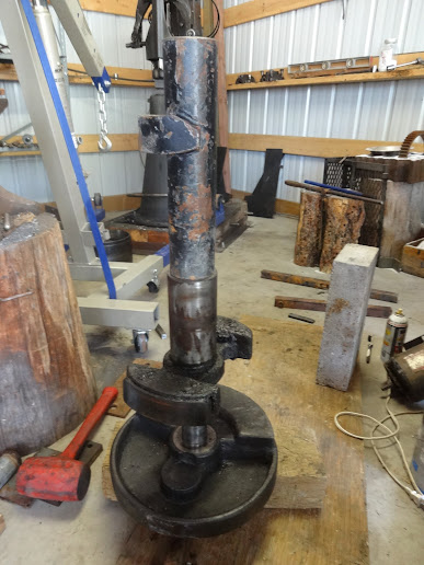

Yesterday I took the top end of the hammer apart again. The spider had slipped on the shaft again, worse than ever. No clutch control at all.
I engine hoisted the shaft down, with the clutch pulley tied onto it so as not to fall off.
When I got it to the floor, I cribbed up around it until the crankplate was off the floor and the weight was supported by the crank side face of the spider, then started slugging down on the end of the shaft with a heavy dead blow hammer. I ran some PB Blaster down the keyway and around the shaft.
115h2ygNzPMotcJBAcpffwOhhRWW2VbTQwePB-HpGGE=w387-h516-no
After hammering on it quite a bit, and cribbing it up some more for clearance a couple of times, I got the spider off.

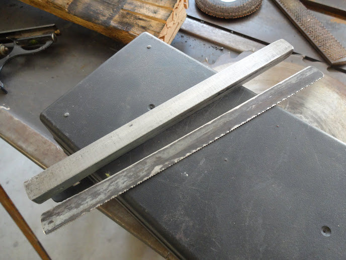

I found that an old hacksaw blade, ground flat and dulled, was just the right width for the keyway, and .023" thick. Figured I'd try that.
I put the key back in, with about 3/4" of damaged end cut off and dressed, with the shim under it.

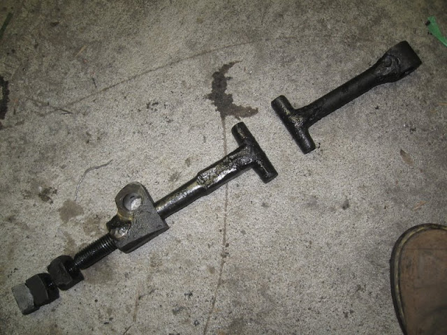

It broke the other day. One of my fabricated toggle links snapped right in the middle- parts flew past me and only bruised me on the knee. Close call.
I threaded up a new link on the lathe, and welded the "T" up. It fit right back into the hammer.
I fixed the safety cage and re-installed it. Safety up!
Prognosis: the link, unnoticed by me, and due to recurrent maladjustment caused by excessive shaft endplay, had begun to hit the ram guide, and metal fatigue combined with a stress riser from the end of the adjustment thread had caused it to snap!

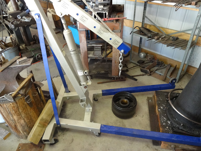

Hoisting the top end off. This is a badass engine hoist!

Installing top end back onto hammer. This clamp rig works well.
It took some fitting at the end, grinding off some high spots from the front bearing face of the spider. It looks as if it cracked and was repaired in the distant past, and the two halves were not perfectly aligned when welded. With the spider pinned on precisely, it would bind to the front bearing pedestal a bit during rotation at the two weld points. I suspect the fwd/rev wobble to the shaft created by this geometry may have had something to do with the spider breaking free repeatedly. It's gone now.

You are correct, the thread served as a stress riser. That set of toggle links was machined for me by an acquaintance, and he did not end the thread in a smooth fashion. I threaded this one myself, having a lathe now, and made sure to run the minor diameter out past the end of the thread a little, then chamfer it up to the link surface.
The entire thread does not have a radius at the root. My 18" Hendey lathe has messed up halfnuts, so the little lathe was pressed to thread this 1" bar, and i was taking 1 thou per pass the last ten passes. It barely had the power! I don't think a cutter with a slightly round nose would have panned out well.
