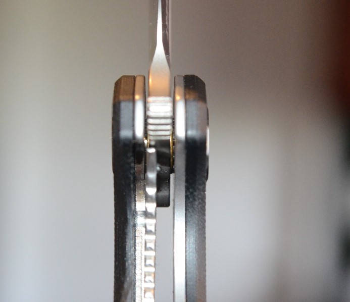

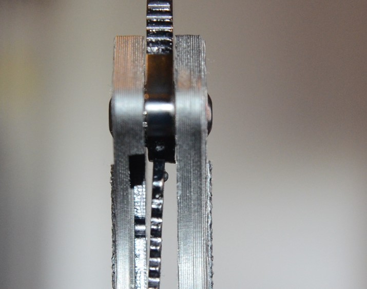

The amount I am willing to pay, I have no choice, I have to fix most of them to make them good. Mostly the line lock are not fully engaged, only half way. A lot of them have to loosen the pivot screw for the blade to swing freely, I have to thin out the G10 part a little to free the blade up. It's so common.What am I missing? Every knife you posted is made in China.

Here are the example I said I had to fix on a lot of knives.Probably because most people don’t want the blade to drop on their thumb when the liner or frame lock is disengaged.
Liner locks tend to break in with use, I don’t see any need to speed up the process. If you’re that concerned about a lock failing, grab a fixed blade.
It's not about break in, the line is NOT bent enough. It's so easy to test, you can try to push the line more under the blade, if it is not bent enough, it actually will bounce back. You need to open it, put the liner on a vise, bend it carefully a little at a time, try and see, repeat again if needed. It just takes time and care.Liner locks tend to break in with use, I don’t see any need to speed up the process. If you’re that concerned about a lock failing, grab a fixed blade.
