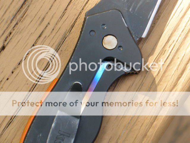

It looks good! I'm pretty positive it is real. It has a Hinderer scale on it, and everything else looks good. If you want colored TI then you can use a blow torch and color it that way. You can bronze the steel parts as well (pocket clip, liner, hardware)
That wont take away the heat treat? what about where the detent is?
As long as you don't touch the blade you'll be ok. It might mess with the heat treat of the liner but you also have a g10 scale and the liner will still be hard. The lock bar isn't heat treated as far as I know, so you won't hurt it any by doing that. I've bronzed the hardware on my Kershaw Shallot and my friends Kershaw Leek. They both turned out nice and it didn't mess with the heat treat on the screws.

Here is the Ti after heating it up. A little more blue than I wanted, but I still like it... Hey its my first time, live and learn!

Also I noticed since doing the heating, the lockbar has more movement now... Would it be advisable to get it carbidized? ( not sure if spelling is right )
You might want to ever so slightly bend the lock bar in (take it apart so you can). It should take away the up and down play. If you want to re-do the anodizing, you can bead blast the TI and it will take the anodizing off. I read somewhere about how to take the anodizing off of TI but I can't remember how or where I read it
Do you think it was from the flame treatment? I emailed KAI to see if they would install the new insert in the lockbar.

Now the bar goes about 70% over too...

Its a blem, so they sadly won't do anything with it other then clean it and sharpen it. You could get it carbidized but that will just be more money on top. You could sell it for more then you paid for it. I would personally try bending the lock bar over and see if that takes the wiggle away, but if you aren't comfortable doing it, then don't. If you want to sell it tho, you could put on the factory scale and save the Hinderer scale for your next one :thumbup:
